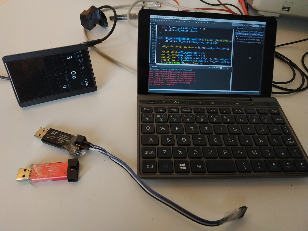

Post by casainho » Apr 05 2019 8:01am
Thanks to www.electrifybike.com that sent me for free a Bafang color LCD 500C, I was able to open it and check the internals. Here are my notes: https://github.com/OpenSource-EBike-fir ... r-LCD-500C
