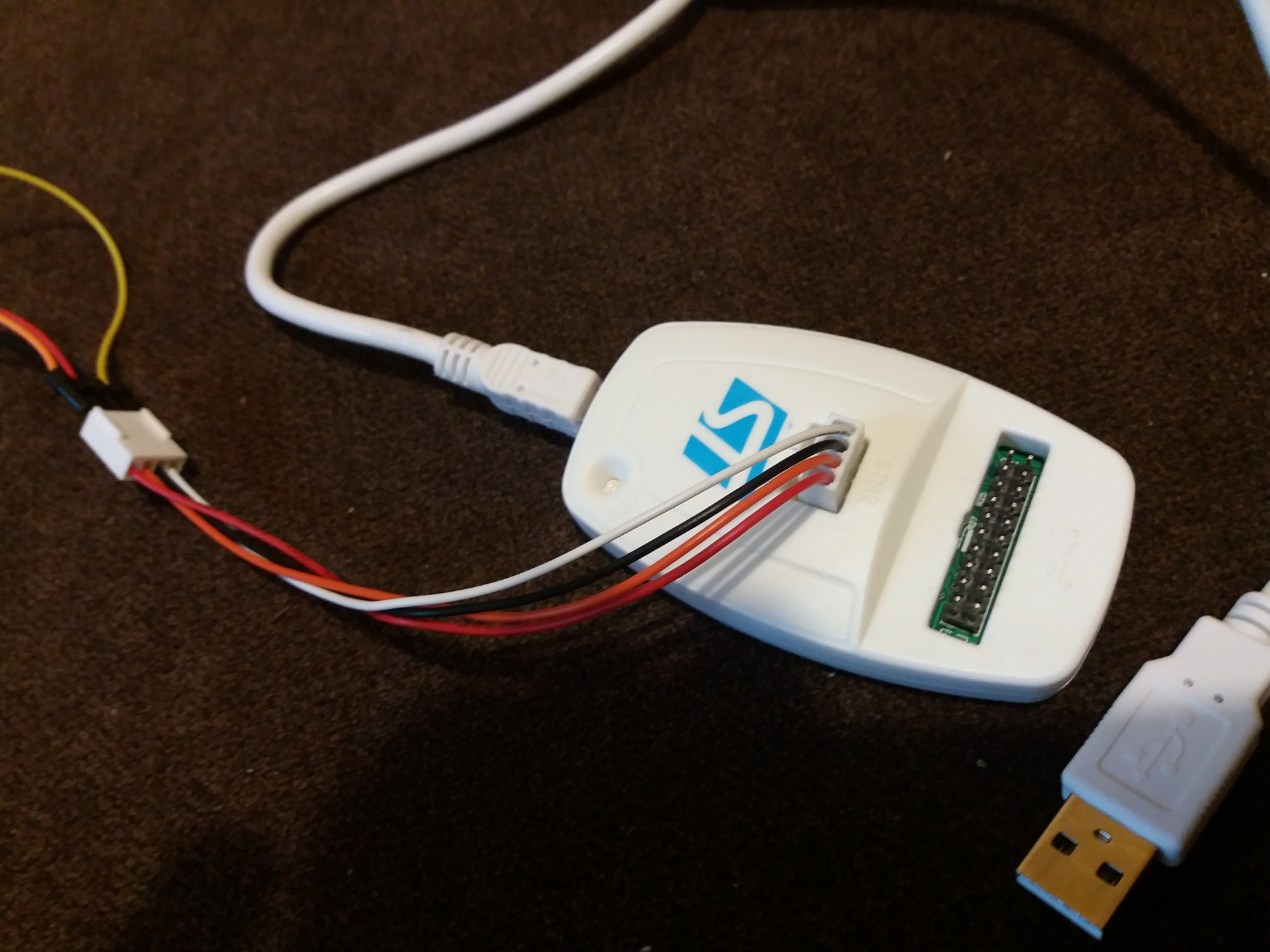

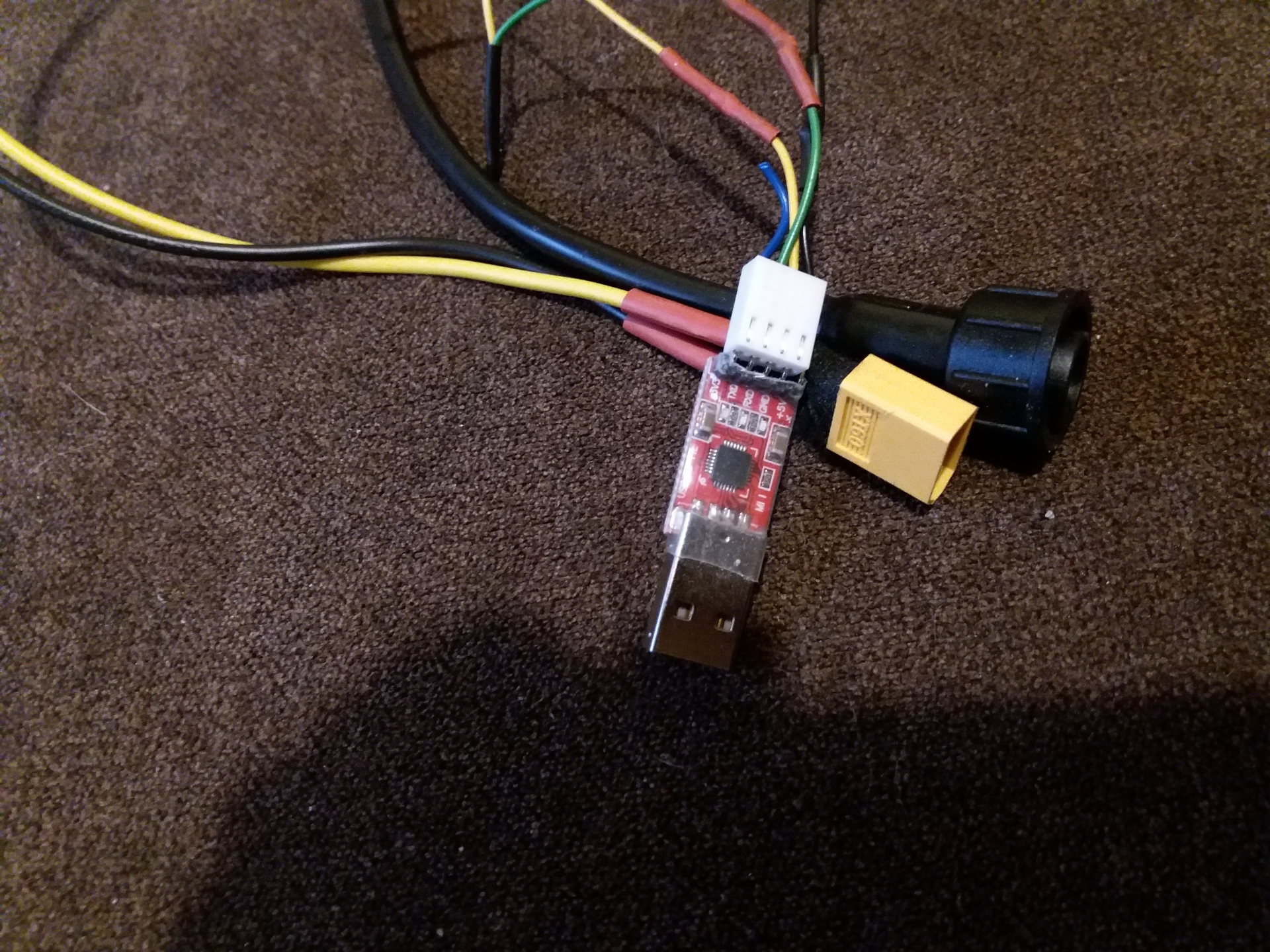

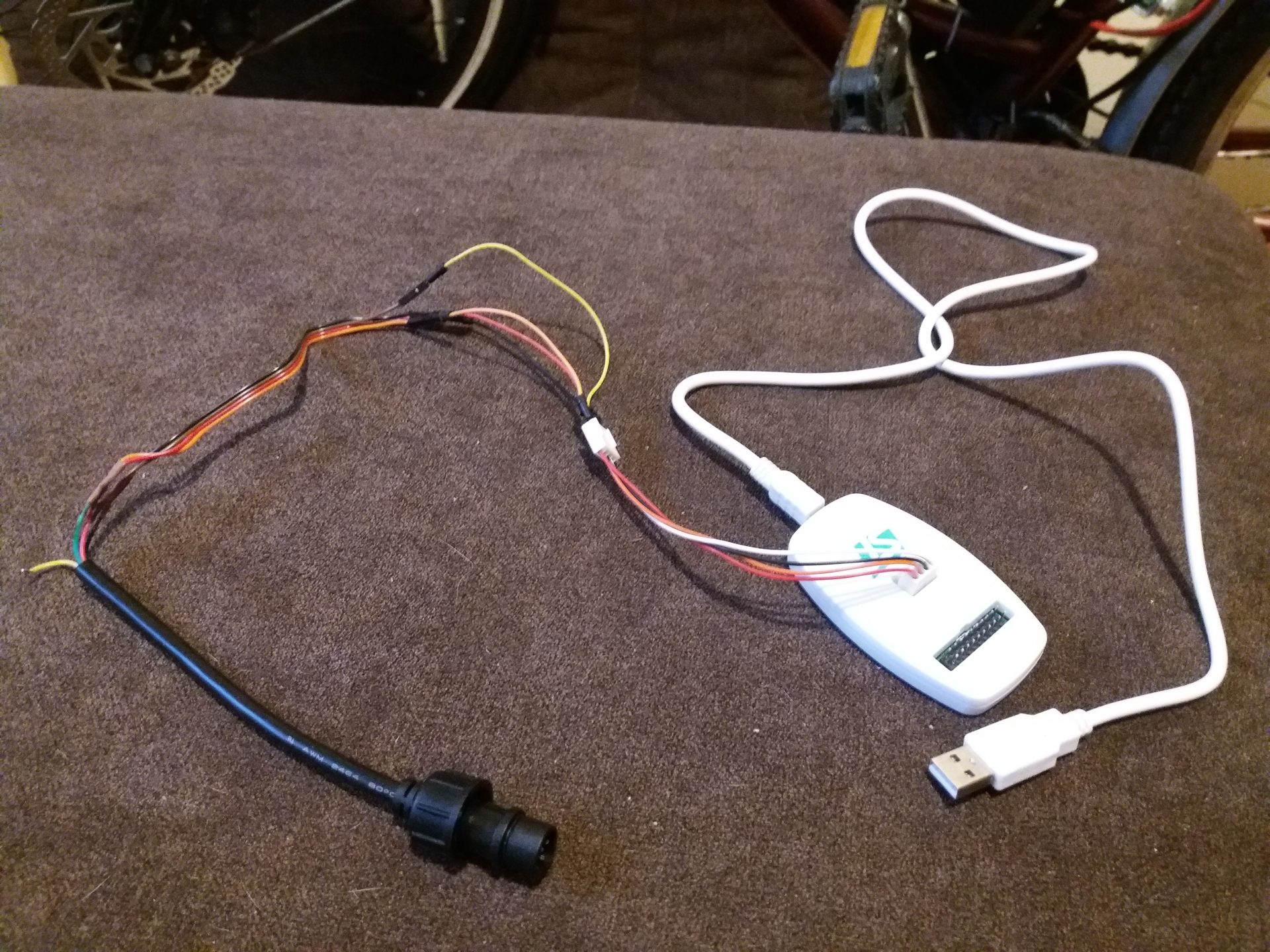

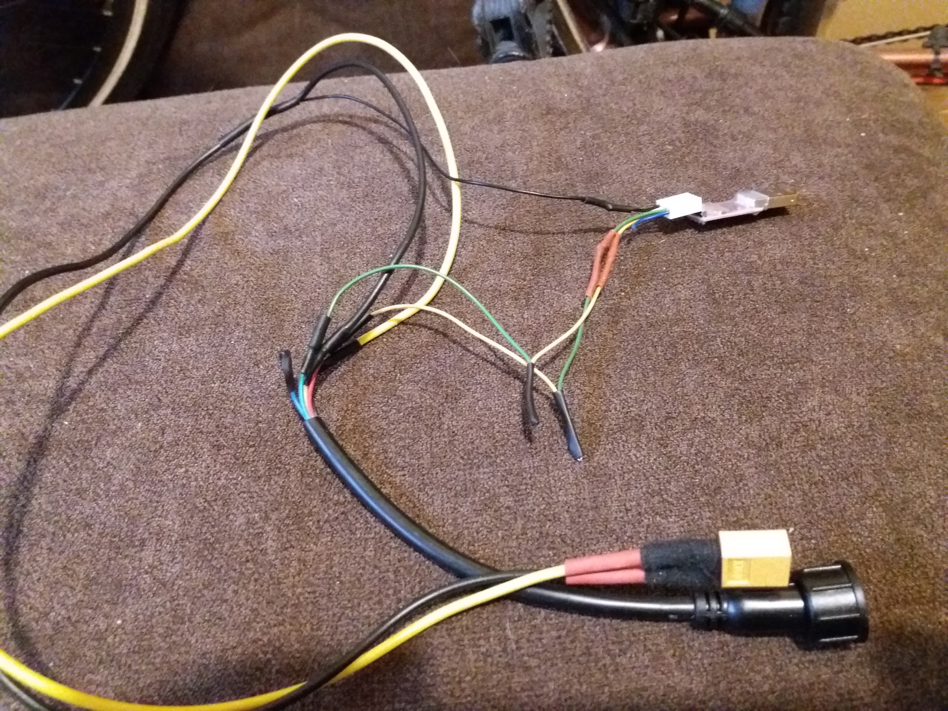

Post by redwater » Jan 01 2020 4:41am
My cables:
ST-Link
USB-UART , I remade this cable to direct power from baterry, because I burn DC-DC converter (my fault, short circuit :bolt: :flame: ):
DC-DC Converter was XL6019:
link to auction: https://allegro.pl/oferta/xl6019-przetw ... NjJkN2M%3D

Thank you. I tried to build that as well, and maybe failed totally 8) :roll:
Maybe also take a look here, and contribute: viewtopic.php?f=2&t=97083&p=1519258#p1519258

850C plug:
VIN - orange
Rx - white <--- Tx from UART
+26-54V - brown
Tx - green <--- Rx from UART
GND - black
Colours from 850C cable ofcourse.

Thanks. And Vin/Orange is same voltage as Brown wire? And for programming, does it need Orange or Brown wire to be powered? It's hard to see from pictures.
