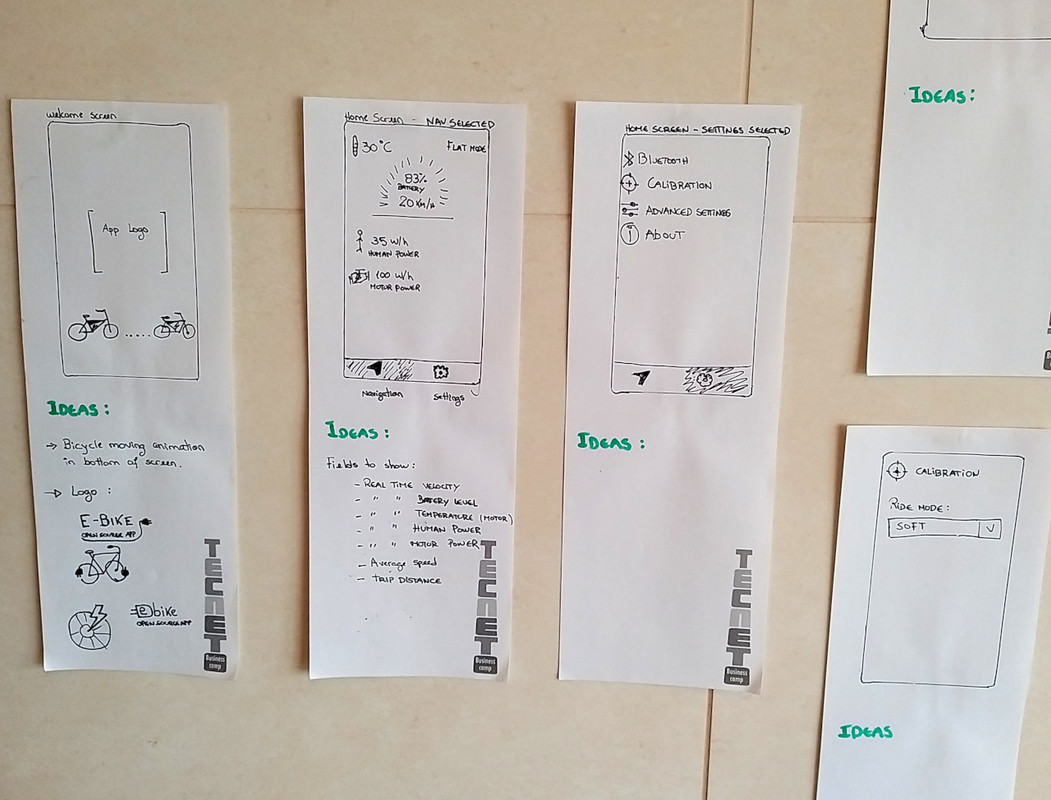

SW102 and 850C firmware, mobile app
I am very happy with latest 850C firmware and TSDZ2 firmware but still there are always things to improve. I wish next I could some stats like trip time and trip distance in a way they could be reset in a quick way from main menu. But the most needed feature is to configure max motor power in a quick way from main menu.
On SW102, the geeksville developer is being away recently and should not be back until at least the spring. No one is developing this firmware and it needs work, that is why there was no recent releases for it.
My wife wanted to learn developing a mobile app using recent technologies and so we did agree to develop our mobile app for TSDZ2 and SW102. I plan to help getting SW102 firmware working for this, so, I will need to put SW102 firmware working - I think I will work on it somewhere on next weeks.
The idea for the mobile app is to follow the market of this apps. We already looked at the apps suggested by you guys, when I asked about this before.
I think the most basic app will have a main screen like 850C has and will also have the configurations. Another level would be to have map navigation but I am sure this is very complex and I can´t even imagine this to be done soon.
There is one big issue with this app, that is both of us do not have the need to use it. I mean, there is no motivation to do this app other than learning more skills for improving professionally. I think the best motivation is when we use it daily and so we take value out of it daily!! That is why everyone helps and share about ebikes, because we use them daily!!
