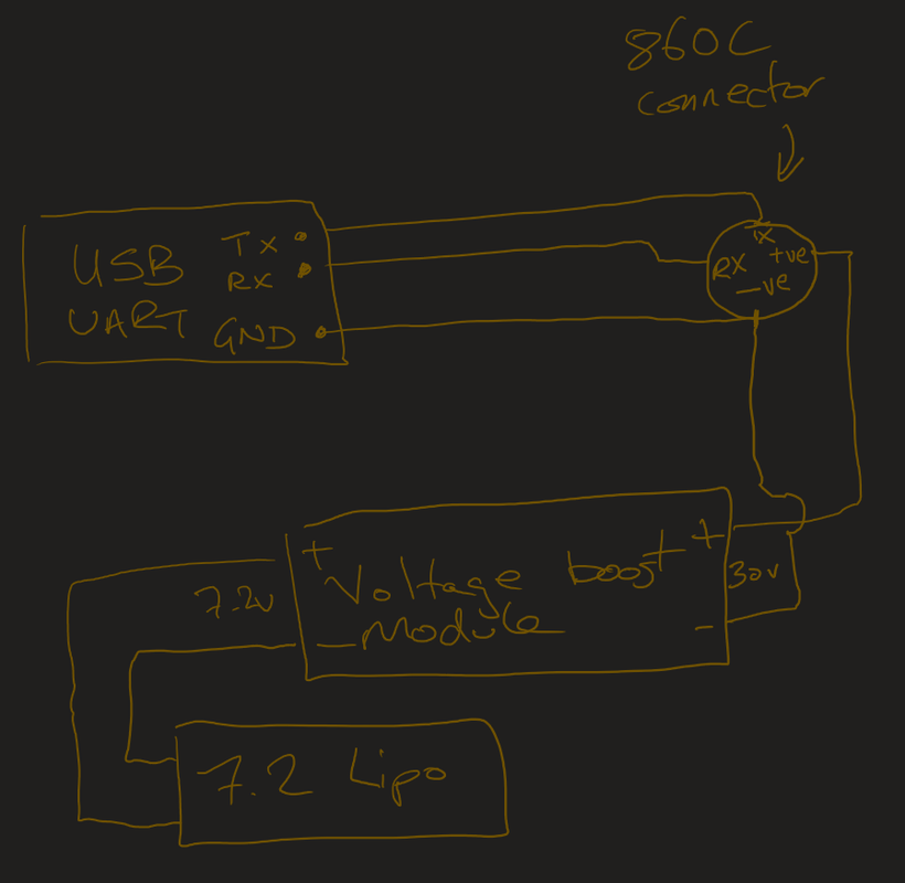

Hi there, I've just finished making up my cable to flash an 860C for use with my TSDZ2. I just want to ask about how the new 860C display will be powered once I've wired it to my TSDZ2 which uses a 52v battery. According to the TSDZ2 Opensource firmware Github wiki, the 860C uses voltage 27v - 35v. But my bicycle is using a 52v battery. Will I therefore need to do some sort of voltage reduction to the 860C display ?

rcx194 wrote:
May 01 2020 12:30pm
Please give details how you did your cable - will you power the display from your battery or from the power booster board?
If is from your battery, no problem as the display works for a battery up to 60V.

Post by rcx194 » May 01 2020 1:45pm
Hi, I wired up as follows:
Ok, I think I understand my confusion now, the Wiki refers to the max power of the booster board and not the 860C:

Any ideas on what to try next?
Don’t forget to connect GND to the display and to your usb ttl, that was my issue. Also you could try swapping RX and tx, maybe they’re inverted.

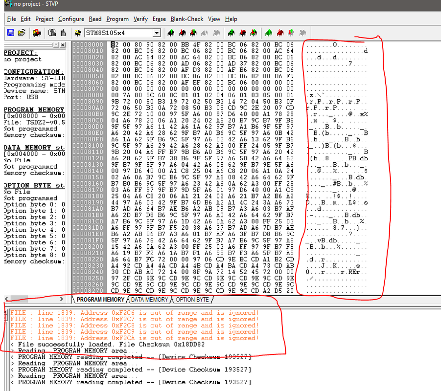

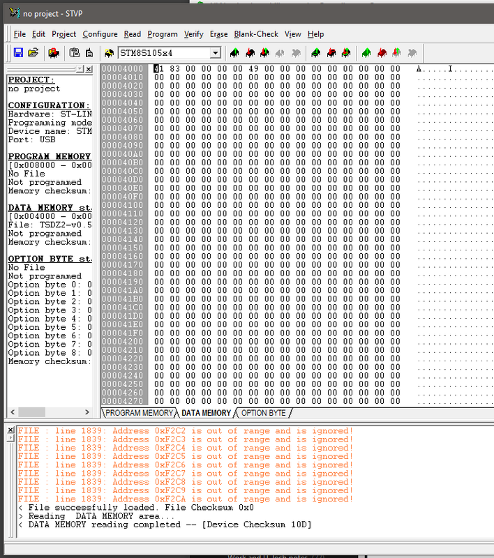

Thank you, you were right, ground was not connected as I didn't think it was needed. My display has now been flashed.
I've now gone to do my motor. Is it normal to see all those funky charactors in the STVisual software? And when I opened the TSDZ2 OpenSource 0.057.0 hex file I also got lots of out of range errors. Maybe my cable is too long, currently it's 30cm, I'll shorten it.

Post by rcx194 » May 02 2020 5:37am
Sorry I was in the wrong tab, I was in PROGRAM MEMORY instead of DATA MEMORY. The funky charactors are now gone. But I still get the "out of range" errors when loading the TSDZ2 Open Source .hex file.

Post by rcx194 » May 02 2020 5:49am
Sorry, again ignore my silly mistake. Had to set the processor to STM8S105x6. It was still set to x4 from when I flashed it with 52v firmware. Ok, now time to make the new wiring loom.
