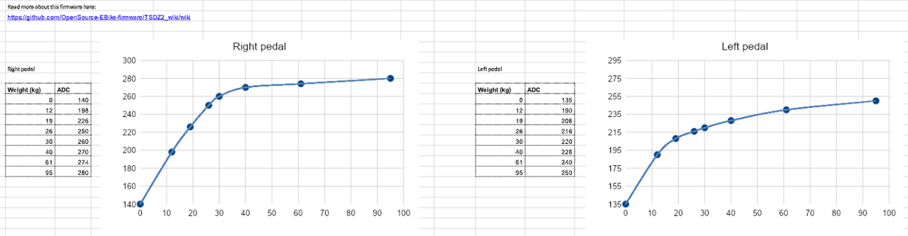

Please share your torque sensor calibration graph!!plpetrov wrote: ↑May 10 2020 9:31am1. For me the calibration value for 0 on the left side is 135 (minimum), while the maximum value I could measure was 140. For the right side the calibration value for 0 is 140 (minimum), with maximum value of 144. So I changed the correct torque sensor calibration values with the maximums. The result was that I was able to increase the Assist Level up to 20 and got very stable motor with almost no oscillations at all.
Well, I need to check this. If this issue is really happening, it can be the real issue.plpetrov wrote: ↑May 10 2020 9:31am2. Trying further to improve the configuration, I did changes while monitoring in the Technical menu the ACD torque sensor values and Weight with offset and Weight without offset. What I noticed is that the calculated values shown for both weights is always calculated based on the calibration curve for the left pedal. Pedal sides left or right however is always shown correctly. Experiencing also a peak in the motor power, I have the feeling that the calculations for the motor power output will take also the calibration curve for the left pedal always, instead of switching between left and right ones.
I would try to avoid this as torque sensor calibration is already somehow difficult. I want first to see the point 1. and 2. Please answer to 1.plpetrov wrote: ↑May 10 2020 9:31amAnd one question. When you are reading the torque sensor every 50 ms, do we have information for the angle position of the pedals? If yes, what is the resolution with which you can measure the angle? My idea is that in case we have linearity we may introduce simple correction coefficient in a function of the angle. If you think that this will make sense, I may try to perform further tests in order to collect information if this correction needs to be in function of the weight applied on the pedals.

Re: TSDZ2 mid drive with 860C, 850C or SW102 displays only -- Flexible OpenSource firmware (Casainho code only)
https://drive.google.com/open?id=13huOX ... ruOGCaWL9Tcasainho wrote: ↑May 11 2020 3:40amPlease share your torque sensor calibration graph!!plpetrov wrote: ↑May 10 2020 9:31am1. For me the calibration value for 0 on the left side is 135 (minimum), while the maximum value I could measure was 140. For the right side the calibration value for 0 is 140 (minimum), with maximum value of 144. So I changed the correct torque sensor calibration values with the maximums. The result was that I was able to increase the Assist Level up to 20 and got very stable motor with almost no oscillations at all.
These are my calibration values. If the link above is not visible, please use the one below:
As we can see, the values curve and scale on your left pedal are really different from the right pedal:plpetrov wrote: ↑May 11 2020 6:02amThese are my calibration values. If the link above is not visible, please use the one below:
If you are correct that there is a bug on the firmware that does not distinguish left and right pedals on weight calculation, then this is probably the issue!!
If you have in mind specific test scenario(s) that can confirm or exclude the existence of a possible bug or eventually give you more information needed, I can do the tests ASAP.casainho wrote: ↑May 11 2020 6:52amAs we can see, the values curve and scale on your left pedal are really different from the right pedal:plpetrov wrote: ↑May 11 2020 6:02amThese are my calibration values. If the link above is not visible, please use the one below:
Please do the tests, that will help a lot!!plpetrov wrote: ↑May 11 2020 7:02amIf you have in mind specific test scenario(s) that can confirm or exclude the existence of a possible bug or eventually give you more information needed, I can do the tests ASAP.casainho wrote: ↑May 11 2020 6:52amAs we can see, the values curve and scale on your left pedal are really different from the right pedal:plpetrov wrote: ↑May 11 2020 6:02amThese are my calibration values. If the link above is not visible, please use the one below:
(With assist level at 0 so motor will not run), maybe you can setup a curve that will output a very different value on left, like lower weight value of < 10 kgs for left pedal on all ADC values and the regular values on the right pedal - this way I think you can easily validate. Then do the inverse, change the curve for the right pedal and regular values on the left pedal.
I did a 4 tests and I am a bit confused with the results. Either I do not understand how it works or I have run into a corner case that is not covered in the logic.casainho wrote: ↑May 11 2020 7:36am(With assist level at 0 so motor will not run), maybe you can setup a curve that will output a very different value on left, like lower weight value of < 10 kgs for left pedal on all ADC values and the regular values on the right pedal - this way I think you can easily validate. Then do the inverse, change the curve for the right pedal and regular values on the left pedal.
I increased the value for the calibration point at 0 weight first for the right and then for the left pedal. My expectation was that I will get 0 for both Weight with offset and Weight w/o offset. I also decided to test with calibration enabled and calibration disabled, as still I was not sure what is the idea behind the enable and disable option.
1. Test
- calibration enabled, the calibration value for 0 for the right pedal was increased from 140 to 180;
- expected result - for the right pedal at calibration: weight with offset = 0 and weight w/o offset = 0;
- achieved result: left pedal: as expected;
right pedal horizontal: ADC torque sensor = 140; weight with offset = 31; weight w/o offset = 0;
right pedal rotated 30 degrees down from horizontal:: ADC torque sensor = 142; weight with offset = 33; weight w/o offset =3;
2. Test
- calibration disabled, the calibration value for 0 for the right pedal was increased from 140 to 180;
- expected result - for the right pedal at calibration point: weight with offset = 0 and weight w/o offset = 0;
right pedal horizontal: ADC torque sensor = 140; weight with offset = 32; weight w/o offset = 32;
right pedal rotated 30 degrees down from horizontal:: ADC torque sensor = 142; weight with offset = 33; weight w/o offset =33;
3. Test
- calibration enabled, the calibration value for 0 for the left pedal was increased from 135 to 180;
- expected result - for the left left at calibration: weight with offset = 0 and weight w/o offset = 0;
- achieved result: right pedal: as expected;
left pedal horizontal: ADC torque sensor = 135; weight with offset = 0; weight w/o offset =0
left pedal rotated 30 degrees down from horizontal:: ADC torque sensor = 139; weight with offset = 56; weight w/o offset =2
4. Test
- calibration disabled, the calibration value for 0 for the left pedal was increased from 135 to 180;
left pedal rotated 30 degrees down from horizontal: ADC torque sensor = 139; weight with offset = 56; weight w/o offset =56
Observations:
- There is no consistency in the behaviour for the left at right pedal while being horizontal at the calibration point at their side. Right pedal weight reading is very 32- to 33 while for the left we have 0;
- Calibration enabling - changes the value of weight w/o offset closer to the expected;
- very small changes of the ACD torque sensors values causes big jumps in the calculated weight;
After I completed the tests I saw that you ask to lower the values and not to increase them. Should I repeat the test with lower values? If yes how much lower?
I did some more testing with decreasing the calibration values for 0 weight on both left and right pedals. 111 for the left pedal and 107 for the left. Testing with different wights in the first interval looked OK, more or less proportional.plpetrov wrote: ↑May 11 2020 9:09amI did a 4 tests and I am a bit confused with the results. Either I do not understand how it works or I have run into a corner case that is not covered in the logic.casainho wrote: ↑May 11 2020 7:36am(With assist level at 0 so motor will not run), maybe you can setup a curve that will output a very different value on left, like lower weight value of < 10 kgs for left pedal on all ADC values and the regular values on the right pedal - this way I think you can easily validate. Then do the inverse, change the curve for the right pedal and regular values on the left pedal.
Then by accident put some more wight on the right pedal and I noticed a big jump at the moment we should have transition to the second approximation interval. The issue was present only at the right pedal and not on the left.
To make the thinks easier I set all the correct configuration values and started repeating the tests.
- for left pedal, I tried the first 3 intervals and all went smooth;
- for the right pedal the things were different. The first interval was OK. At the moment I was increasing the weight to go to the second, I noticed a jump in the values. For ACD torque value 200, instead of receiving the calibrated value of 12 kg, I got 18 kg on the display reading. In the switch for third interval, instead of the calibrated value of 19 kg for ACD torque value of 226, the display was showing already 24 kg.
The change of the values was happening with a jump of the weight, e.g. from 19kg to 24 kg at the moment of switching the second approximation interval.
So finally we have two issues:
1. The weird weight reading, if the calibration value at 0 wight is increased. The results of the first set of tests.
2. The jumps of the calculated weight at the moment of switching between the approximation interval for the right pedal.
Hope fixing these two issues will resolve all the problems.
