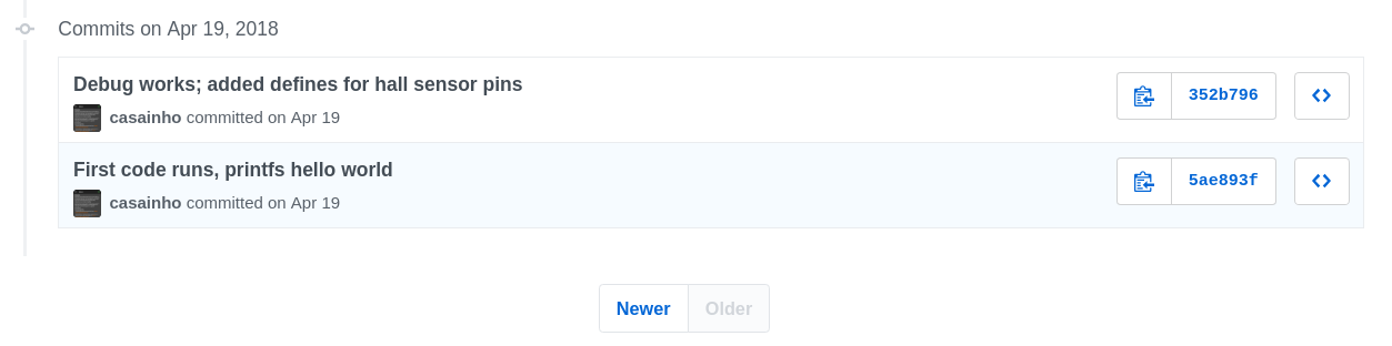

Post by casainho » Dec 30 2018 7:00am
AZUR wrote:
Dec 30 2018 6:22am
Thanks Casainho.
Have an Happy new year.
Thanks. And I started this project on April and in 2019 will be the first spring that I will be riding on mountains that I like so much and that I never did before -- ebikes and in particular TSDZ2 really improved my life (also for my family members!). I am happy that this technology will also improve the life of others on the new year!!
I don't know what will happen to ebikes but I already started to looking at my next project, something that may take 10 years or more and that I did discover the need using TSDZ2 on mountains!!
Other than cycling, a lot of people here also run/walk on mountains... put an electric motor on an already existing bicycle is kind of easy but developing an exoskeleton so the heavy people like me can run/walk on mountains, should be very hard!!
And for commuting, could be walking/running at 1/2 or 1/4 of effort be a good solution? could exoskeletons be more convenient to use than bicycles or scooters? -- I wish I could go running to work, with a happy big smile on the face :-)
There are no cheap chinese exoskeleton on Ebay or Aliexpress...
