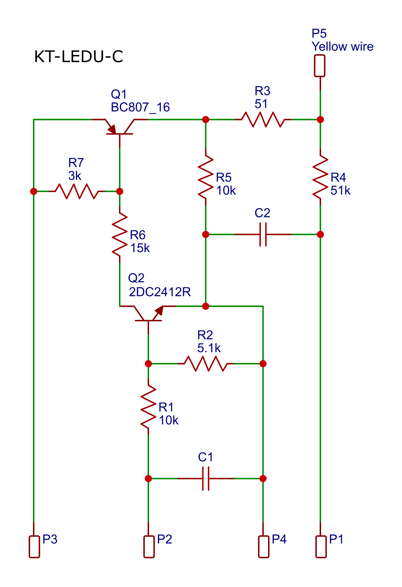

Light output voltage is your battery voltage, but current you can draw there only 100mA, so if you have 52v battery, then it is only 5.2 watt max so use it only to power relay etc, and use that to connect your light to powersource. Don't forget to add diode protection next to relay coil. Since an inductor (the relay coil) cannot change it's current instantly, the diode provides a path for the current when the coil is switched off. Otherwise, a voltage spike will occur possibly destroying switching transistor.

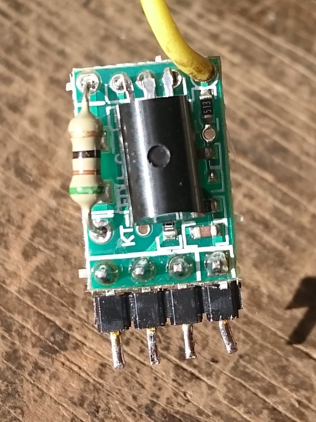

Well, I thought it was not much, and connected it. It worked for a very short while, now I dont have a light utput anymore :oops:
I will take the controller apart and see if i can fix it.
Now I have come around to take the controller apart. It seems like the only damage is a burnt resistor. The problem is, I can not see what values it should have. Does anyone here know, or possibly have a dissasambled controller and can take a look at the resistor?

I had resistor R3 burned and transistor Q1 in short circuit.
I solved replacing R3 with a 500mA fast fuse and Q1 with BDX54C (power darlington transistor with compatible pinout).
