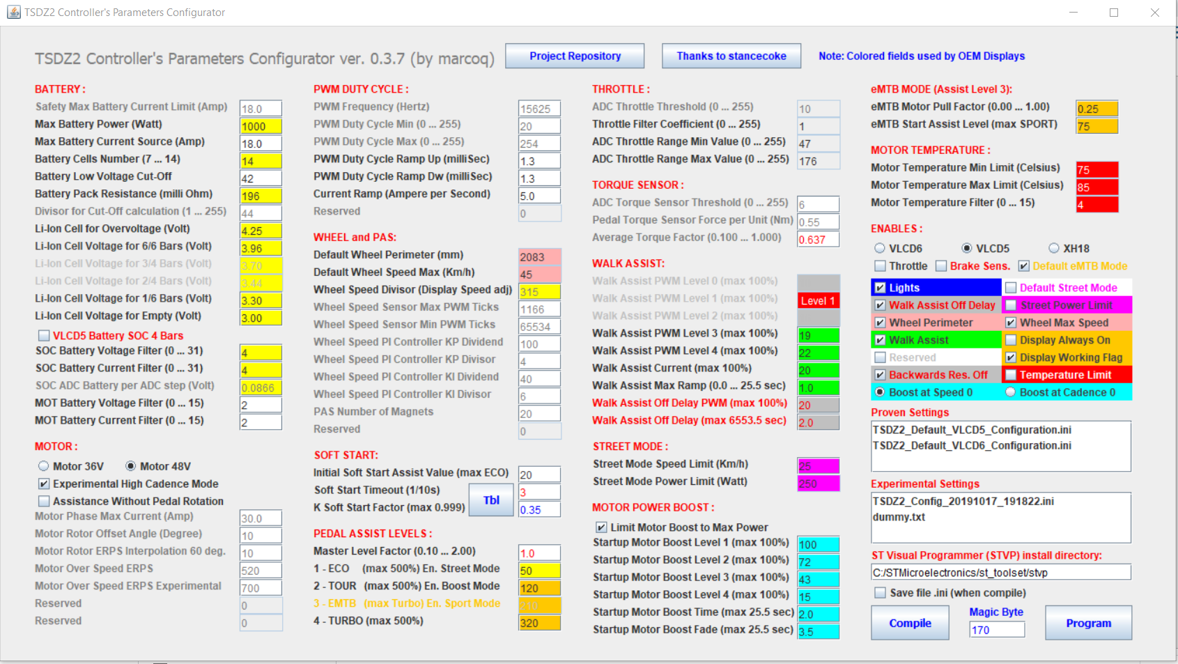

Guys can you help please, after the last update of Ackmaniac repo, i feel like the motor lost some power.
Also there almost no difference of the motor power between 1st 2nd and 3rd ( e-mtb ) assist levels. Only 4th makes me a rocket :flame: And walk-assist stopped working. ( I tried to select walk-assist off delay, i thought it should help to remove delay before assist start )
And i really don't feel any difference in the motor behavior between 2nd assist level ( normal mode ) and 3rd assist level ( e-mtb mode ) and this feel was the same even before this update.
Before i used 0.3.6 of Marcoq with the same config as shown on the screenshot below. With new Ackmaniac version i use same settings.

Post by Ackmaniac » Oct 18 2019 3:05am
2 days ago i fixed the bug when you switch from 2nd to 3rd. And give it a try without EMTB mode.
Here is a screenshot of the settings i use. But be aware that i have a 14S battery. So it might be better to use lower "Motor over Speed ERPS" when you have a 13S or 10S battery.
2019-10-18 10_06_16-TSDZ2 Controller's Parameters Configurator.jpg (239.04 KiB) Viewed 1719 times

Ackmaniac wrote:
Oct 18 2019 3:05am
Ackmaniac, I tested your version and the motor feels really smooth. But eMTB mode doesn't seem to be working, however strong or fast I was pushing the pedals, assistance wouldn't be more than at 1st level. I have the latest version from Oct 16th. When I turned off eMTB mode, the 3rd level worked as it should. Also the walk assist function doesn't work at all, I'm not using the Off Delay mode. I have a 36v motor and VLCD6.
