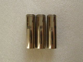

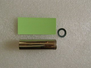

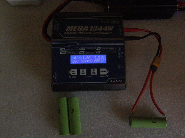

I have tested 3 cells to check the consistency of parameters.
Each cell weights 68.6g, are at 3.58V and my YR1035 shows internal resistance of 22 mOhms. Cells come completely naked without any signs of use. I have added top insulation sticker and shrink wrap for extra safety.
Image Image
Capacity test at 1A showed about 5Ah.
https://i.postimg.cc/L68h52YL/P2080274.jpg
https://i.postimg.cc/50J2VVWH/P2100276.jpg
Capacity test at 7.5A showed about 4.8Ah.
[youtube]www.youtube.com/watch?v=u4zRYvkYTz0[/youtube]
[youtube]https://youtu.be/pXVEqKn1t80[/youtube]
[youtube]https://youtu.be/LZYLJYLt0n8[/youtube]
After all tests internal resistance have not changed.
So I can say that these cells are genuine and new, all parameters correspond to datasheet.
