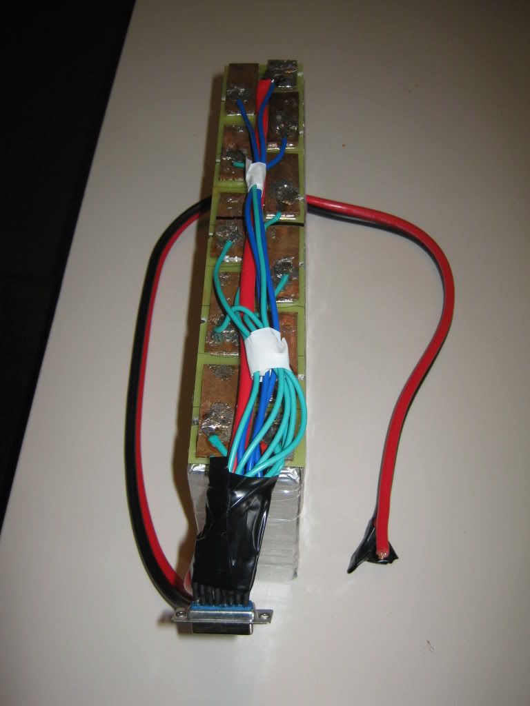

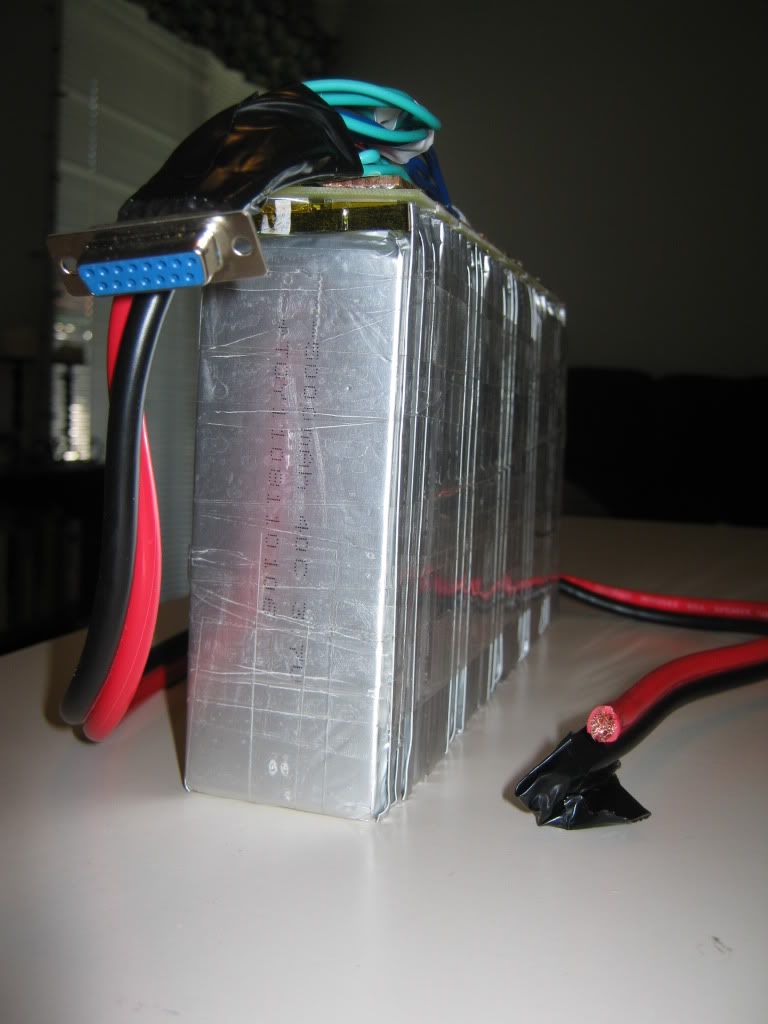

Hi Guys,
I have finished a 10s3p Turnigy 40C LiPo pack as a prototype. The balance leads will be much neater than this since I've had the PCBs made up, but I am wondering whether or not there would be a market for these.
EDIT: This very pack ^^ is for sale - $300 free shipping within Australia :D PM for details.
Edit #2 sold :D
The balance leads can come with any kind of plug you want, but the minimum main pack wiring gauge would be 8 ga.
What are the advantages of this system over a plug and play arrangement from Hobbyking? For a start, the wiring is reduced significantly. No paralleling of balance leads because it's already a complete 40 V, 15 Ah pack. It can handle serious currents - I have tested a continuous 50 A current and nothing gets hot. I have done 3 minute 100 amp discharges and the nichrome load gets too hot and melts. The soldering method is rock-solid - bursts of 400 A do nothing to these terminations. Also, I manually check each cell before loading it into a 40 V pack, so QC is probably better than HKs... I'm thinking of buying an internal resistance tester since I'll be putting 550 cells into the race bike.
It is also very compact - 560 Wh in a 4 kg battery, measuring only 145 mm high 50 mm wide and 270 mm long. I can easily make a 20S pack two rows wide, and the wiring is even more compact. (Edit, I had 660 Wh here - sorry! Typo!)
I have 12 or 14 of these boards I can use to build packs. If anyone is interested in these packs let me know and I will order more cells. The race bike will need ~600 cells to accommodate the odd DOA cell, but I can order an extra hundred or so and make these packs up. These cells are brand new and cost about $11 each from HK, and a pack like the one photographed would cost $330 to build. So I might consider selling them for $450. Sounds reasonable? I am so shit at the salesman pitch :lol:
Let me know what you think. I can also make 6S5P packs but these are for racing only, I would think ;)

That looks very interesting and tidy! Do you source loose HK cells or culling them from bricks? EDIT - nevermind, my reading comprehension took a dump...

These are the cell I use:
http://www.hobbyking.com/hobbyking/stor ... duct=18562
40C Turnigy individual cells. They are the 5000 mAh ones, measuring 50 mm wide, 9 mm thick and 140 mm long. I use individual cells cause I know they haven't been botched during 4S construction at the HK factory :)
The demo pack I have built is 15 Ah, nominally 38 volts. 42 volts fully charge and 35 volts empty. It weighs about 4.1 kg and is about 270 mm long, 145 mm high and 50 mm wide.
The copper terminations have a cross-sectional area of 35 mm2. I have drained it to 35 volts from fully charged at ~150 amps from this pack and nothing gets even remotely warm. The Anderson connectors got warm though. A dead short resulting in over 300 amps doesn't concern these cells at all, but this was tested at 7.5 volts, not 40.
All up, they rock :D

OK so I sat down and calculated how much these things cost for me to make. I have a fairly good idea about most parts, but the shipping of cells from Hobbyking to Perth, plus taxes and customs fees are the real unknown.
Cost Breakdown of a 10s, 3p pack like the one pictured:
10 pieces of tinned copper bars @ $3.50 each = $35 (I have the quote if you don't believe me)
30 cells from HobbyKing @ $15.70 each = $471*
11 balance wires, JST plugs roughly = $3
1 PCB board to suit @ $7 each = $7
Total = $516, or about $905 per kWh.
* this is assuming the Hobbyking shipping rate as per the calculator on their website to Perth AU. Naturally it's quite expensive, but if I was to order a shitload of these cells from Hong Kong it would be a bit cheaper per cell, but then you have to add customs fees and the GST etc. So for now I think this is quite a reasonable estimate.
To ship stuff a single 13 kg pack overseas costs about $16 per kilogram. It can get as low as $7 per kg if I start moving 650 kg worth of stock, which would require me to get a massive bank loan to even buy the parts :lol:. Within Australia it's probably about $8 per kilogram. And none of this assumes I plan on making a profit :lol:
Anyway, there you go :)

Rodney64 came ofer to my place to have a look at the pack I'd built and we got talking about different configurations. Right now I can do 15 Ah and 25 Ah based on the boards I have, but I'm wondering if 20 Ah (4p) would be useful too?
Couple of pics of layout and size:
Shorter
Longer
15 amp hour varieties:
10s3p - 10 cells in series, 3 in parallel ~38 V, 15 Ah, 570 Wh stored, 270 L x 50 W x 150 H (mm)
15s3p - 15 cells in series, 3 in parallel ~57 V, 15 Ah, 855 Wh stored, 410 L x 50 W x 150 H (mm)
20s3p - 20 cells in series, 3 in parallel ~76 V, 15 Ah, 1140 Wh stored, 270 L x 100 W x 150 H (mm)
30s3p - 30 cells in series, 3 in parallel ~114 V, 15 Ah, 1710 Wh stored, 410 L x 100 W 150 H (mm)
20 amp hour varieties (new!):
7s4p - 7 cells in series, 4 in parallel ~26 V, 20 Ah, 520 Wh stored, 250 L x 50 W x 150 H (mm)
10s4p - 10 cells in series, 4 in parallel ~38 V, 20 Ah, 760 Wh stored, 333 L x 50 W x 150 H (mm)
14s4p - 14 cells in series, 4 in parallel ~52 V, 20 Ah, 1040 Wh stored, 250 L x 100 W x 150 H (mm)
20s4p - 20 cells in series, 4 in parallel ~76 V, 20 Ah, 1520 Wh stored, 333 L x 100 W x 150 H (mm)
25 amp hour varieties:
12s5p - 12 cells in series, 5 in parallel ~45.6 V, 25 Ah, 1140 Wh stored, 270 L, 100 W, 150 H (mm)
18s5p - 18 cells in series, 5 in parallel ~68.4 V, 25 Ah, 1710 WH stored, 410 L x 100 W x 150 H (mm)
Energy density is about 140 Wh/kg.
Cost to customers is going to be about $1.15 per Wh, which includes me paying myself something.
