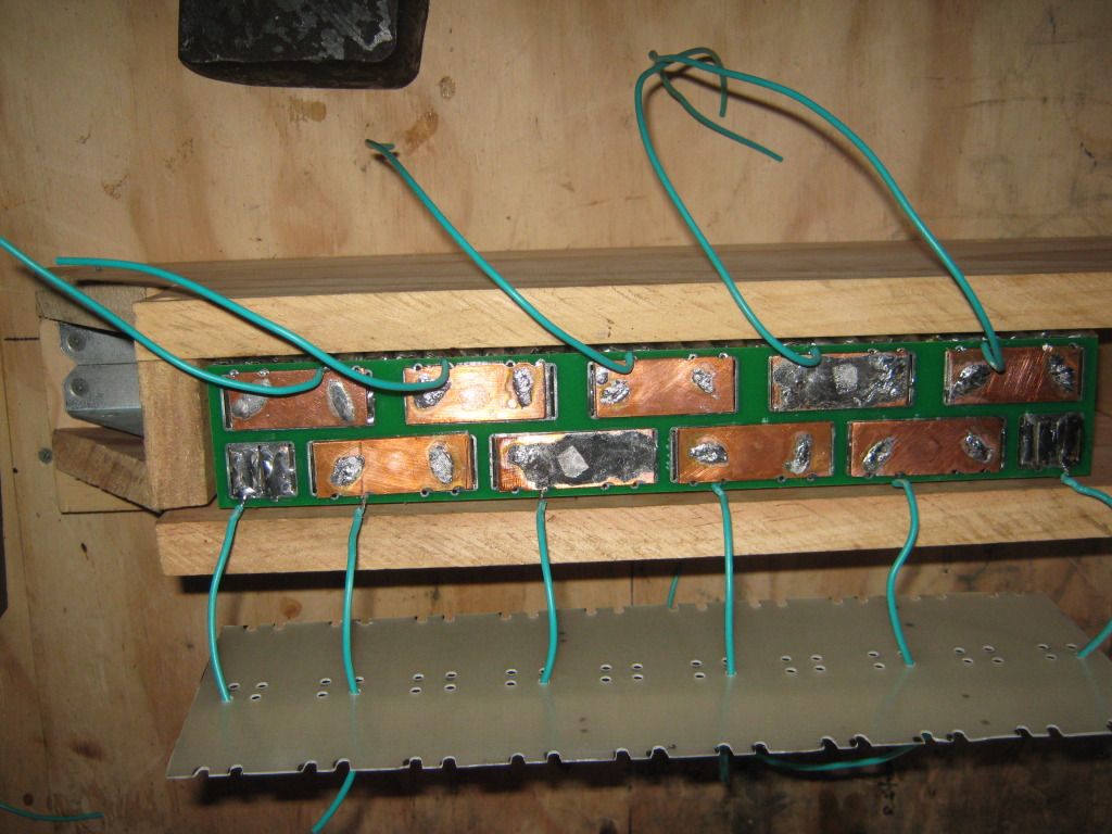

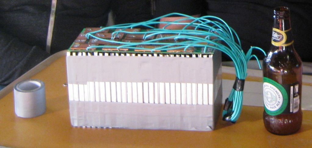

Nice!
Is the plastic at 90 degrees to the frame upright? As long as it's square and solid to the base we can start. Come around on the weekend; tomorrow is best as I'm out Sunday afternoon.

It's not quite square but will work on it in the morning, it's 5ml gap at the bottom.

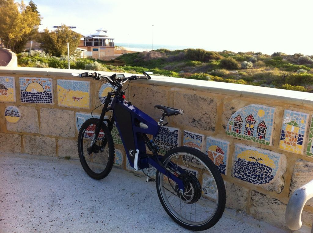

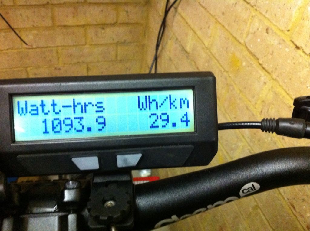

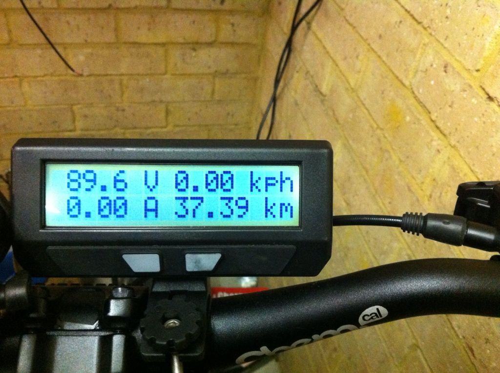

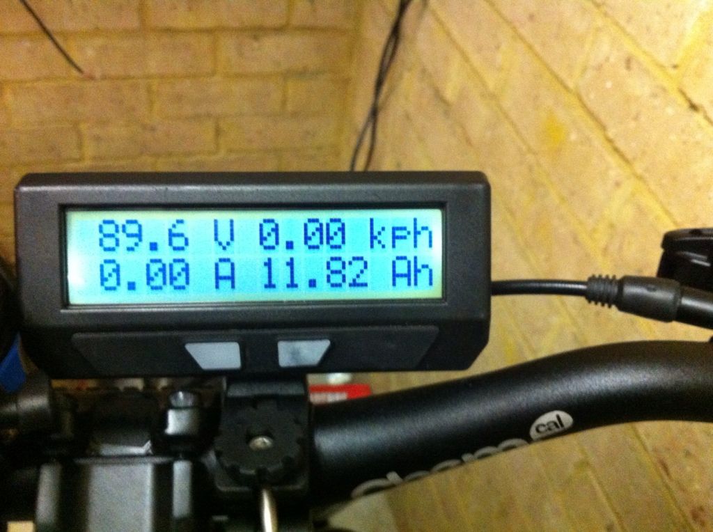

Got some good info today on the cycle analyst
11.8 amp hours used. I think the pack has 13 usable amp hours.
38 kilometers travelled in a gusty day to the beach
29 watt hour kilometer at a average speed of 32.8km an hour

Great to hear Rodney :D
I think you can probably push 13 Ah safely. You might be able to squeeze all 15, but you're really punishing the cells after 3.5 V per cell. The next few tests will be a) are the cells still in balance after discharge and bulk charge and b) are the cells staying fairly close to each other during discharge and charge.
I think your phase wires might have appreciated the upgraded connectors :) Have you re-attached the Lyen controller to the top bar?

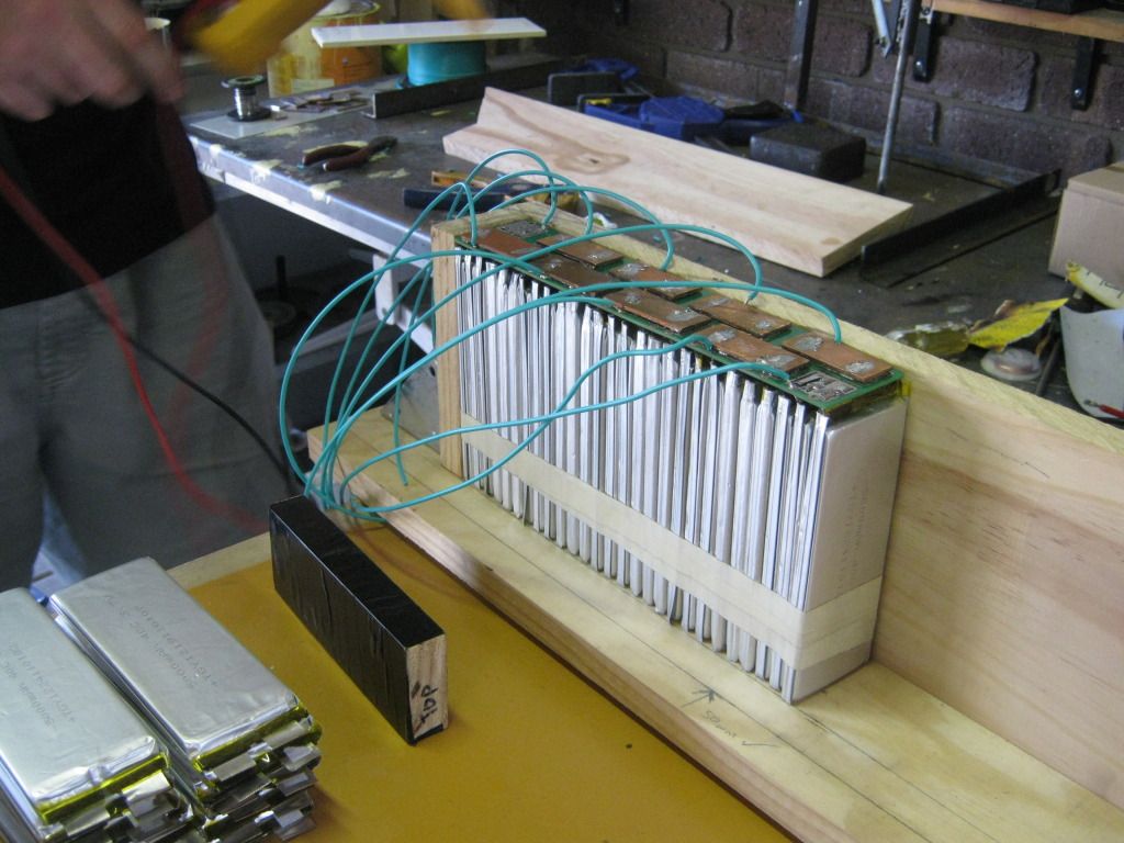

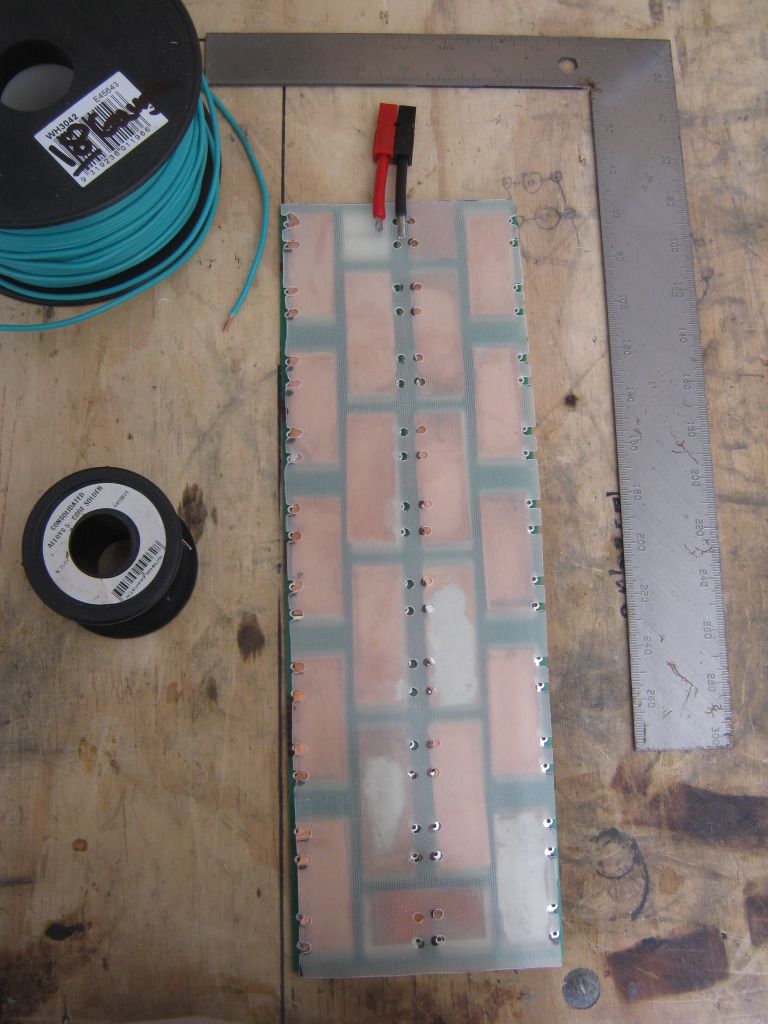

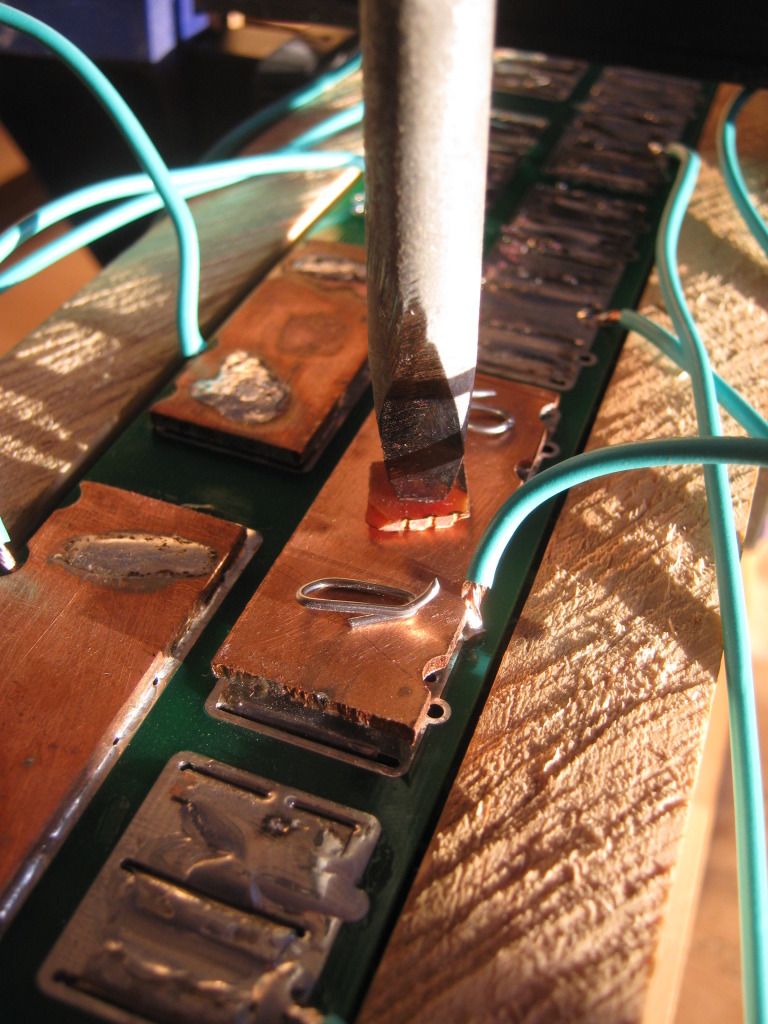

You can probably start tinning the copper bars. I find it works best to put solder on both sides. This way, when building the pack and you're about to lay into it with a giant frock off soldering iron, the heat is conducted efficiently into the bus. For tinning you can probably to it between two bricks and hold a torch under it, but a big iron works best.
I'll cut some FR4 up with notches for the balance wires and cable ties. I got plenty of 22 gauge and 18 gauge wire we can use. We can put some 12 gauge wire on the two half-packs for charging too - two pairs of Andersons would work. When the money comes in for a 75 V bulk charger you can just use the two end leads.
I'm going to start putting a 20s, 17 Ah pack together using the 5800 mAh cells. It will be more like a real 15 Ah, but would be ideal for a mid-speed long range e-bike.

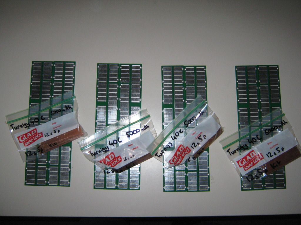

OK guys,
I have four sets of 12s 5p LiPo kits to get rid of. I ordered a whole stack of these boards thinking my race bike was going to run off a lower voltage, but the hardware wouldn't allow it. So I have a stack of boards and copper left over.
These 12s 5p kits would give you a nominal ~44 V and a whopping 25 Ah capacity. The low voltage suits anyone running a slower wind for hill climbing or towing. At 25 Ah - what's sag? :D You can buy one and a half kits for 18s too; probably a more useful voltage for reasonable speed. All of the copper is currently un-tinned, but it's not that hard to do yourself, you just need a flapper wheel on a drill to get it back to bare metal before tinning. If you are really desperate I can tin them for you.

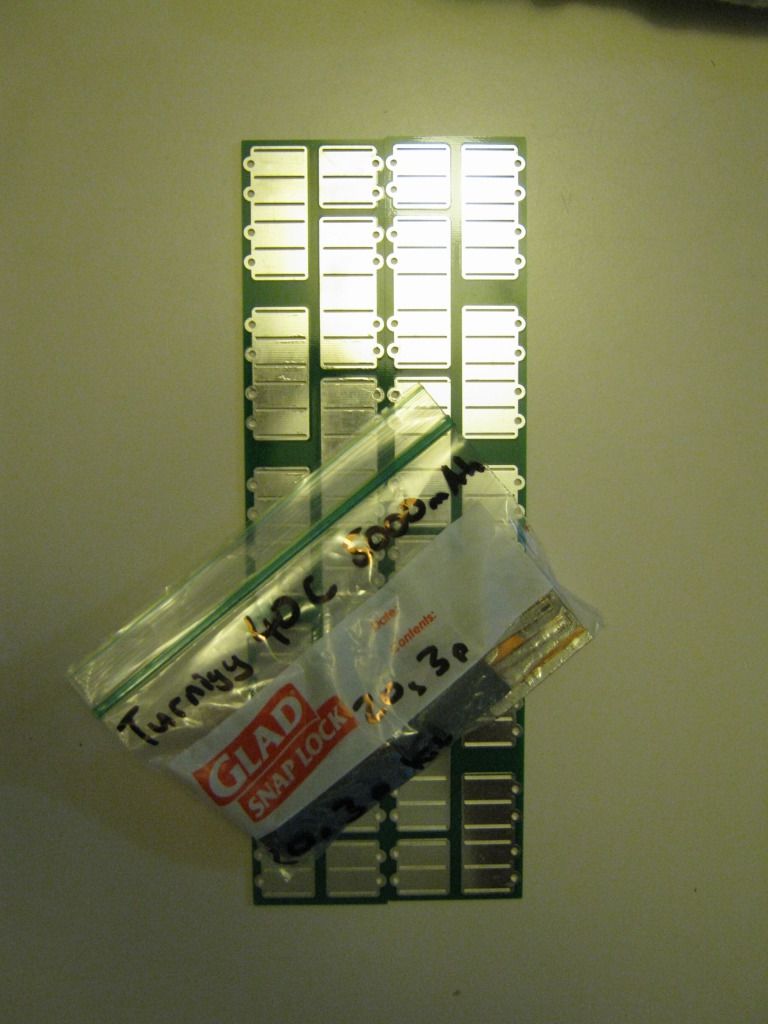

I also have the 6s 5p bare boards for sale if you want to cut your own copper.
Also available is another 20s 3p kit with tinned copper.
This gives you a 10 kg pack with ~75 V nominal and 15 Ah. The perfect machine for moving fast :)
I also have three spare boards too if you're keen to cut your own copper.
Finally I have a stack of 7s 4p boards, perfect for 14s packs. Again, you can cut your own 18 mm wide strips of copper for a convenient 52 V, 20 Ah pack. I can cut and tin the copper for you if you like, I just haven't got around to it.
All two-board kits are going for $120. So a 12s 5p kit is $120, a 20s 3p kit is $120, and a 14s 4p kit is $120. Individual boards with no copper is a much cheaper way to go - $10 each and they should fit in an air mail bag :). I just need to get rid of them, but the copper was quite an outlay so getting something back on them would be nice.
Don't forget all these boards come with plated through holes for soldering balance wires to, and are fully compatible with Method's LiPo protection kits.
Shipping to the USA is normally about $27 but I'll throw it in free cause I want to see these go to a good home. Shipping within Australia is also free.
Oh, and instructions for assembly and support are provided. IN fact I reckon AussieJester and I will put a video together for youse for a laugh ;) Followed by reverse donuts in a CRX :lol:

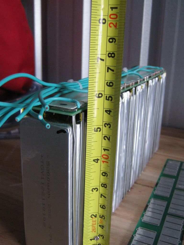

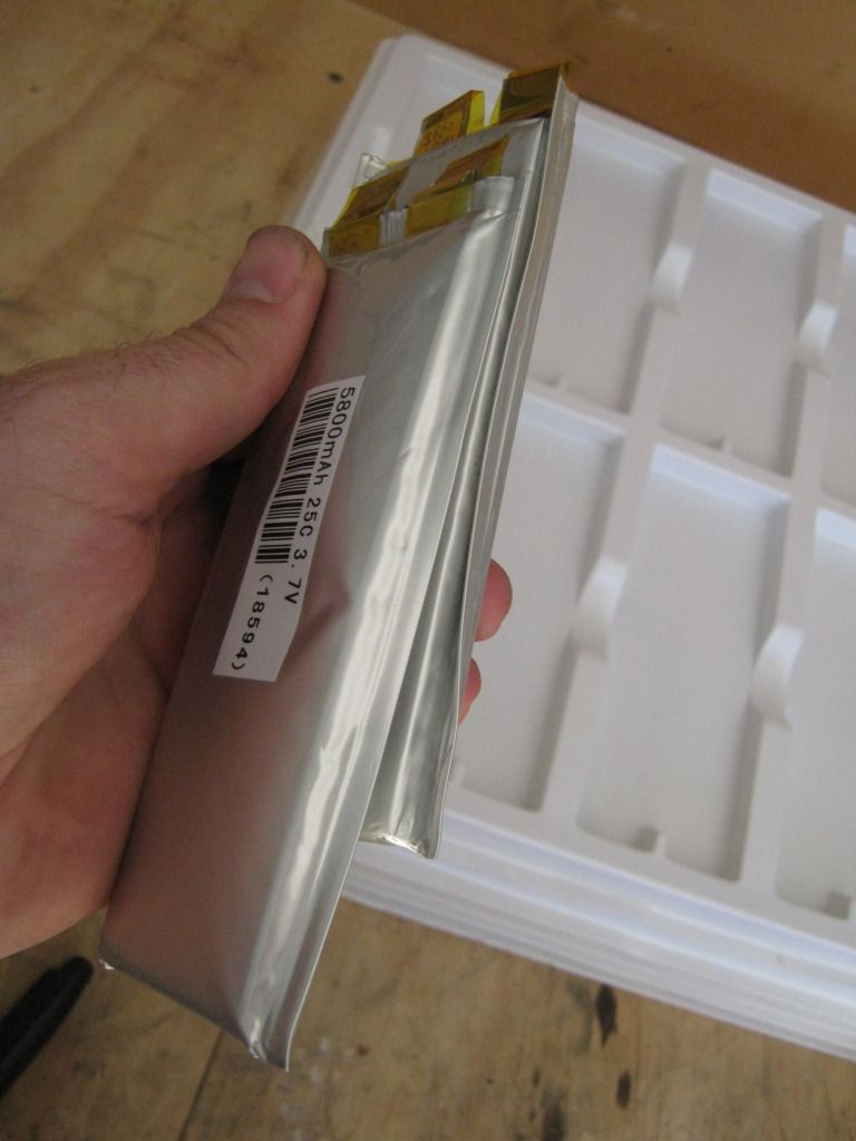

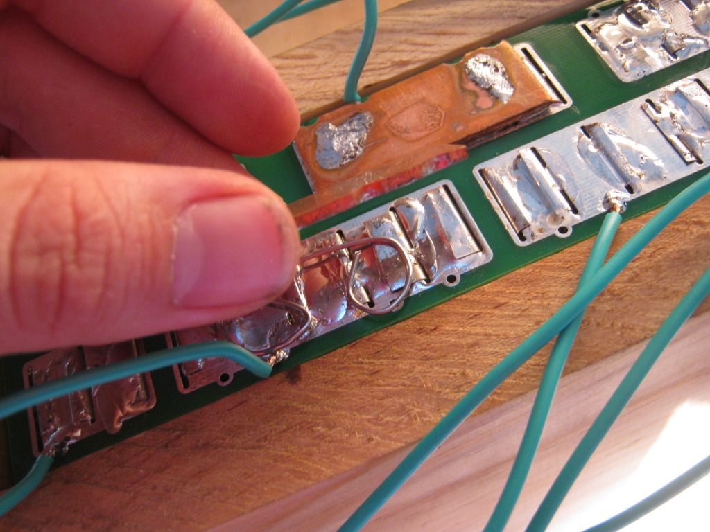

In the last big HobbyKing order I made, I ordered about 37 of these 5800 mAh 25C cells. I got Full-Throttle to make a new PCB up for me since these cells are slightly thicker than the 40C cells. I finally bit the bullet and bought another 32 of them to build a 20s,3p pack which I will sell here on ES for $1200.
In my honest opinion, don't go for the lower C-rate cells if the quality control I have experienced is anything to go by. The 40C cells had 2 bad ones in 180. These 25C cells so far have come up with 3 in 37 :? At least I can sort the duds from the good ones myself.
So, what's new about this one? Well I have decided to use some of the G10-FR4 fibre reinforced epoxy as a cover for the terminations, protecting the balance wires from potential shorts. I have also filed out slots for the wires on the copper bars just to make it a bit easier, and the cover will have holes with cable ties to secure the balance leads.

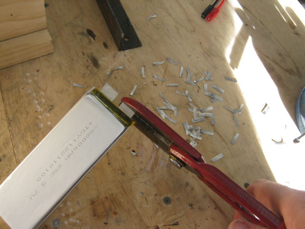

Pretty neat eh? I have also made it standard to trim the cell tabs down to a more manageable size before scuffing and tinning. It just seems to make the copper sit down nice and level on the boards. Previously they would look a bit wonky, but still take the current.
So, soon I'll have yet another Hi-Power LiPo pack ready to go :D

Love it why cut so much off the tabs ?
jonescg   1.21 GW
1.21 GW
Posts: 3504
Joined: Aug 07 2009 9:22pm
Re: Assembled Hi-Power LiPo battery packs - any interest?
Post by jonescg » Oct 04 2012 7:12pm
It's really just to ensure they don't overlap, creating a high point. This way when the copper is soldered down onto the board it will sit evenly and look a bit neater.

Some visual aids for the soldering of these boards...
First, solder your balance leads in. You can use any of the holes provided, but if you wanted to solder Method's LVC/HVC boards onto the cells permanently you can.
Place a generous ring of solder around the pad and lower the copper block down onto it very carefully. It's quite easy to short things!
Then place the 'third finger' or any other kind of downward force onto the copper with a piece of heat-resistant stuff to limit the amount of heat being conducted through the steel. Put a couple of bits of solder either side to ensure the irons have good contact with the copper.
Carefully weight the third finger down with something heavy. I use a 4 kg lump of steel. I want a really good connection! It is really important that the cells are secured in a jig like my wooden box. The 40 N of downward force needs to be shared evenly across a half-dozen cells.
Then place the two hot irons onto the solder patches and watch the whole lot melt. I use two 200 W irons with the tips cut off to a really blunt surface for maximum heat conduction. Don't let off until you see the solder squish out the sides of the copper and the board below. Then when you are happy with the way the block is sitting, put the irons aside and cool the copper with a damp cloth.
And you're done!
I think this will work nicely to keep the wires out of the way, but should you need to replace a few cells, getting it off will require cutting your connector off. So I might just cut the boards into two narrow strips with slots on both sides instead.
Edited for clarity :)

I'll let AussieJester update his CHroMo CrUIsER thread in more detail, but I thought this battery was pretty frocking sweet. 18s, 3p, 1000 Wh and under 7.5 kg.
During assembly:
1000W, jonescg and AJ all enjoying a drink in homage to the LiPo.
And a close up of the pack. Later on, Kim and I soldered the 8 gauge wires onto the main terminations.
So, if you would like a 20s 3p, 74 V, 1250 Wh pack, I got one for sale for $1200! Looks a lot like this one ;)

I just put the G10-FR4 board on top to prevent the balance wires from shorting on the terminations. Looks pretty schmick eh?
They don't sit real high, which is great.
