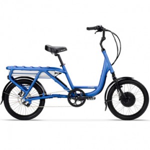

Do you mean internal dimension is 170mm x 450mm x 350mm ?
If that's the case, the enclosure allow a maximum of:
170mm / 20.2mm = 8 cells on the width
450mm / 20.2mm = 22 cells on the length
350mm / 70 mm = 5 times each
So 8 * 22 * 5 = 880 cells max or 8800wh max capacity.
I'm currently ordering a cargo bike, the ODK V3:
However, there is maybe a chance I could combine my cargo bike with this bike?
I'd see the bike updated like this:
It would use:
- John's hubmonster with 190mm dropout and axle with 1" diameter and 15.5mm flat.
- Motor would use moped tyre which would be equivalent to a 20" bike wheel.
I don't have welder but a quite precise idea of what I want.
How does that look? :mrgreen:

Cool. I think that will work out really nice. A wide frame Vector with a bad ass rear rack. You can go shopping, buy cases of beer unload at home then do some hard core street riding all on the same bike. Dude, do not remove the rear shock! That would be crazy man. If you need to haul really heavy loads, either get a 900 lbs Ti spring or find an ATV or snowmobile shock that can handle the weight you are planning.
If you have the rack mount on the swing arm like on your drawing, You probably should anchor the rack to the frame as well. Anchor the rack similar to how the swing arm is anchored. If you use an anchor point just below where the bike seat goes, the whole rack can move up and down with the swing arm. If you are all about longtail bikes, like I've seen you been considering lately in order to get more cargo with you without a trailer you could do like them longtail's. Add lower racks to the swing arm as well. Pack in saddle bags or large panniers and you can still enjoy full suspension and have a nice comfy ride. Take the longtail to a new level. Go full suspension and with a crazy ass motor as well.

macribs wrote:Cool. I think that will work out really nice. A wide frame Vector with a bad ass rear rack. You can go shopping, buy cases of beer unload at home then do some hard core street riding all on the same bike. Dude, do not remove the rear shock! That would be crazy man. If you need to haul really heavy loads, either get a 900 lbs Ti spring or find an ATV or snowmobile shock that can handle the weight you are planning.
Ahah yes that would be a good thing to have a high power cargo bike!
I wasn't thinking to remove rear suspension, but rather to move to 2 shocks on closer to the end of the rack (see 2 pinks lines).
By doing that, i hope to reduce the unsprung weight to the rear wheel only, same as what lots of moped are having!
Why would anchoring the rack would be better than having double suspension on the entire frame + rack?

Ahah yes that would be a good thing to have a high power cargo bike!I wasn't thinking to remove rear suspension, but rather to move to 2 shocks on closer to the end of the rack (see 2 pinks lines).
Glad to hear you don't plan on riding without full suspension. I pictured you might weld the swing arm to the frame when I saw you written remove shock.
I think by going with 2 shocks you are in fact increasing the unsprung weight. Those pink lines are similar to what moped used to have - back in the 1970's and early 1980's. I am sure there is a good and valid reason why all manufacturer chose to use mono shock in the rear and have stuck with it since the early 1980. Not only mopeds went to use mono shock, but dirt bikes, motorcycles etc. More centered weight and less unsprung mass is my guess. Sure there are other reasons as well.
If you keep the swing arm like it is now, and just anchor the cargo rack to the swing arm, ie where you got the pink lines, then I think you will need another anchor point to keep the cargo rack able to take on big loads without putting all that stress on the swing arm. So yes by choosing the right mono shock and anchor cargo rack both to the frame itself and the swing arm you will have a sturdy and strong cargo rack, and the load from the cargo will be spread onto the frame as well as the swing arm. I'll bet you can even pick up two ladies at a time and ride home without problems 8)
And if not, you can just stretch the swing arm to fit them big ass ho's :wink: :lol:

Ok make sense. Where is the additional anchor point I'd need to add to the rack?
And what's the best way to move this project forward?
Can arthur help? I want to make sure the bike end up with decent geometry :mrgreen:

cwah wrote:Ok make sense. Where is the additional anchor point I'd need to add to the rack?
I am sure Artur could help. That frame is a prototype thing I guess. So they are probably finishing up the frame right now.
Ask him if he could make an anchor point, maybe something like this? If not any welder close by you could step in and make this for you. Great thing about steel - it welds easy. And the good thing here is you don't alter the bikes geometry. Look at the cargo rack as a parallelogram, it will move up and down parallel to the swing arm.
Wheel base is still the same, same goes for fork angle etc.

@cwah forgot one thing earlier. If you where to use shocks in this pink lines you would move more of the weight from the cargo all the way to the very back of the swing arm. That would not be a good thing, and the swing arm moves the most in that part. The more weight you can have on a frame anchor point the more you will reduce the unsprung mass. So maybe you should consider a design where your cargo rack is anchored to the swing arm, but further to the front of the swing arm. Where the movements of the swing arm is smaller - compared to the very back where movements are at the largest.

Yes ok makes sense. The anchor point can be a good thing.
Another way to do it would be to use Edgerunner design:
Basically extend the swingarm (I'd have a smaller rear wheel) and add support for edge runner for the heavy duty P rack:
http://practicalcycles.com/products/176 ... -rack.aspx
Would that be a better design?
What do you think Arthur? You'd be the first one to build and sell a high power cargo bike. You'll probably find customer and open new market :mrgreen:

not with full suspension bike.
