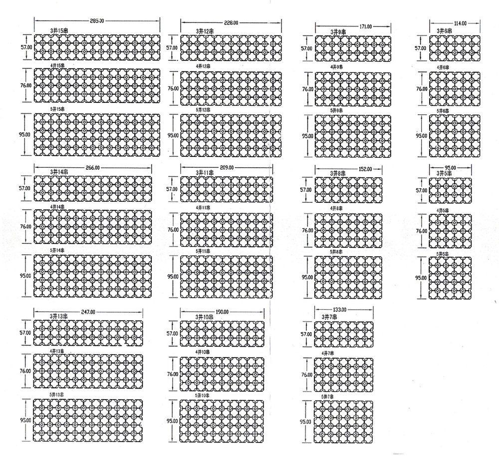

I scored a cheap ebike which had suffered a battery fire so made up a 14S5P battery with 70 of my Samsung 29E cells recently.

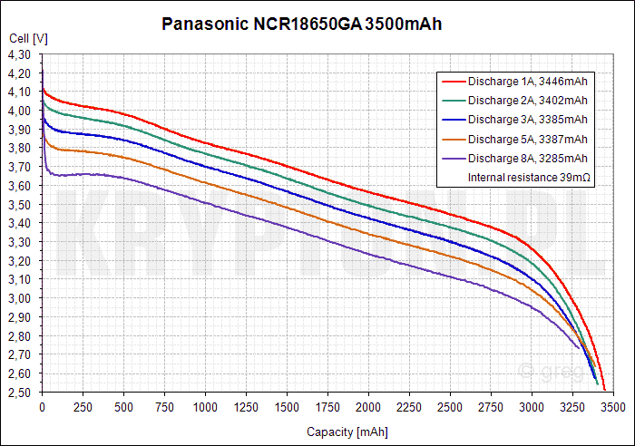

Producer recommend for these Samsung max dc cont 2,75A and 8,25A peak.
So for 10S4P should be max 11A cont. and 33A peak (for get high capacity), If have higher discharge they have lower capacity.
Panasonic's PF's have better capacity on higher discharge. All depends on quantity of cells. If have alot of cells dc will lower per cell :P

flangefrog wrote:I scored a cheap ebike which had suffered a battery fire so made up a 14S5P battery with 70 of my Samsung 29E cells recently.
I used these nice battery holders, apparently made of heat proof material. Some of the cells were a bit hard to fit so I used a deburring tool to chamfer the edges of each hole. When putting the second holder on I tapped it lightly with a hammer to set it in place.
Would you share where you found them?
I bought them from here:
http://www.aliexpress.com/item/Free-Shi ... 90291.html
http://www.aliexpress.com/item/18650-li ... 76392.html
If they don't have the right size or quantity you can send them a message. Slow to send and slow shipping but got here eventually. Note that the bulk prices for both nickel and holders are pretty good. If you get nickel somewhere else make sure it's the right size for these holders, the nickel strips for the snap together holders or cells with no holders are a slightly different spacing. Also they're not always the same thickness, the stuff I got was 0.15mm.
Available sizes:
The 180mm Φ115mm (180mm flat, 115mm diameter) heatshrink from here is perfect for the 5P holders, you can ask him for transparent if you prefer. He also sells silicone wire and all sorts of other heatshrink and tubing. Fast shipping and good service:
http://www.ebay.com/itm/191657288012
You can also get the holders from here:
http://www.aliexpress.com/item/Free-shi ... 92467.html
http://www.aliexpress.com/item/plastic- ... 13844.html
Some alternative staggered holders that include nickel plates:
http://www.aliexpress.com/item/E-bike-l ... 18905.html
http://www.aliexpress.com/item/48V-54-6 ... 73504.html

New Sanyo NCR 18650 GA (3500mAh) available. More in first post. Also new, lower prices.

tumich wrote:New Sanyo NCR 18650 GA (3500mAh) available. More in first post. Also new, lower prices.
Wow, lots of different types available at the moment, I really need to get some more. Very happy with my 29E cells.
Any opinions on Samsung INR-18650-35E vs Sanyo NCR18650 GA?
tumich   100 W
Posts: 212
Joined: May 28 2014 3:28am
Location: EU
Re: BRAND NEW CELLS 18650 LG/SAMSUNG/PANASONIC from 2,69$ ea
Post by tumich » Sep 15 2015 3:10pm
Sanyo (Panasonic) have better discharge rate than Samsung 35E but on lower drain rate both have similar capacity.
Discharge rate graph on first discharge cycles:

Did I get these discharge rates correct?
Sanyo RX is 20A, GA is 10A.
Panasonic PF is 10A.
Samsung 35E is 8A and 29E is 6A
LG MG1 is 10A.
What is your price for the Sony US18650 VTC2 and VTC5, and you confirmed they are genuine because those are the most counterfeit cells, from what I read.

markz wrote:Did I get these discharge rates correct?
LG MG1 is 10A.
So about 2 months for shipping by land/sea to North America, and one dude got lucky with a couple weeks to N.A.
From what I gather after reading all 12 pages, skimming the last 5 pages.
MG1 is a bit weaker
PG little edge ovver 29E
Panasonic/Sanyo is better then 35E.
I will buy two - 36V packs Tumich. Two packs with the most tabs already welded on as I do not have a tab welder, but I do have a adjustable 80W iron to use just in case.
I was thinking since they are mostly 10S4P for the MG1, 29E, 35E......I didnt get what the configuration was for PF and GA, so I can only assume they are the same 10S4P. The RX are just loose cells right.
I was thinking two PF 36V 11Ah packs. Those fit in the Bosch PowerPack 500 case?
Maximum doscharge by Sasmung 29E is 8,3A.
In my opinion LG MG1 are better than 29E. Both have nice capacity (2850-2900mAh) but recommended for lower discharge <3A cont. per cell.
