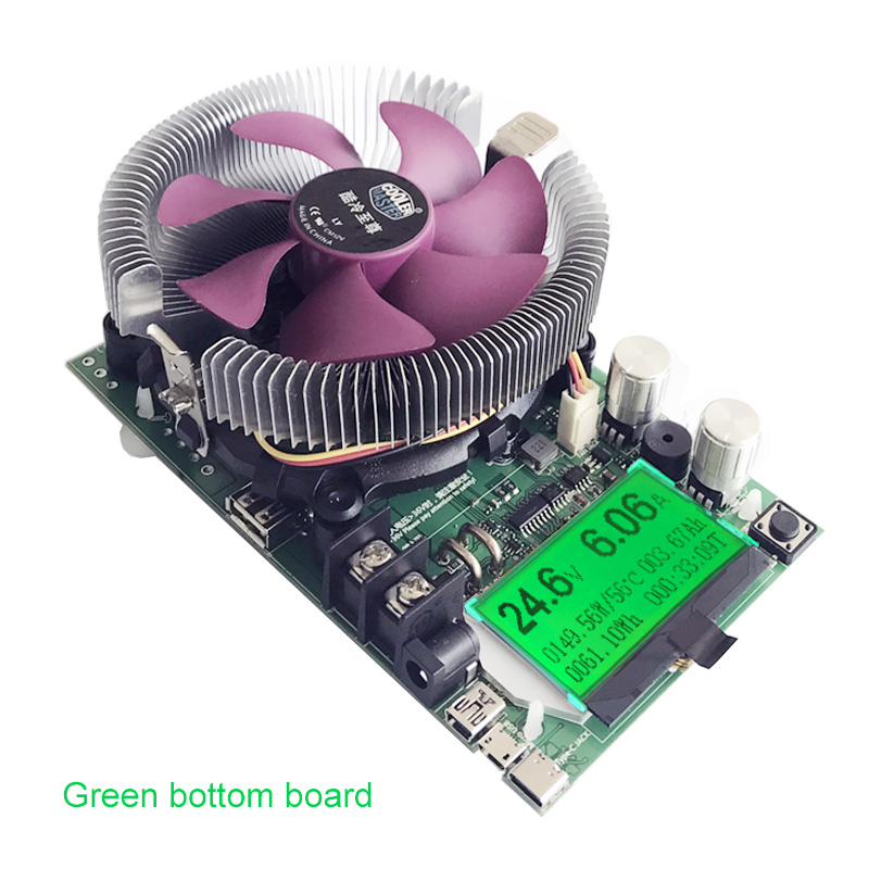

Started working on the NCR18650A's I received. Quite a bunch of them were at 4.0V, so had to do some discharging.
While doing that, I realized the voltage sag on these cells might bring me into trouble.
I am building a 14s4p pack, that will be used for my commute. It will average at 6A = 1.5A/cell = 0.5C
At 0.5C the sag is from 4.0V to 3.3V, which seems huge to me?
During acceleration the pack will see 12-15A, so up to 1.25C.
At 1.25C the sag is from 4.0V to 3.10V.
Since the lowest LVC I can set is 3.0V, I am afraid the pack will hit LVC after only a short ride and hitting full throttle to accelerate somewhere :shock:
Looks like for a 4p pack I should have gone for real high power cells.

Was your NCR18650A's unwelded cells or new?
If unwelded they could be somewhat used and the sag you are seeing is from increased internal resistance from the ageing process.
Maximum drop at 1.5A should be 0.1V at good cells.
Are you performing the voltage drop test properly?
If you do it wrongly you measure the drop across your connections and not the battery terminals.

Unwelded, but should be unused.
All of the ones that were at 4.0V are sagging to 3.4-5-ish at 1.5A. So it's consistent, not 1 or 2 bad cells.
I'm using this: https://www.aliexpress.com/item/ATORCH- ... 77897.html

I'm sorry to tell you that this way of measuring could give faulthy results.
I'm sure the amp load is correctly but this unit does not measure the cell voltage at the terminals.
It measures all sag through intermittent connections depending on battery holder spring pressure including the wire losses.
You must get a good digital voltmeter and separately apply the test probes directly onto the cell endings to measure the sag at load.
I recommend a Fluke voltmeter (you could borrow one, as they are quite expensive).
Regarding your cells it sounds like they have been used as they came charged to 4V.
All new cells I have bought so far have been charged to 3.6V factory default.

No worries, I'm actually happy because it means the sag is much less than I was seeing.
I have a voltmeter and I checked if the voltage of the decharger aligns with the volt meter, which it does.
But only in passive state. When discharging, the sag displayed on the decharging device is incorrect.
Will do some more testing after fully charing cells, but looks like I was making a n00b mistake :D

So what was the correctly measured sag after full charge?
Re: CHEAP NEW ORYGINAL CELLS LI-ION 18650 FROM 1,09$ 2200-3500mAh!
Posted: Apr 30 2018 12:15pm
by opperpanter
4.10V @ 1.5A/0.5C sags only 0.1V.

Wow, that's a great improvement from your earlier results.
0.1V @ 1.5A load is perfectly in line with expected results on good cells.
How to take a measurement makes all the difference 😊
