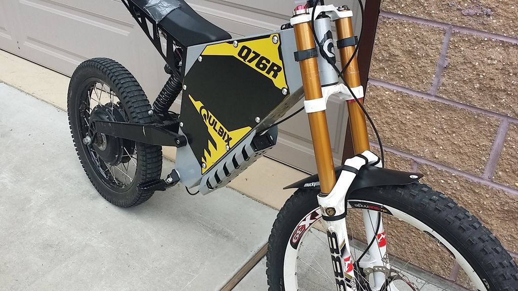

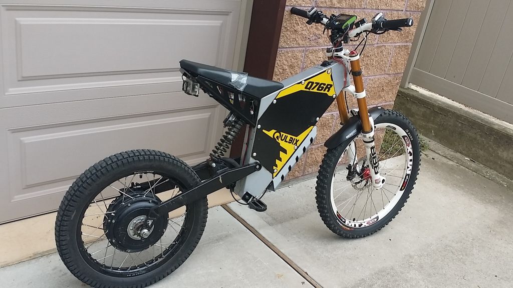

Just installed the footpeg option from Qulbix today and went for a ride.
I really like the footpegs, especially since I never pedal the bike anyway. Offroad riding is much better, it seems like I have more control of the bike, even things like making tight turns. Just everything seems easier to do, much better for aggressive offroad riding.
It is really nice not having to deal with the chain and rear derailleur! I just cracked and destroyed my Zee derailleur the last time I took my bike out after hitting it on something. It also seems without the chain the rear suspension works better, which makes sense since the derailleur and chain are adding extra unsprung weight to the rear.
Impacting things or jumping is less stressful on your knees, hopping over a large log is much easier. Just jump off your bed with your legs spread apart like they are on pedals, much more stressful on your knees than having them together.
Overall, just a better riding experience. This is the reason why all motorbikes use footpegs because pedals suck, unless you actually don't have a motor.
Of course pedals may make your electric bike legal, so this is of course the big issue with footpegs.
The footpegs weigh in at 630 grams.

Post by Offroader » Jul 09 2017 5:51pm
smurphy wrote:Can you post some pictures of the chain setup Offroader ?
Yes I can do that, will have to find those pics and post them. because photobucket decided not to 3rd party host pics anymore, all the pics I have posted in the past do not show up anymore or I would just send you a link to that page.
Here is a pic of my bike with the Qulbix footpegs, I'll repost the other ones later.
Rix   100 GW
Posts: 6927
Joined: Mar 29 2012 11:26am
Location: Fallon NV USA
Re: Qulbix Q76R Frame Kits & Complete Bikes PRE-ORDER
Post by Rix » Jul 09 2017 5:58pm
I like how thats done using the existing Bottom bracket.
Offroader   100 MW
Posts: 2587
Joined: Sep 08 2013 9:03pm
Location: USA
Post by Offroader » Jul 09 2017 7:09pm
Rix wrote:I like how thats done using the existing Bottom bracket.
Yes, I like that better also. I can swap between pedals & footpegs fast.
Had the bike out today for a 2nd ride, the foot pegs are by far better than pedals in every way. They make everything easier. Doing tricks with the bike is also way easier.
