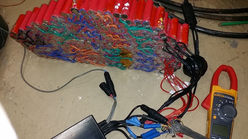

I found building my pack fun and learned a lot, but if I didn't find it fun it may be a bit tedious. It requires a decent amount of research. You will need to buy a spot welder, nickel tab, plan out the cell layout to equalize cell voltages.
For me I used the Sanyo 3500 MAH cells, these are only rated at 10 amps max. I push them at 7 amps max (about 7.5KW max for the pack) and they do slowly heat up to about 50C towards the end of my ride. These cells are really only good for high power in large packs, don't expect to use them in a small 1.5 KW pack and also push 8000 KW.
I honestly built one awesome pack for my Q76R and had to figure out how to evenly distribute the current path in a pack that was not square, my pack is rounded to fit inside the Q76R. I actually used 16 gauge wire to put my cells in series, because it would require lots of nickel tabs to get the same current as a copper wire and the wire also allowed for equal current resistance through the pack. My pack has close to perfect current resistance through it and that may be one of the reasons all the cells stay perfectly balanced.
This pack took a ridiculous amount of time to build. But I wanted a 3KW pack in the thinnest bike frame you could buy and it was well worth it.

Dam that photo shows as you said a lot of work. Looks like it should be on a pedestal in a modern art gallery.
For the new 2017 Q76R frame i think the maximum safe amount of cells is 280. I alu. welded a frame that fits like a glove into the frame, and keeps my cells safely away from the sharp nuts to fix the sidepanels.
Qulbix Q76R QS205 Sabvoton 72150, Qulbix Q76R, QS205 Max-E. Bafang BBSHD. 14S6P GA pack. Zero DSR 2016.
