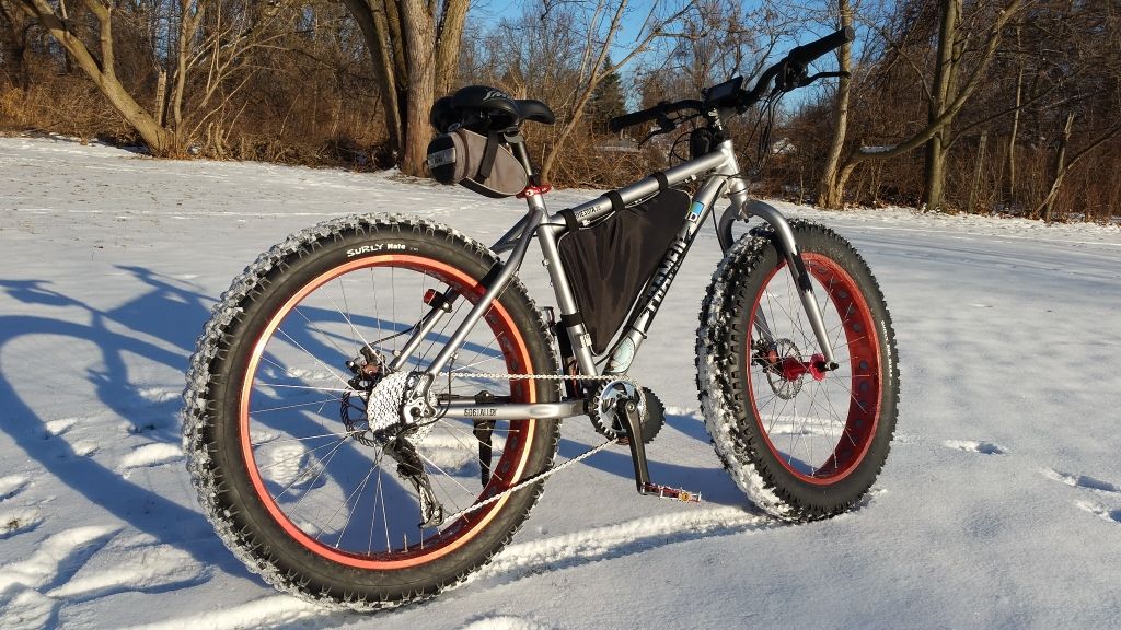

Still waiting on my Red Eclipse 42t...I ride mostly single track so when I seen this 30t Luna Eclipse I knew it would make my bike so much safer and usable in the tight up hill's! Seems to fit my Framed perfectly.Image
*Framed Minnesota 2.0 Fat Bike w/ Luna Cycle BBSHD 52v 1000w mid-drive, red LUNA 42T bling ring, Surly Bud/Nate, Scram X5 9 speed

That's ok, I will be busy using this 30t. So glad to lose the stock bafang 46T anchor :-)
