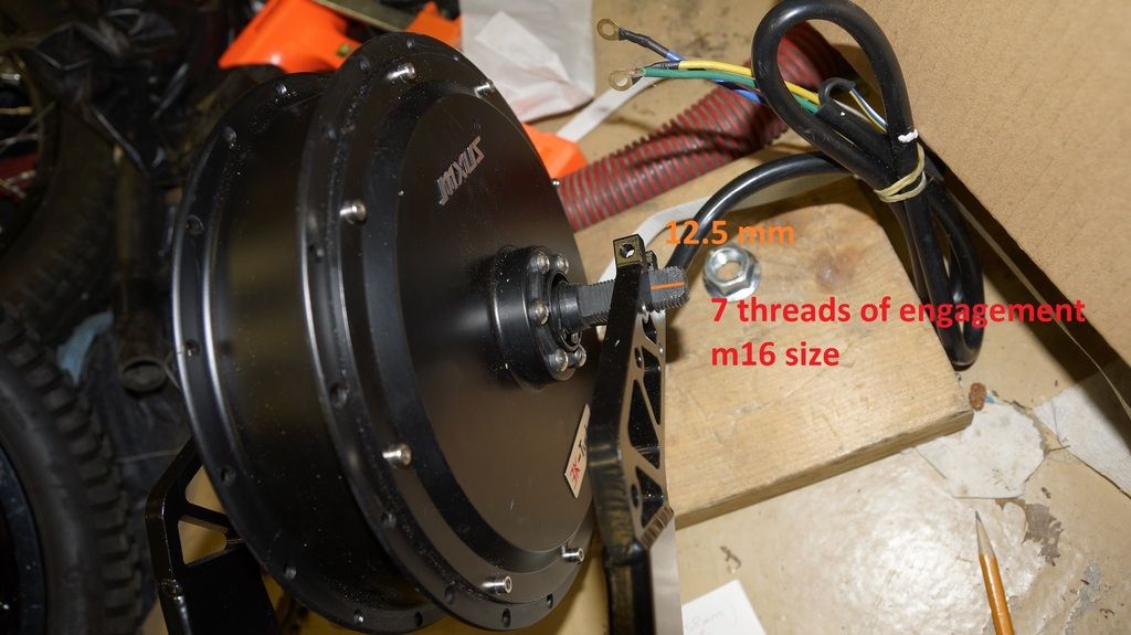

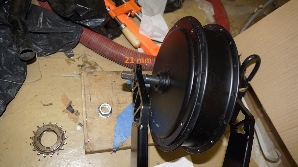

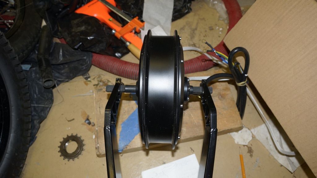

Got my hands on a Mxus Turbo. Did some measurement.
This is in a 165 mm dropouts and perfectly centered to within 1 mm of the center of the spoke flange.
This gives me 21 mm of axle space on the freewheel side.
It gives me only 12.5 mm of axle space on the disk brake rotor side, or 7 threads of engagement.
Do you think 12.5 mm or 7 threads of engagement are enough to hold it secure on that side? Remember, most of the threads are cut off.

Because these are clamping drop-outs, I suspect you will be fine.

The first two threads aren't properly formed, so really you have 5 threads (and m16 nut is 14mm+ thick) and considering the partially threaded nature of the axle its threads will almost certainly fail before the ones in the nut. However, what spinning magnets said
Clamping dropouts don't need nuts

I actually didn't count the last couple of threads, so it was a conservative 7 threads. What I could do is offset the tire maybe 2mm to get maybe 2 more threads, and that would make it a little better.
I think if you compress your dropout width then it wouldn't grab the axle spacers at an angle. Not sure if that would be good, but it would probably work.

How about a nut both sides of to get lots of extra contact area with the frame and might need less nm.
If I was desperate and knew the hub was only ever for a 165mm frame I might tack weld the nut on the end and use a nut on the inner side to lock the wheel.
My slim axle always eats into the frame on the side with no torque arm. It must twist slightly. My 16mm axle mxus will hopefully not do this

Re: MXUS 3K Turbo (V3) 45mm Direct Drive Hub Motor
forget to squeeze the dropouts.
if you do it, you never get your calipers parallel to your disc.
2mm and you can fight hours to make your brake not scratching the disc.
found that out really late. just fuckin 2mm spacers added to my dropout and after some minutes the brake runs without scratiching.

Does anyone know why the MXUS does not center in dropouts if the axle is centered? Is this done on purpose maybe to give more room on the freewheel side for gears?
I believe most hub motors are not centered when the axle is centered.
Probably is like regular bike hubs, offset to clear freewheel cluster.
