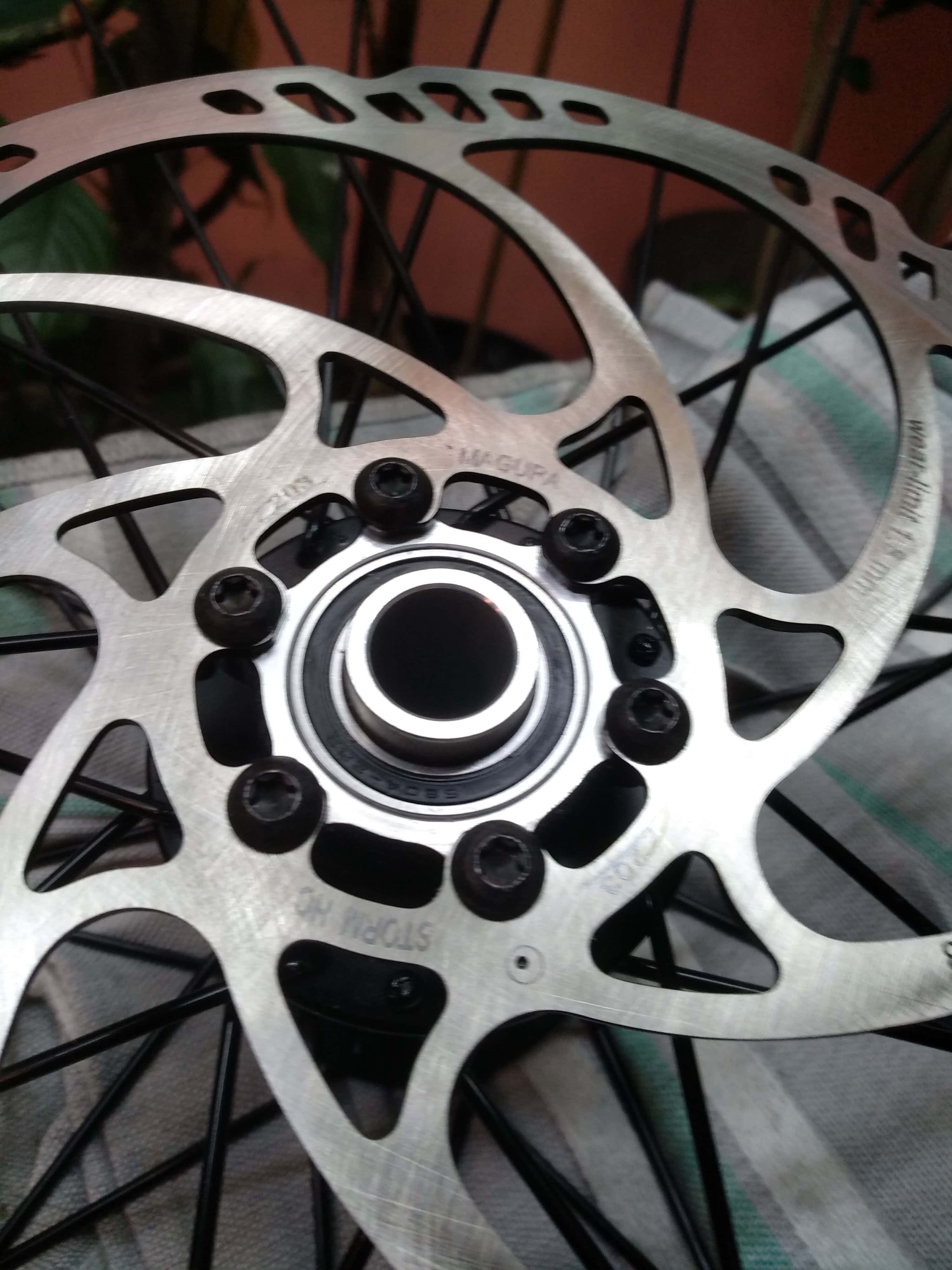

I managed to figure out what the problem was, so it's probably worth it to post the solution here as it is possible someone else in future may unbox an M600 bike and have a problematic assembly with the same problem. The picture below shows the right side.
The axel tube was not sticking out far enough on the left side. Using an assortment of nuts, bolts and washers, I had to push the axel tube from the right side to the left side. Then, with another assortment to make up a DIY bearing press, I had to press the bearing in on the right side so that the spacer would seat. Now I can get the wheel onto the fork.
Here is how to tell if you may have this problem. In the picture below, this is the right side. Notice how the axel tube is pushed out and extrudes about 4mm past the bearing race. That is backwards to how it is supposed to be. The axel tube should be sticking out the other side (left) by 4mm, and the bearing on the right side should be recessed by 4mm so that the right side spacer can seat into it. When the bearing is sticking out like in this picture, your cannot press the bearing back into the axel tube (I tried with a home made bearing press and I'm lucky I didn't break something). The axel tube is obviously machined so it stops the bearing.
I got the impression from Frey they tested the bike before shipping. But could not have, because there would be no way they would have got the front wheel onto the bike like this, and axel tubes don't just slide around during shipping. Yeah, so happy to have spent 6 hours just trying to mount my front wheel. Have yet to power it up, hopefully no more surprises.

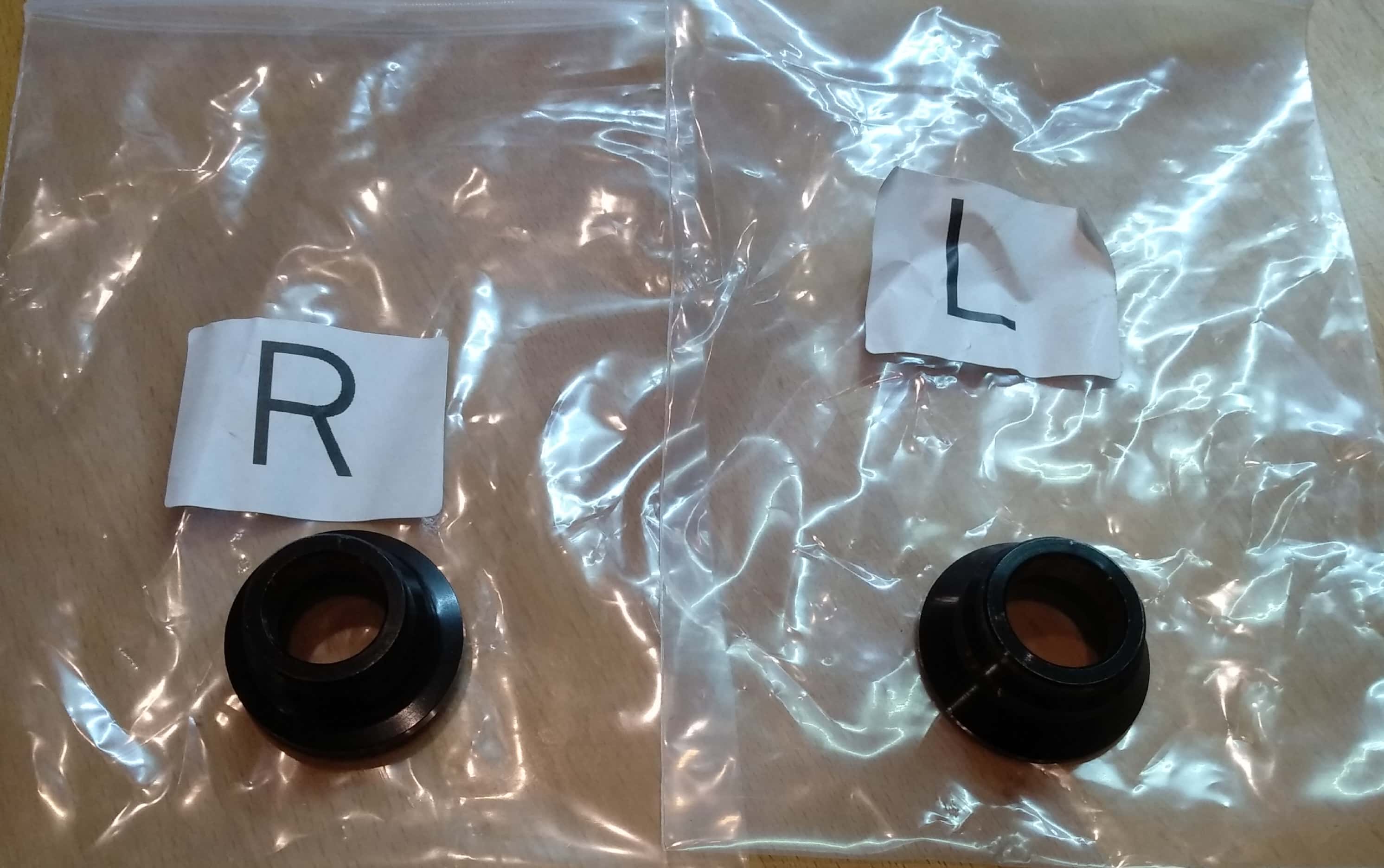

Hi John,
all the components are in standard specs and dimension. at beginning we put on the 2 spacer on the hub not removed, but some customer missed or dropped the spacer when they put on the wheel, that's the reason we removed and put in the carton instead of leave them on hub.
L is for left side and R for right side, they should fit just well if you put them in right position.
Hope you have figured it out and build up the bike well.

Thanks, but I think you missed the explanation of what the problem was: IE, they did NOT fit because the axel tube was not positioned properly when sent from the factory.they should fit just well if you put them in right position.
Just some friendly advice for your production or testing team. It took me 6 hours to get my front wheel on. I did not have a bearing press tool so I had to make one from nuts, bolts and washers. The axel tube was not sticking out far enough on the left side. I had to push the axel tube from the right side to the left side. Then, with another assortment to make up a DIY bearing press, I had to press the bearing in on the right side so that the spacer would seat.
I actually sent the above picture to Frey while the staff were working (we were corresponding back and forth at the time). I think for anyone that is familiar with the spacers and how they mount on the Frey M600, the above picture makes the problem easy to spot. Unfortunately it was not spotted until my spouse noted in one of the pictures that Frey had sent me of the positioning of the spacers that the axel tube on the left side of the example picture was protruding out more than mine was. So, because I am not nearly as smart as my spouse is, I had already spent quite a few hours trying to figure out why I could not press the bearing on the right side further into the axel tube with my DIY bearing press. Once I pushed the axel tube further to the left side, I was then able to push the bearing further back into the tube so that the spacer would then seat correctly.
6 hours is a long time to try and figure out what the problem is just to get a front wheel on the bike, and I'm lucky I did not damage it. I had the impression that this bike was tested before shipment, but it could not have been tested because the front wheel could not be placed on the bike. For the sake of your business and reputation, I'd suggest that you might want to look at your assembly
and QC procedures to try and prevent this sort of mistake from happening in the future, and, if you think that errors like this might happen again, you may want to provide some assembly instructions to accompany the bike.
