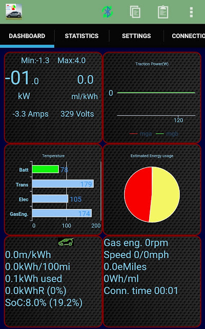

We got the Volt to cover our common case trips on battery. They're typically 20-30 miles a day, round trip, into one of the nearby towns. We might do this multiple times on some days, but frequently it's one major trip. This is mostly on 45-55mph rural roads in a grid.
We've found that the Volt gets a pretty reliable 35 miles of battery range in the warmer weather. The air conditioning doesn't really impact the range a noticeable amount for our driving. However, in the winter, the battery range is far worse - sometimes as low as 20 miles. The whole car gets far less efficient in the winter (gas cars do as well, you just don't typically notice), and the car will use a ton of energy to heat both the car and the battery pack. If you've been driving long enough, things warm up, but that takes a lot of energy - and so the gas motor turns a lot more in the winter.
Of course, you can do better in certain conditions. If you're, say, following a bunch of antique cars around at 30-35mph, without HVAC, and there's a bit of a downgrade at the start of the trip, my personal best in a Gen 1 Volt is 53.3 miles on battery.
If it's cold enough, the Volt will run the gas engine for cabin heat. The car will get some electrical energy out of this, but mostly, the goal is hot coolant to cycle to the heater core. There are hacks to bypass this behavior, but for our driving distances, we'll use the engine at some point on a town trip in the winter, so I haven't bothered bypassing it.
On battery, the Volt will get 2-3.5 mi/kWh - you can get it slightly higher, but not by much (and it typically involves descending terrain). On the gas motor, fuel economy, warmed up, on the highway... is about 33mpg. I know it's rated higher, but this is what we get on standard E10 premium with a warmed up engine, doing 75mph (in other words, refueling during a highway run). Gas miles are consistently in the 30-35mpg range for any length travel, though they're worse in the winter when the engine block is cold.
It's not great - but it's also not terrible for a good sized four door car loaded down with four people and luggage, running on pure gas. Yeah, a Prius will do better - but running purely on gas is not at all the intended use case for a Volt!

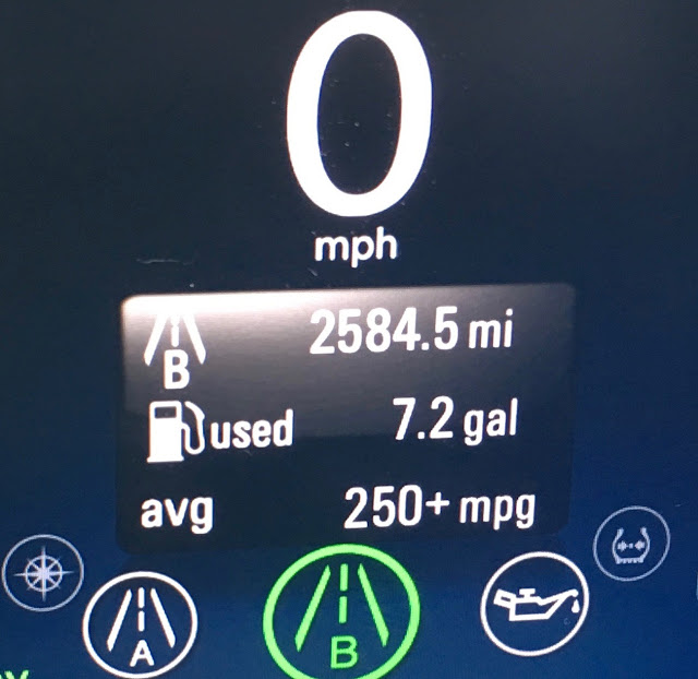

More typically, we see 300-400 miles per gallon of gas used (in the warmer weather). The gas is used for days with multiple trips into town that exceed our charging capability, and for longer round trips (some of the places we go on occasion are 50-60 miles around - that's a gas day). Even on the longer trips, though, it's rare to drop below 70-80 miles per gallon of gas used - the 35 miles on electric really help bring the total up.
