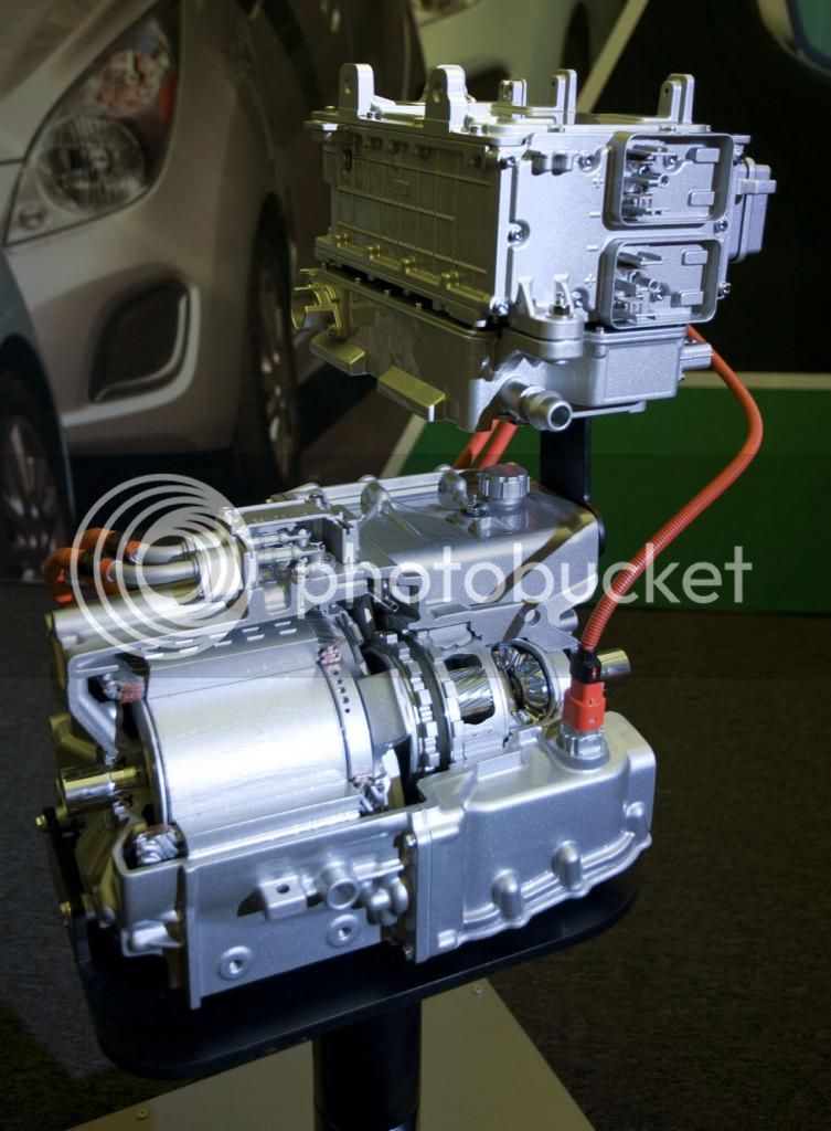

It will be nice to find a 2014 Chevy Spark 100Kw permanent magnet motor and differential in the wrecking yard. I would like to use this in a Porsche Spyder kit car. It would really simplify the build.
The Spark EV has a 0-60 mph time of just 7.6 seconds, and up to 400 pound-feet of torque on tap from its 105-kW electric motor system. It has a 21-kWh battery. One can only imagine the ride in a Spyder weighing a 1/3 of the weight of the Spark, using this motor.
Some more info:
http://www.teslamotorsclub.com/showthread.php/6557-Chevrolet-Spark-EV/page25
The Spark EV motor is designed and manufactured by GM. This motor makes 540 Nm (402 ftlbf) of Torque at stall and out to about 2000 rpm.
“The very high torque is motor performance that we are very proud of, and customers will notice the difference: (It has a gear reduction of 3.18 to 1, so the axle torque is the product of these two). This is a very low numerical reduction ratio, which has several great benefits – 1) Feels much better to drive. 3.18:1 is less than half of the reduction of all other EVs. This makes for extraordinary low driveline inertia, less than 1/5 of the driveline inertia of the Nissan Leaf and 1/4 that of the Fiat 500 EV. Their cars feel like you are driving around in second gear all day long; ours feels like fourth gear. 2) Lower gear mesh, spinning losses, and lower high speed electromagnetic losses mean very high drive unit efficiency. The Spark EV efficiency from DC current to delivered Wheel torque is 85% averaged over the city driving schedule and 92% when averaged over the highway schedule. This is the highest in the industry, and that is one of the reasons why the Spark EV sets the benchmark for most efficient car.”
Spark EV: 400 ft lbs * 3.18 gear reduction = 1272ft/lbs for 3000 pound car
Model S 60: 325 ft lbs * 9.73 gear reduction = 3162ft/lbs for 4600 pound car

NOT induction its a PMAC. On that not the leaf motors are easy to get I got one :)
That picture says 2013 Chevrolet Spark EV electric motor and shows aluminum bars in the laminated steel rotor core. That makes it an induction motor, doesn't it?
major said:
Isn't that the same motor as the first picture with the magnets in it?
Arlo1 said:
major said:
I see a difference between the first two images that bigmoose posted. Both depict a bar wound stator. The first shows an IPM rotor. The second image shows an induction motor rotor. See the difference?
Yes I did but I thought it was just different pictures of the same thing showing different amounts of info.
http://gm-volt.com/2011/05/02/remy-ev-motor-reduces-dependence-on-foreign-rare-earth-supplies/
in the above article they are talking about the same motor (i believe) and how they can 'swap' the PM rotor for an induction rotor and get the same performance and efficiency. sounds interesting to me!

Giovanni LiCalsi said:
Is there an off the shelf motor controller that can be used for Sparky or can the GM controller be used by hacking the Can bus?
I would really like to use this motor.
You can do it using this: http://store.evtv.me/proddetail.php?prod=gevcu&cat=23
Someone sent this to me today:
AC motors are a bit different. it is somewhat difficult to mix and match inverters and motors. THe motors vary in inductance, resistance, the number of poles, the means of reporting angular position, etc. And so while most inverters could run most motors in theory, in practice, inverters have to be "tuned" to each type of motor they are used with. This is termed "characterization".
So yes, the Chevy Spark motor probably only works with the Chevy Spark inverter.
Our GEVCU is designed to control such inverters using the Controller Area Network (CAN) protocol. But the message digest for each inverter is different. And so we would need some form of documentation on the CAN protocol used by GM to control the Chevy Spark inverter. We would also have to get a motor and inverter, set up a test bench and actually write an object module FOR the Spark. It's all non-trivial.
There just aren't enough Sparks on the road ot make it worthwhile yet. If it sells well, and I'm told it is a great little car but only obtainable in California, Oregon and Canada fleet sales as it is a CAFE compliance car. But as more become available if the motors and inverters become common on eBay or through other salvage channels, it might be a thing to do. But it probably isn't worth the time for one at the moment.
If you are a pretty good C++ coder and can get the documentation from GM, we can probably get you fixed up so you could do it. But reverse engineering it would be quite a task.
