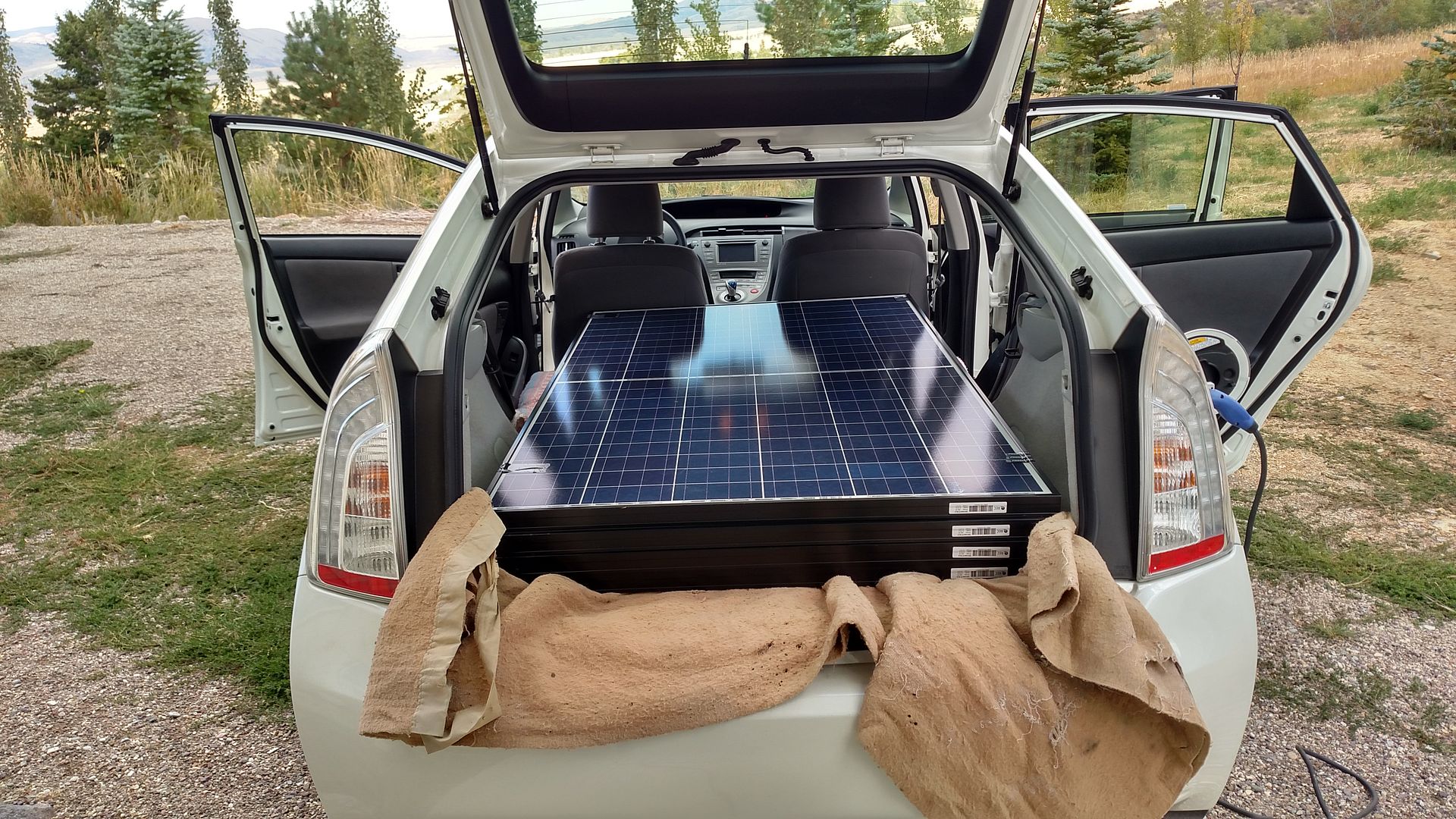

The Prius at work......hauling four 130 lb. batteries (pulling the passenger seat makes for a nice low loading height, and keeps the weight better distributed then all in the ass end), hauling an empty plastic water tank on my lightweight trailer (we had 30 MPH headwinds on the drive into town that day, you can see the weather conditions I was driving towards, I still got 48 MPG). Also, the BBSHD/Montague/Rohloff hubbed folder in it's new home. Unlike when I carry this in the airplane, it is a super easy and quick job to stick it in there, the low loading height coming in handy again. Plus the fat bike rack I built for it, I kept it as short coupled as I could, and will also use a purpose built strap that hooks into the top of the hatch in order to somewhat pre load the hitch loads: so the weight isn't just cantilevered out there and flopping around with every road bump, like I see on some bike racks. There is a removable vertical strut that you can see in the one picture, and the entire arrangement seems to be real solid with no flexing.
So, this is what has got me all excited, a super high MPG ride, with a good practical load hauling capability, while it still leaves the entire rear open for sleeping in and/or hauling more gear. It fairly screams ROAD TRIP! Once I'm "wherever", it will only be a moments work to park the car and get the bike out, with a fully charged battery of course thanks to the car's inverter. In the meantime, the inside the car bike carrying thing is proving handy as it is obviously, out of the weather and safe. If I throw an old blanket over it, no one is the wiser, it's like having a secret super power, the ability to drive up in a perfectly respectable looking and even common looking car, and then minutes later to move out on a 30+mph AND at the same time a very low geared eMTB and quickly access terrain more mortals can't, all without advertising the fact in advance I even have a bike of any kind with me, ha ha ha!
