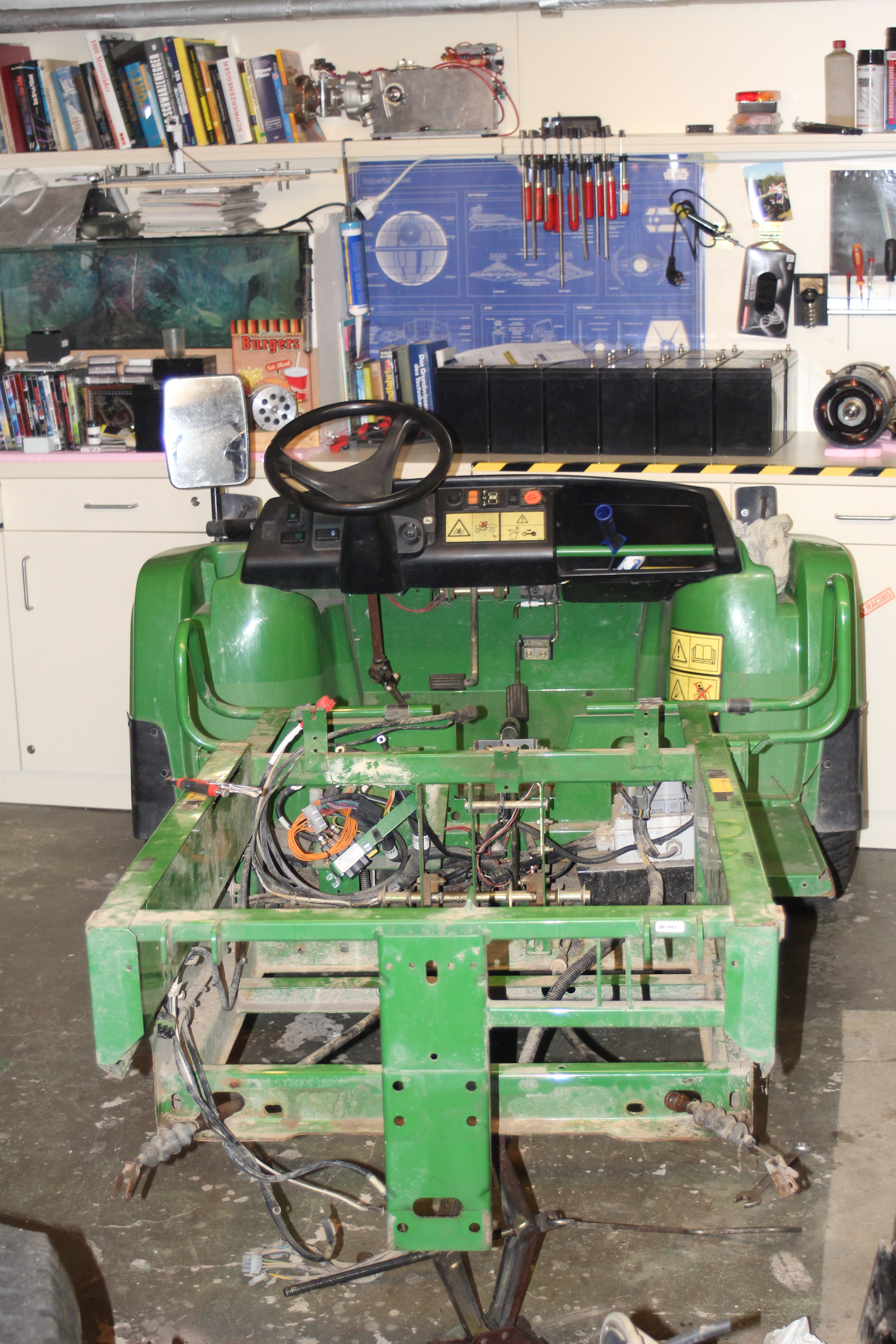

Hello to all !
This year i had the option to buy a cheap but rosty E-Gator for a few bugs .
It was lot of hard Work !
So i made lot of Photos from the rebuild . so lets start the Picture-Story .
inside the E-gator
the motor

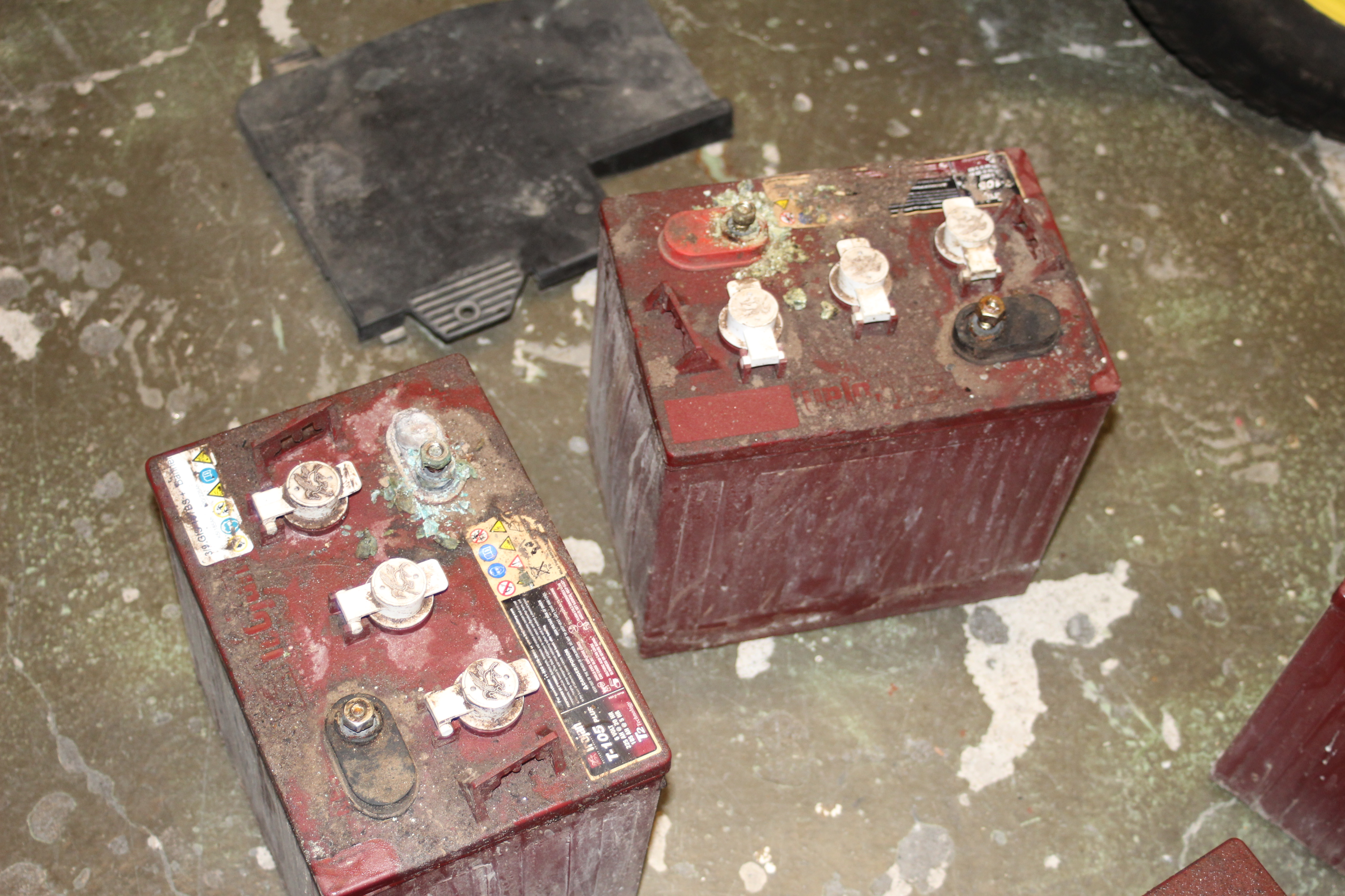

the dead Battery

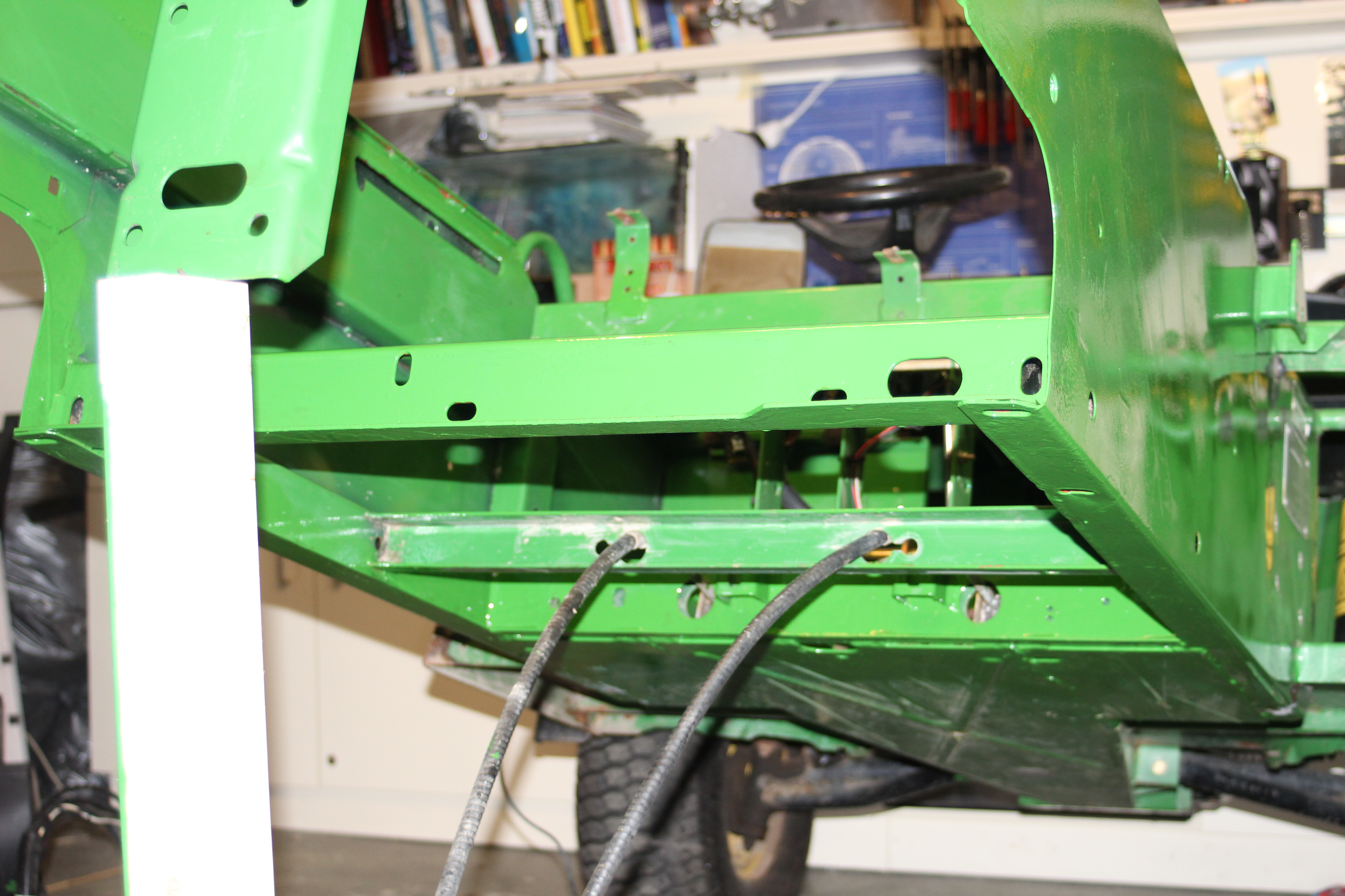

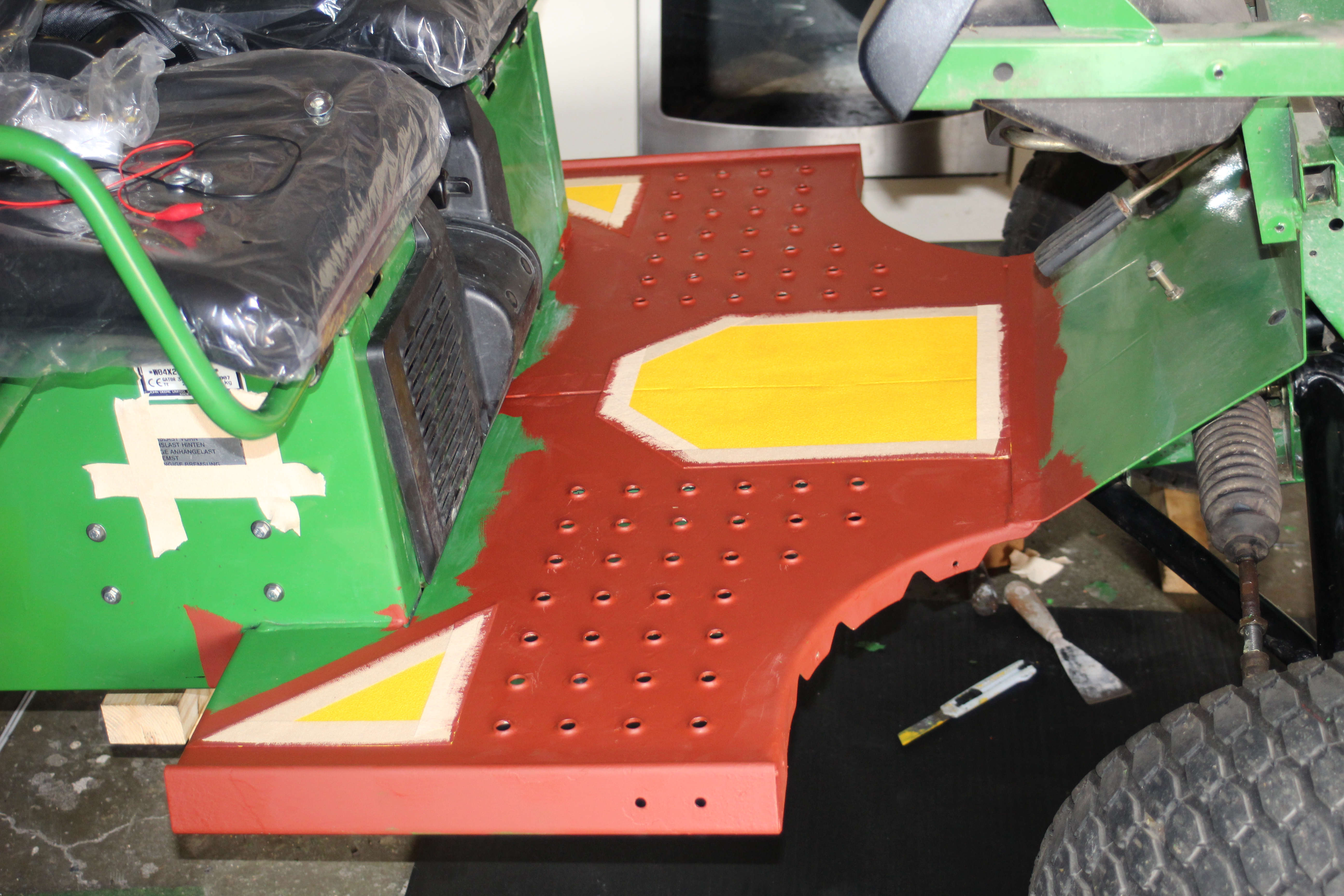

so i start work
so much dam rost everywhere !
paintwork
special paint for more grip

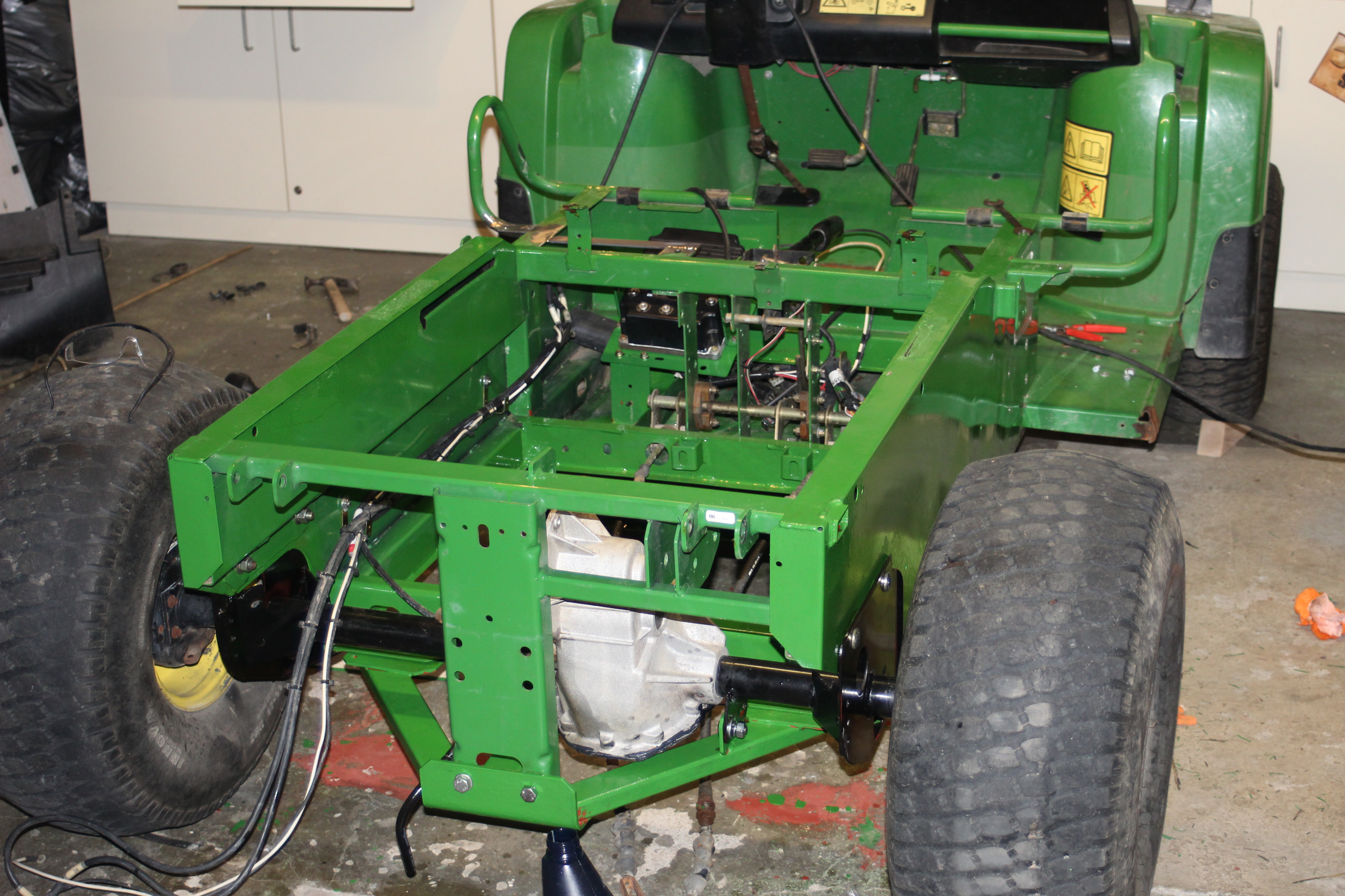

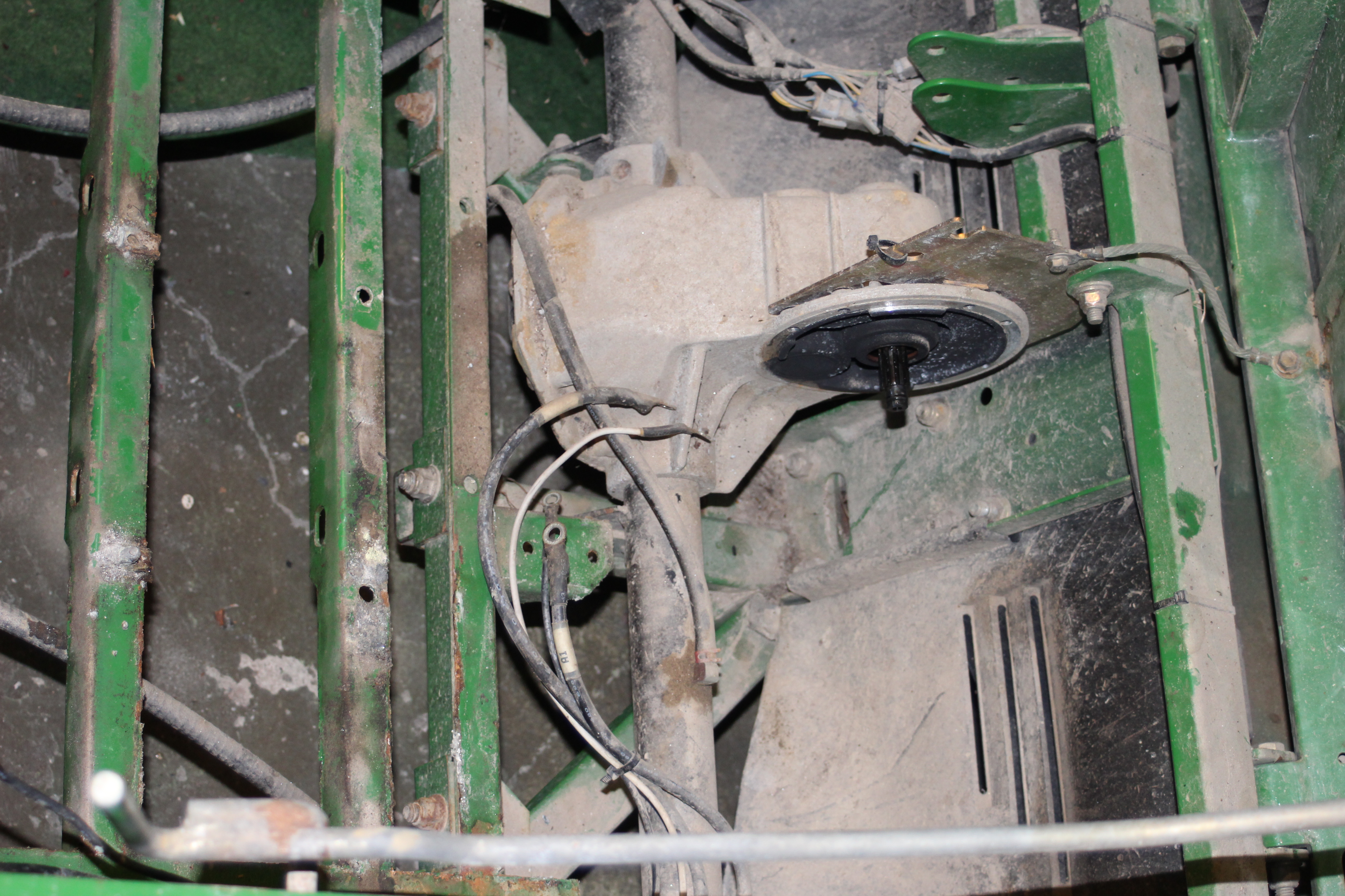

for the next step i demount the DC-Brushmotor
i also demount the axel
the rame is a real lightweight and easy to lift

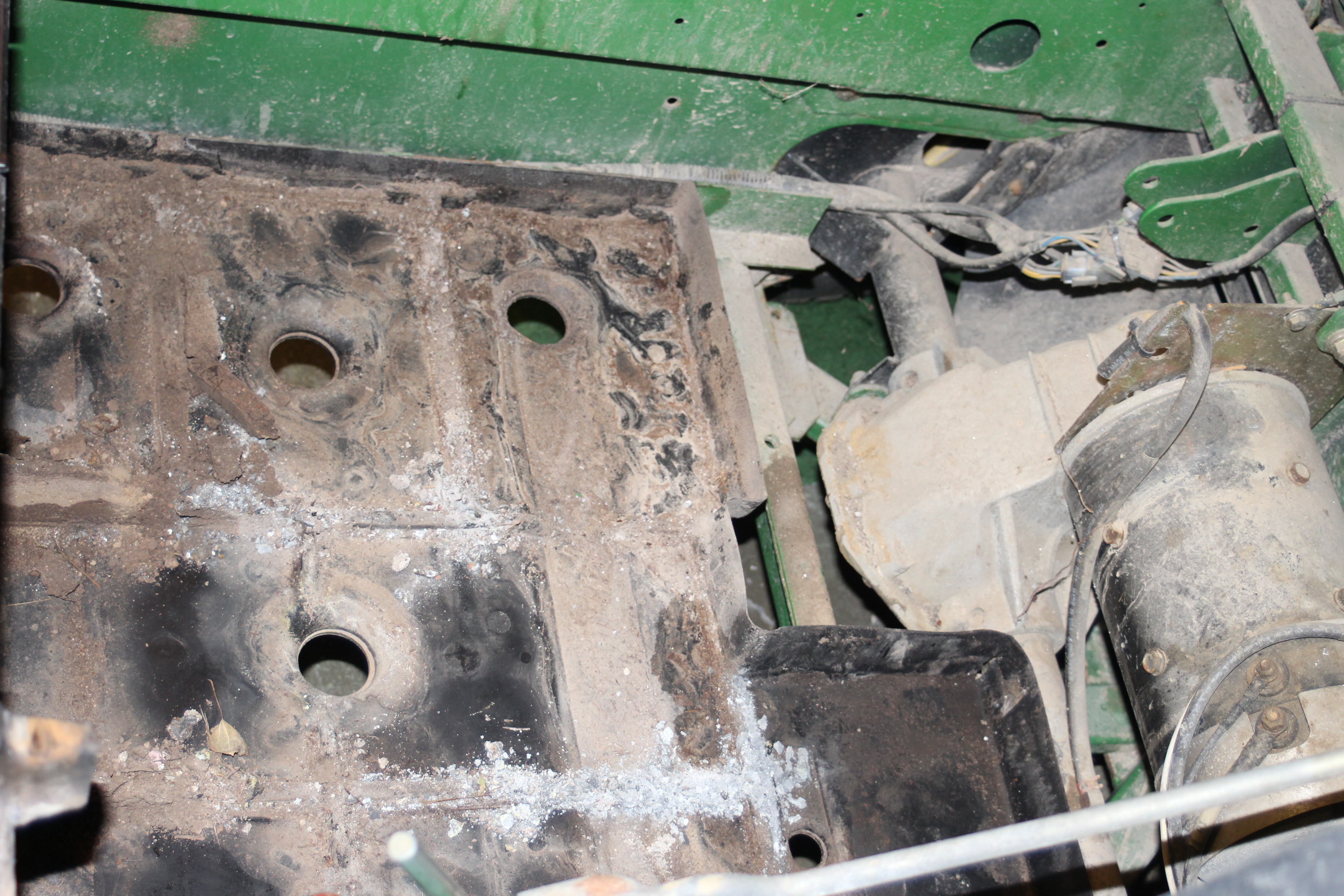

and again rost everywhere
after paintjob
so on the backside and batteryspace all rost is terminated
next step the front
again lot to paint......
................more paint

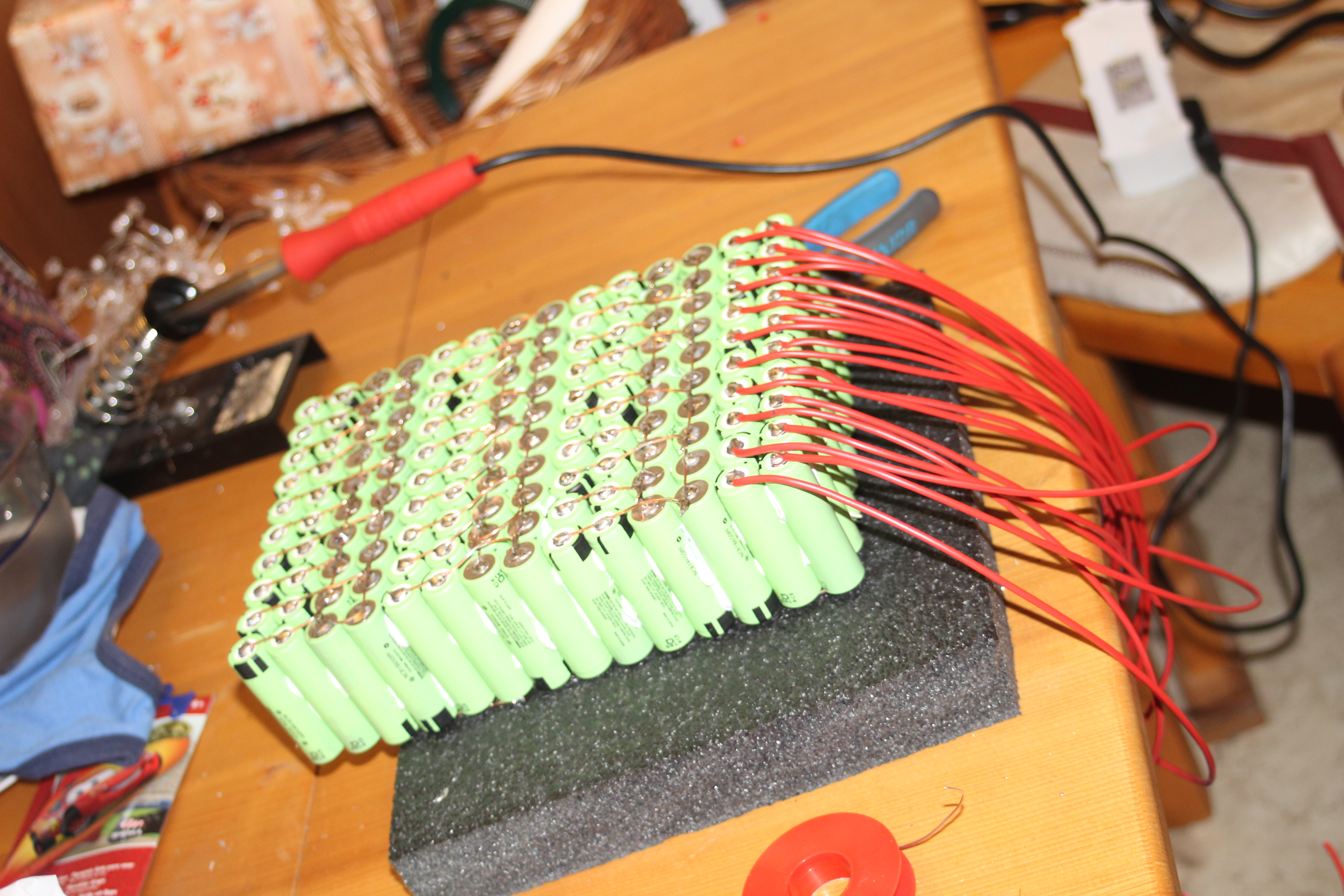

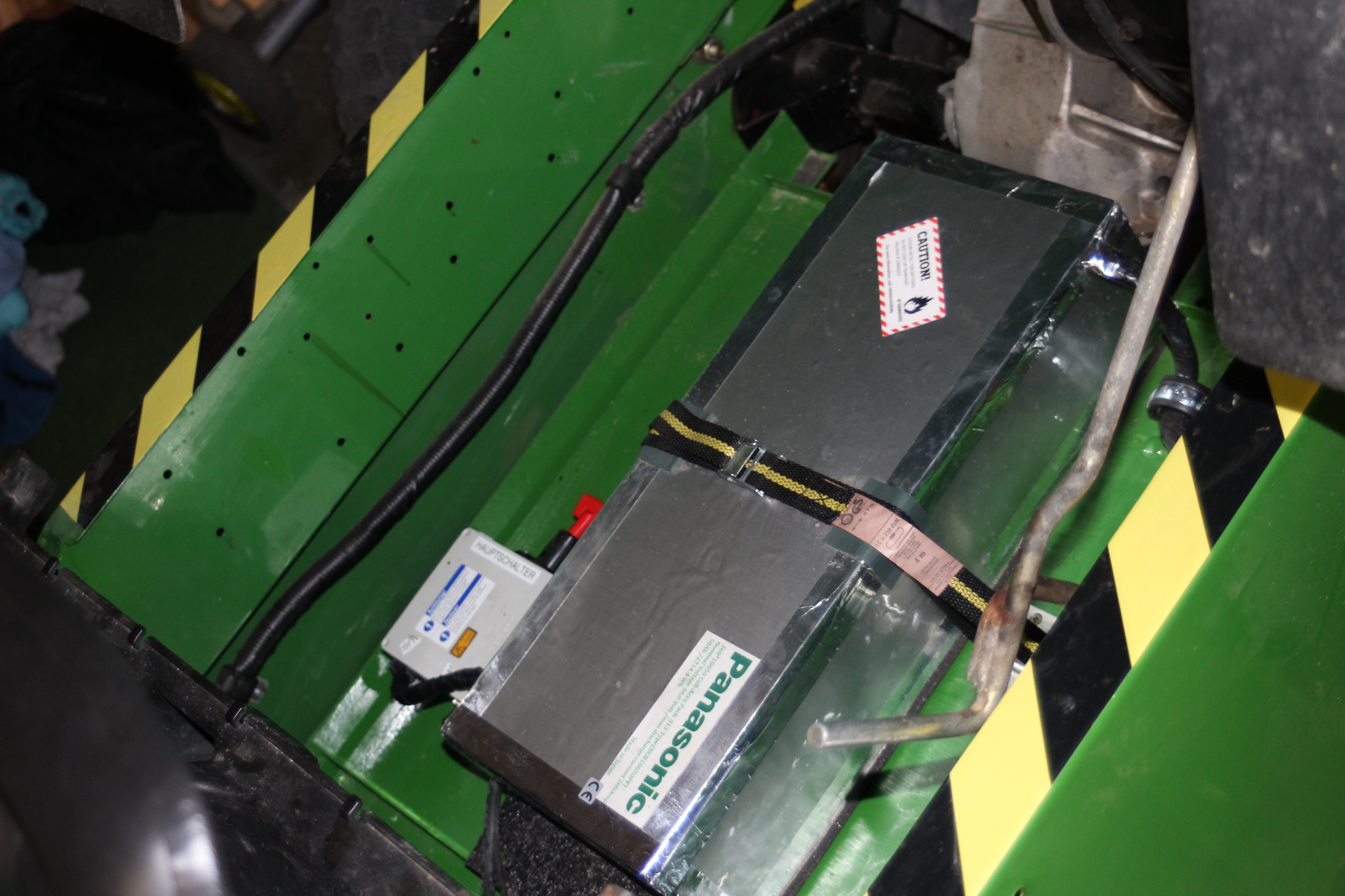

So next step was build a new Battery i am not really a fan of acid Battery so i build a new liion Battery .
Old Battery more then 200KG the new one under 30kg :-)
I buy cells and solder it !
close to fin
so i want that the Battery look like a original battery from a shop .i think it will look like a profesional Battery
i also mount a 200AMP fuse and a main switch !

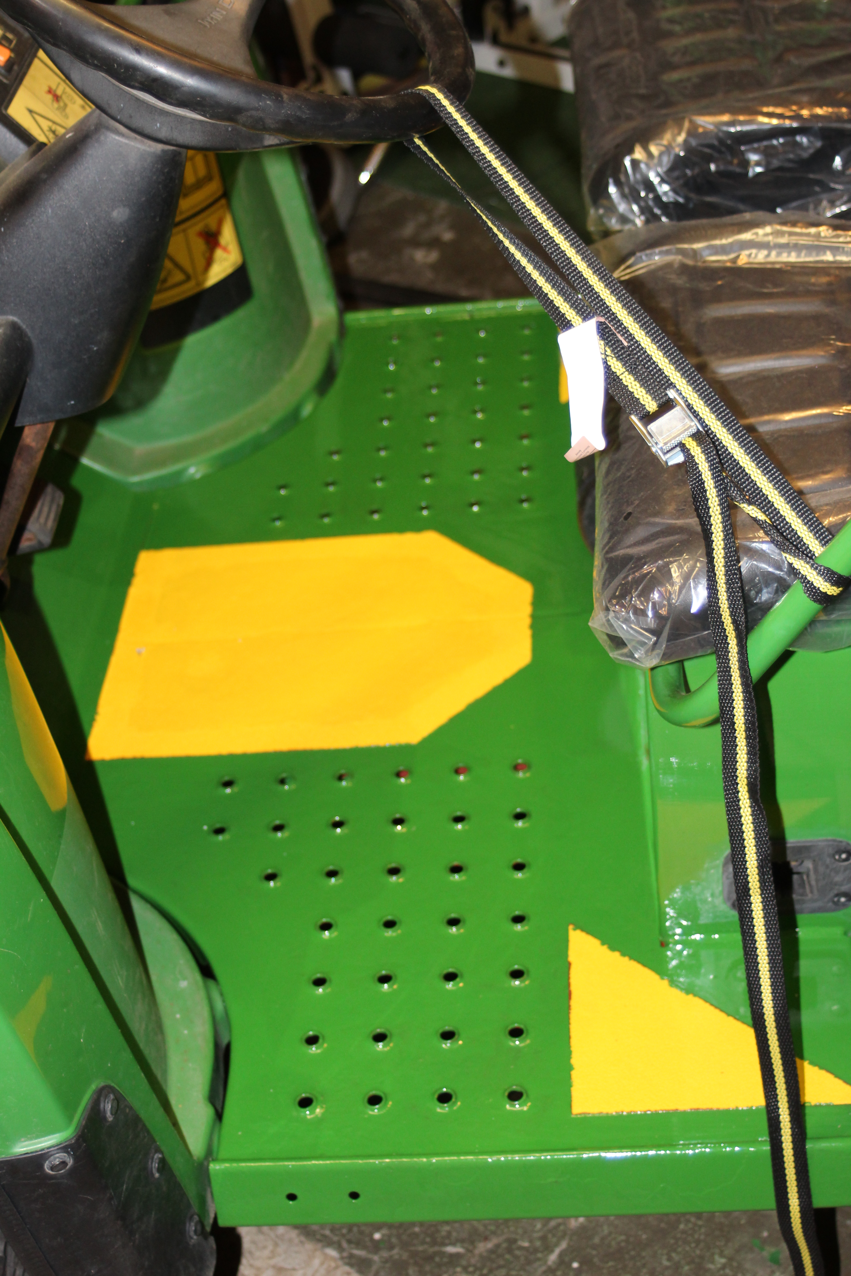

so now i show some pictures of modified the Seat-holder and i mount seat belts for safty !

work start on driver cabin so can drive it all weather .
now i mount the glas
after paintjob its look much better

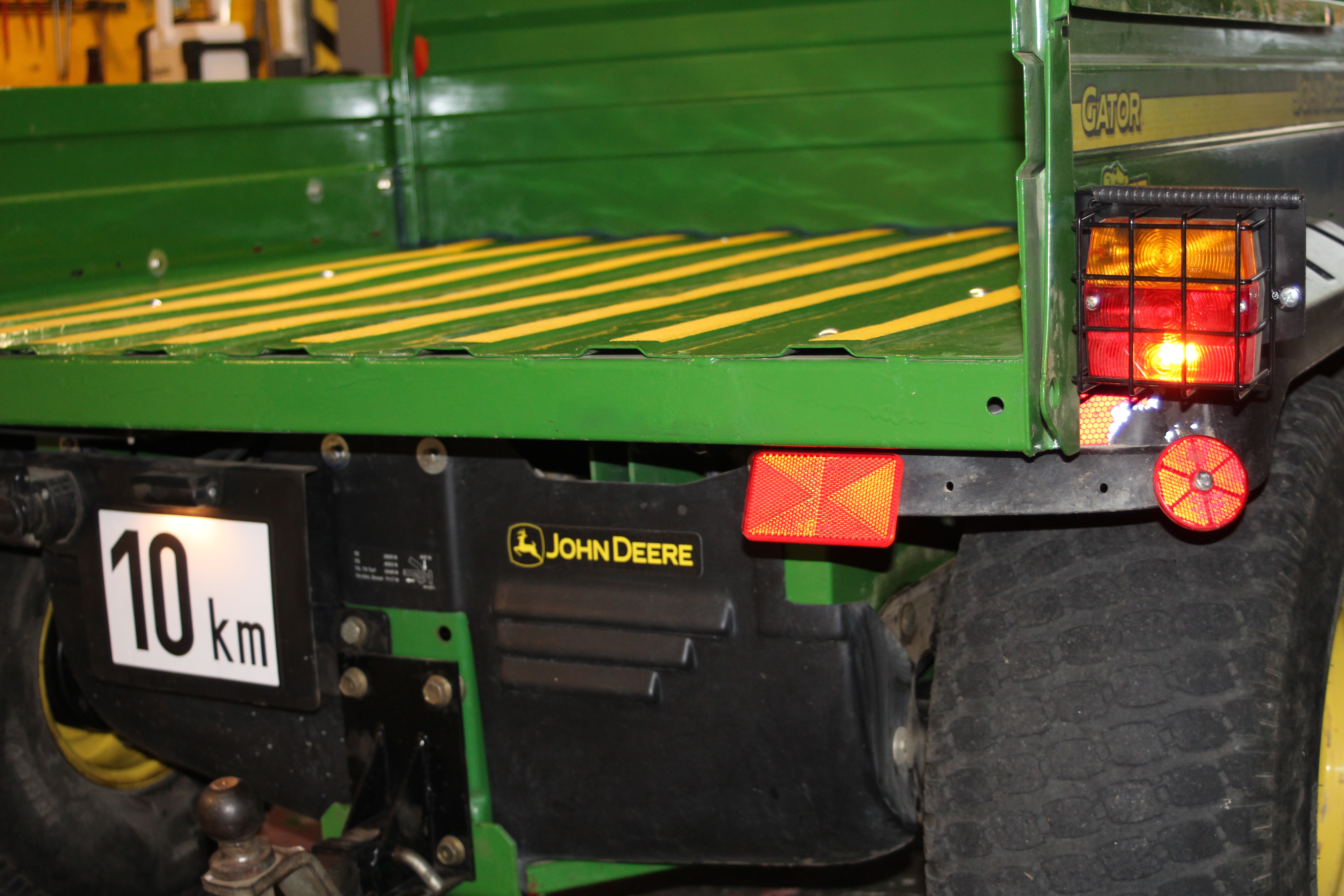

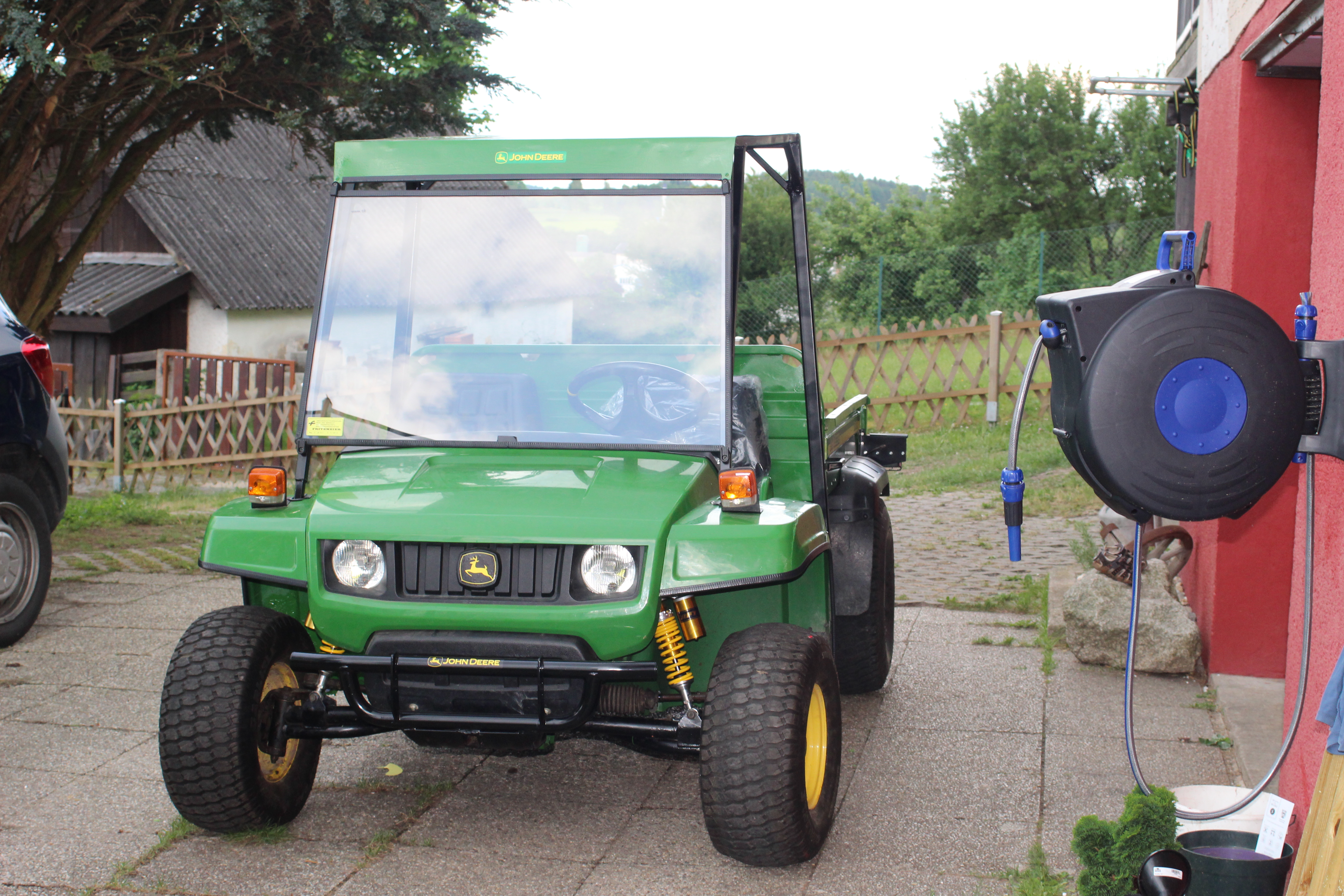

so all work is done !
so sticker are also very important feature
picture from side
frontside
backside the ATV the 10km-plate is old meantime i had a street license and it drive faster
i mount 2 lights on roof
i change the halogen against led with less Watt but more light
So thats the end of the story i am really happy with it and my little son love the E-GATOR( john green deere)
meantime also my wife love to drive it :mrgreen:

Oh yes sorry i forget the data :
the cells are old 2014-2015 but not used = (0.0 Cycle )
i buy it for around 2,50 euro- pice (260 pices)
Cell data =Panasonic NCR18650PF 3.6 V 2900 mAh (10Amp max )
i solder 13s *20 Cells so i got 46,8 Volt nominal and 58 Ah
i know that 58ah is not much but i calculate this Vehicle for a max range that i need is 10-12 km so it is fine .
the Controller does made 400A max for short time but continous it is between 100-130 Ampere .
First test drive i controll the heat of cell´s but the never get real hot ..so this DIY accu is fit perfectly .
And the fuse is a 200amp fuse so there is no Danger to the Cells .
So i made some calculatoins and the range with this accu should be around 15km .
The maximum range i drive is now is 12 kilometer and the Accudisplay is not in the red range. I can not really tell you the real range its difficult to tell .

Originally there was 8 pice acid Battery inside one had...... 6Volt -225 Ah (Trojan T-105 ) a cell had 28 Kilo so 224 Kilo .
But this Battery was all dead ! i took them to Recycling !
I know that 225 Ah acid Battery would perform longer ...but on other side they much heavier and the point of matter> the price of 8 new T-105 Battery was 1496 euro (one 187euro) the Liion Battery coast was around 700 Bugs .
Liquid Acid Battery you always must watch them fill Water in it .....
Liion you only have to watch to stay over 2,8 volt per cell :D
