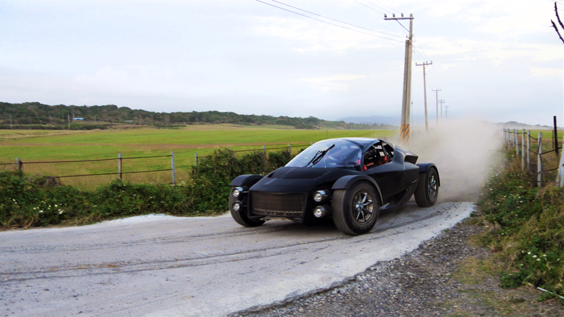

Ummm.. Started out in Victoria BC Canada, then sta
the world's first on and off road all-electric supercar: MISS R:
https://www.designboom.com/technology/xing-mobility-electric-off-road-supercar-04-13-2018/
Starts:
electric powertrain developer XING mobility released test footage of their 1,300+ horsepower, rally-inspired supercar — the world’s first electric supercar with on and off-road capabilities — MISS R. XING mobility’s vehicular-duchess was tested on a wide variety of terrains. here, it can be seen thrashing down a rough gravel path, taking full advantage of its four-wheel torque vectoring agility.
Found a YT vid:
[youtube]Np8mhUnqGkk[/youtube]
"an immersive-cooled battery pack"... 8) "four 350V motors and 1 megawatt battery pack"... 8) 8)
"0 – 100 km in 1.8 seconds. 0-200 km in 5.1." :shock: [MUMMY!]

See that enormous radiator at the front? If they are immersing the battery in Novec or equivalent fluid with a quarter of the heat capacity of water, they will need 4 times as much radiator :)
Very cool though.
Novec is pretty phenomenal in all aspect$$$, including its ability to weep right through most common fluid sealing interfaces. Quite the fluid to contain long term in complex systems, but possible to do.
