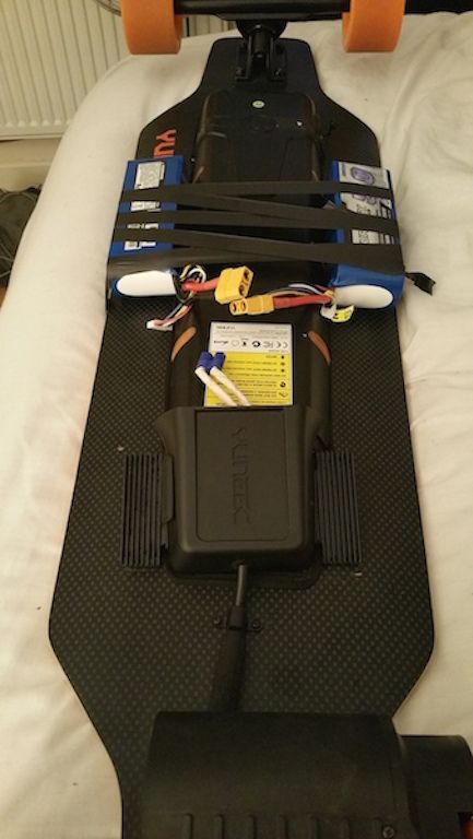

Thought i would share this with you all after reading this thread.....
as ghetto as it gets i know... but thought i would try my E-go on 10s today....
As we all know it's way underpowered and as far as i know, nobody actually knows what voltage the ESC will take without burning up...
as i find it that boring to ride now i don't even use it!!
so i thought i would be the guinea pig and give 10s a go
2 x 5s in series
max speed 19mph
hill climbing power is ridiculous compared to the standard pack
silly fast acceleration (i had to flick it over to ECO to tame it down a bit)
After 3 miles of stop starting to check temps, the ESC & Motor were no warmer than with the standard 7s battery
How long the ESC & Motor would last i don't know! (not very long i suppose)
I Don't think 10s is something i would run permanently but im definitely going to try an 8s setup and see what happens :roll:

if you are take some photos of the pcbs i can check the components for which voltage they are rated.

Ive been out again tonight and done another 6 mile ride on 10s... ESC was lukewarm at best!
The motor was warm, but no more so than when using the original pack

Do you know What sort of motor could be used and wired with the original ESC?
The ESC seems to be performing ok on 10s... a motor upgrade would make it the perfect board for me

Does anyone know what the red and white plug is for that connects from the ESC to the original battery pack?
I've just been out again but was getting some motor pulsing at full throttle under load, what causes that ?
I was going to sell it ....but if the motor can be upgraded and i can keep the ESC/Receiver and controller, i will definitely be keeping it :D

That's a JST connector for monitoring battery temperatures.

Post by jakeyb2525 » Oct 13 2015 7:44pm
Thanks...i've emailed Bruno at AD to see if he can sort me out a 9 pin upgrade motor, Happy days if he can,it could end up being a half decent board for the money!
erwincoumans   100 W
Posts: 141
Joined: Apr 02 2015 11:25pm
Re: E-GO by Yuneec Internationl
Post by erwincoumans » Oct 13 2015 9:07pm
Pediglide wrote:@jakeyb, this is actually very interesting to me. I've got a lot of people asking whether they can swap their E-go motor with my hub. I told them I dont know because I dont have an E-go. Now thinking of buying one, doing your mod and swapping the motor. Cool thing is that the wheels are already 90mm.
I still have your dual hub motors here (they work fine with my custom patch). I could hook up a single motor to the original e-Go ESC, if I find some time.
I've used the hub motor with dual VESC on the E-go with original battery, works fine.
LEVer   10 kW
Posts: 719
Joined: Nov 07 2012 3:29am
Location: SoCal
Post by LEVer » Oct 13 2015 9:54pm
That's cool Erwin! Yeah, that will great. Really interesting about modding an E-go with dual hub motors and VESC. That's like less than a Boosted Dual plus and you get great range.
xshana414   100 µW
100 µW
Posts: 7
Joined: Oct 14 2015 3:45pm
Post by xshana414 » Oct 14 2015 3:49pm
Erwin, I'm looking into modding my E-Go to make it go faster and I'm still relatively new to the whole e-board scene. If I bought: http://www.amazon.com/Generic-Electric- ... B00WQP5P48 and attached it to my E-GO, would it work? Thanks!
