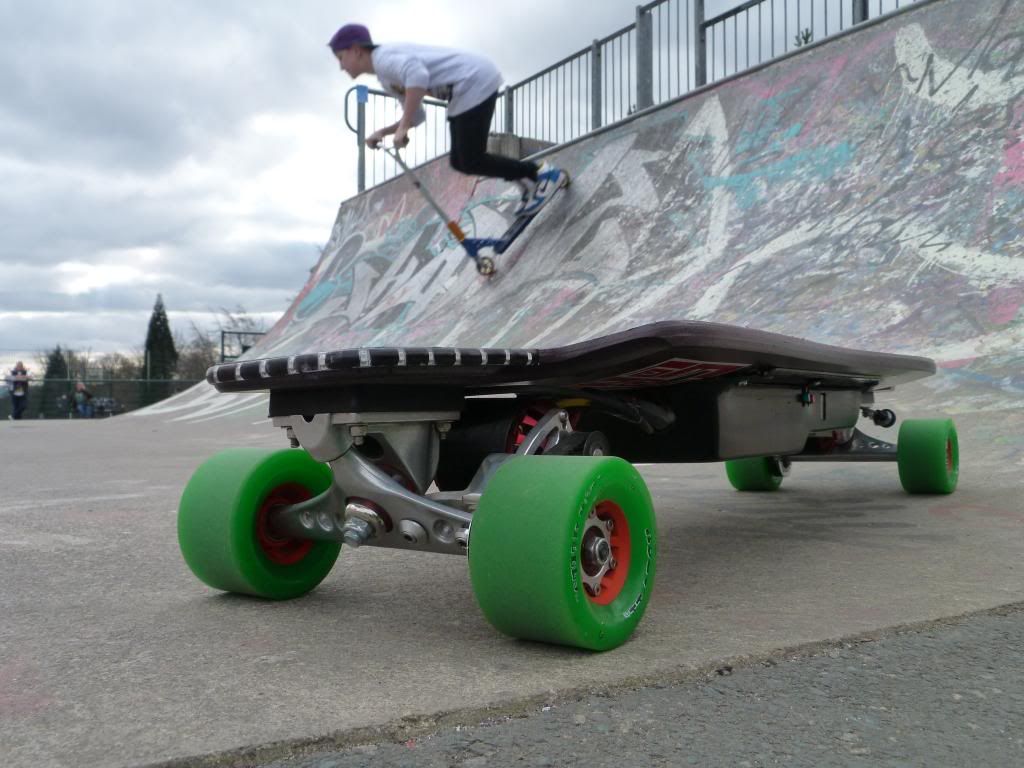

Hi I got the motors from Bruno at Alien power system . We're very near being able to offer an Electromechanical kit to fit to any longboard deck.. This will included the Motors,custom Dual ESC( controller),Wii Nunchuk controller or iPhone controller. CNC machined 6082 Alloy ABEC 11 drive hubs, motors brackets and truck mount brackets,and hardware inc.. Belts, fasteners etc. you will need to buy Abec 11 flywheels and Holey trucks ( I may be able to get these also). I may also offer the moulded battery box and a unique Arming system I have devised. I think initially we will offer a small run of 10 kits .. So please let me know if people are interested. I'm thinking of doing a 'Black edition' possibly with black anodised brackets and powder coated satin black trucks. :D
Texonite   10 mW
Posts: 24
Joined: Jun 11 2012 5:04pm
Re: Brushless dual 6kw ALIEN Power system - electric longboa
Post by Texonite » Feb 28 2013 6:18pm
That are great numbers you're talking about!
At ~10kg and about an hour of assured runtime it makes decent commuting vechicle.
Care to elaborate more on weight? What do you expect from new deck?

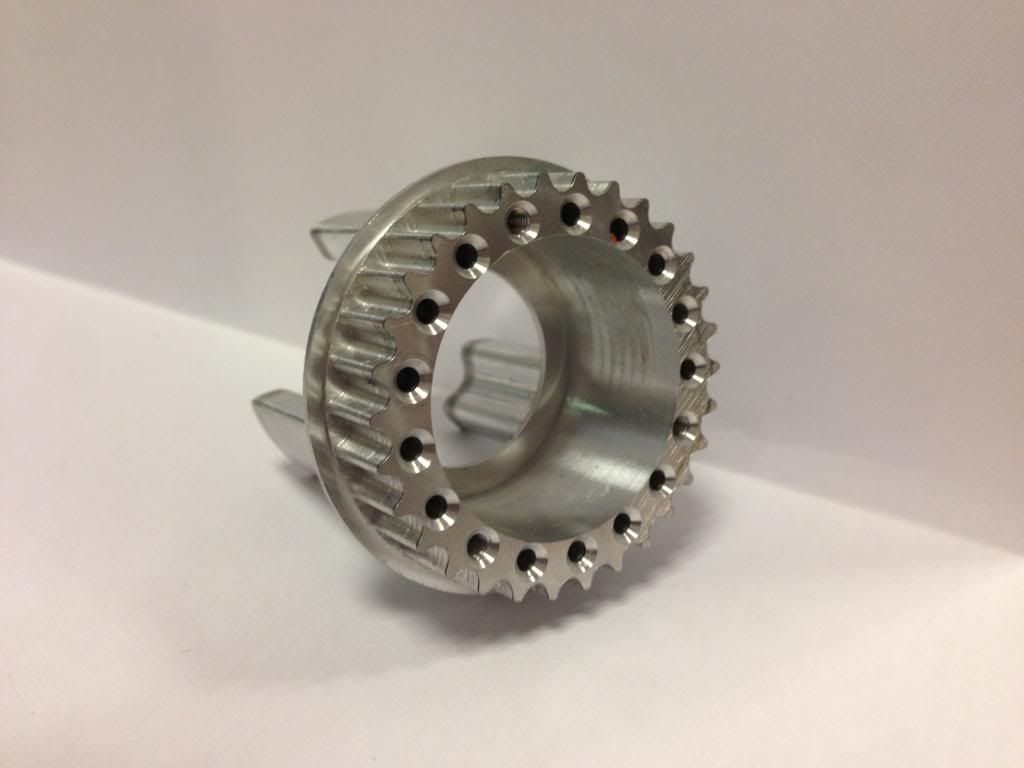

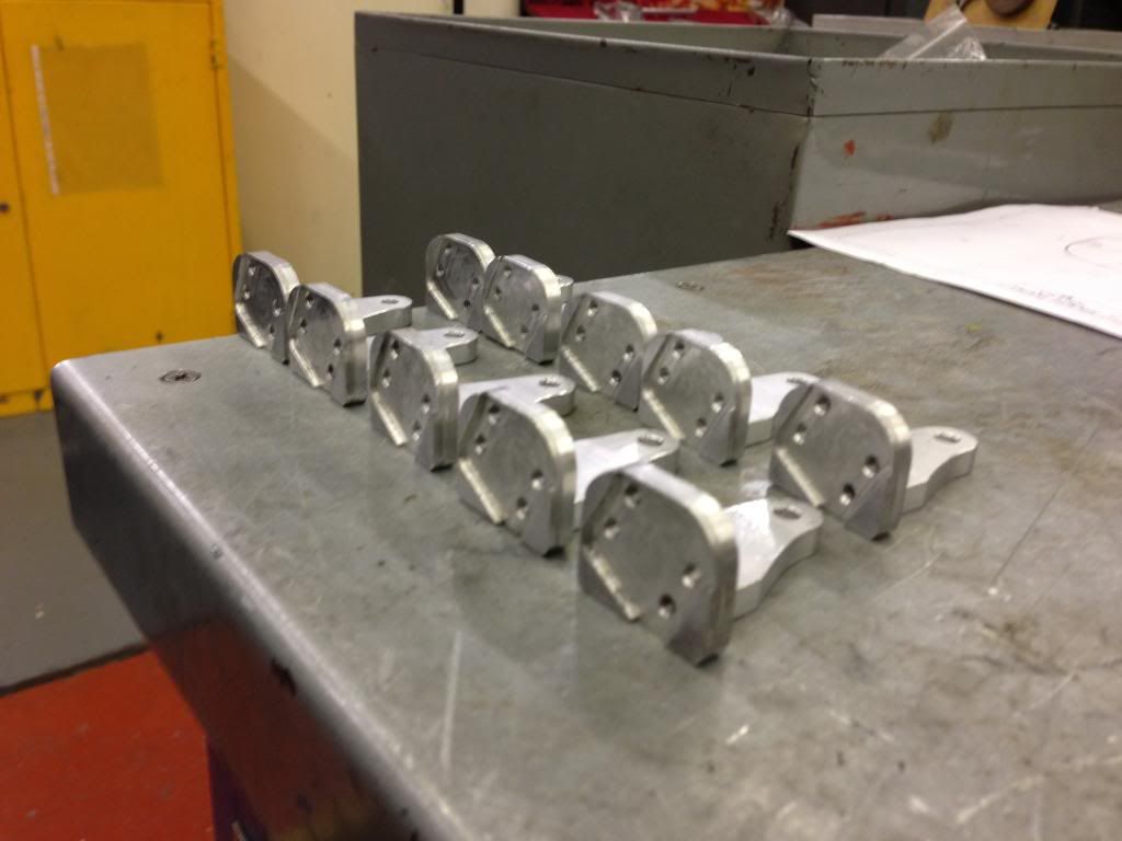

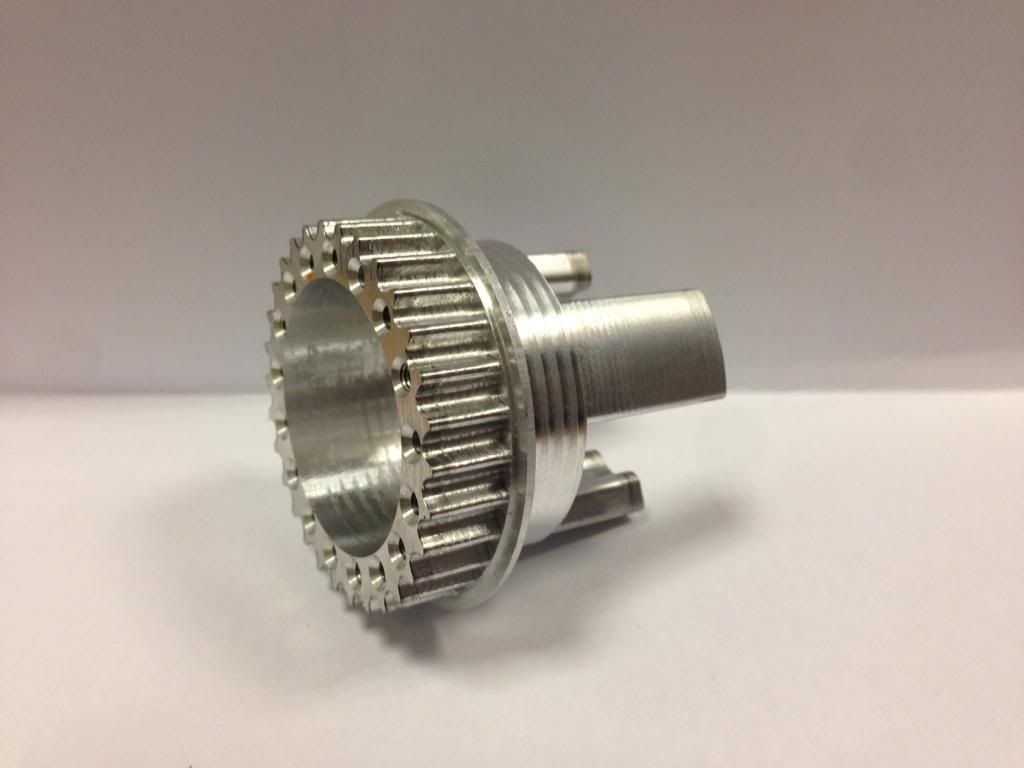

Ive been asked by several member about producing a kit of my project and i can now offer it.
This will be what you get in a kit for the Holey/Abec 11 conversion all CNC machined and laser cut from 6082 aircraft grade alloy
either alloy
or anodized black/blue/red
I think around £139 in alloy and £149 for black for the full set inc fasteners /belts etc. Bruno will be selling the ESC,motors and Wii nunchuk controller to suit. prices to follow
also the battery box cover will be available trimmed and drilled for £25.

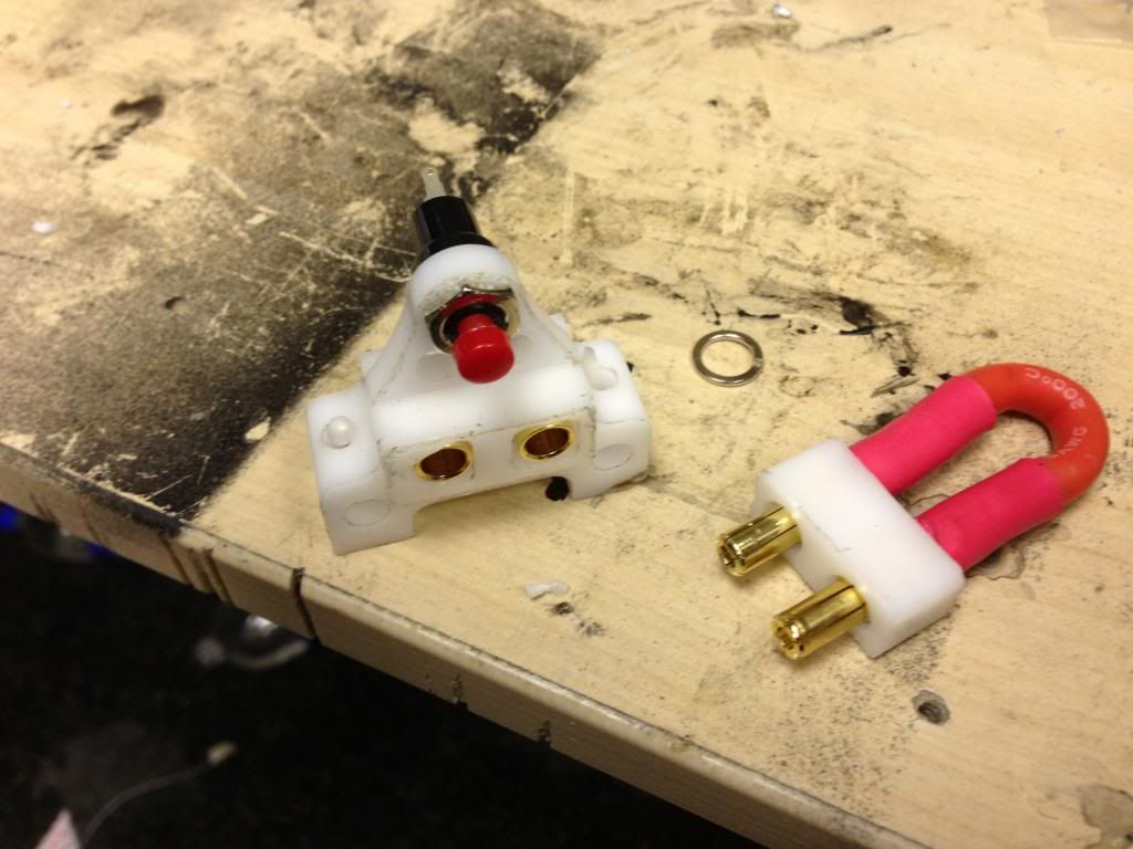

I also have a high voltage arming system inc antispark- these will be about £20 ish.

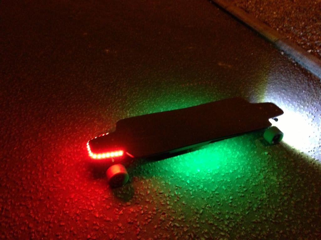

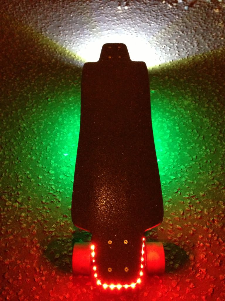

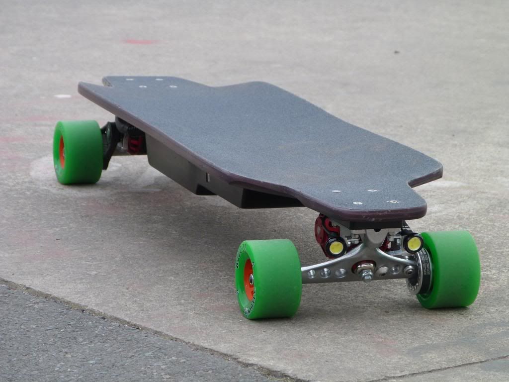

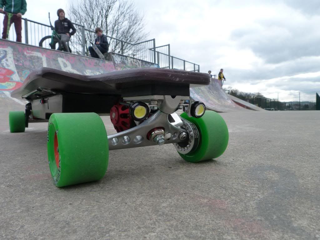

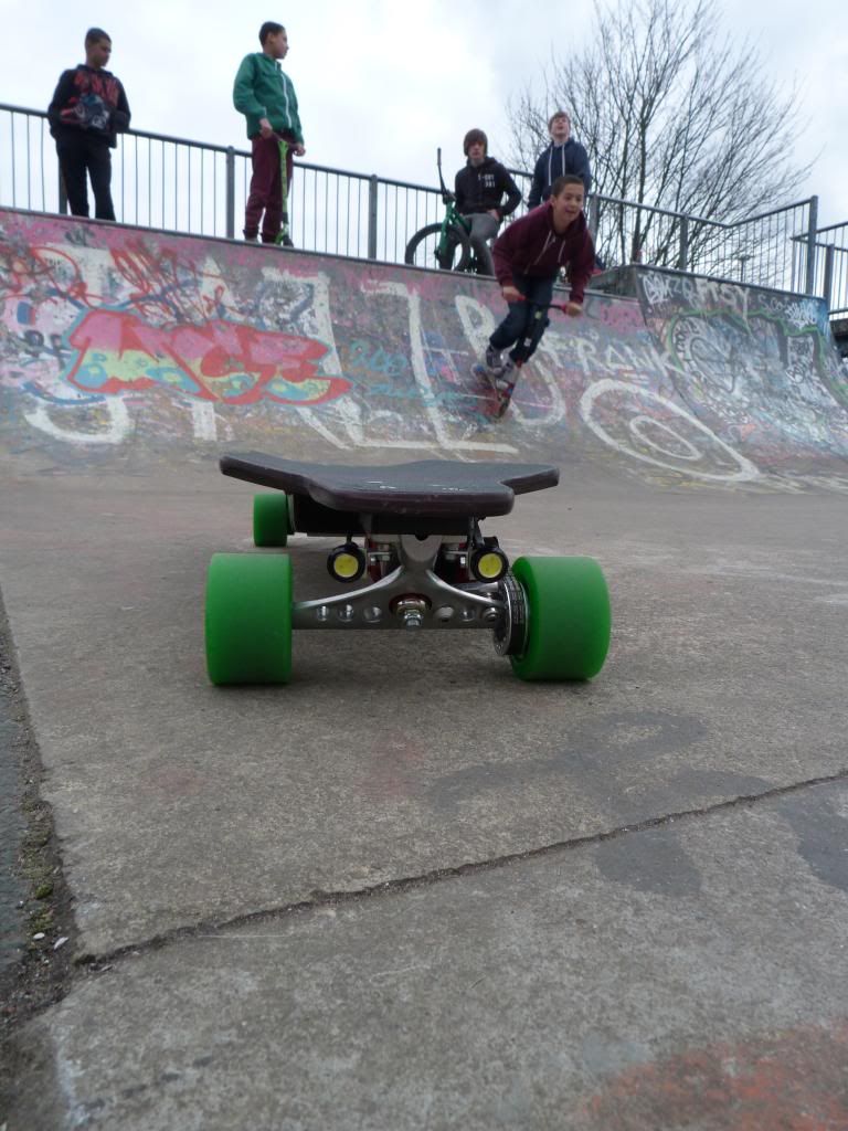

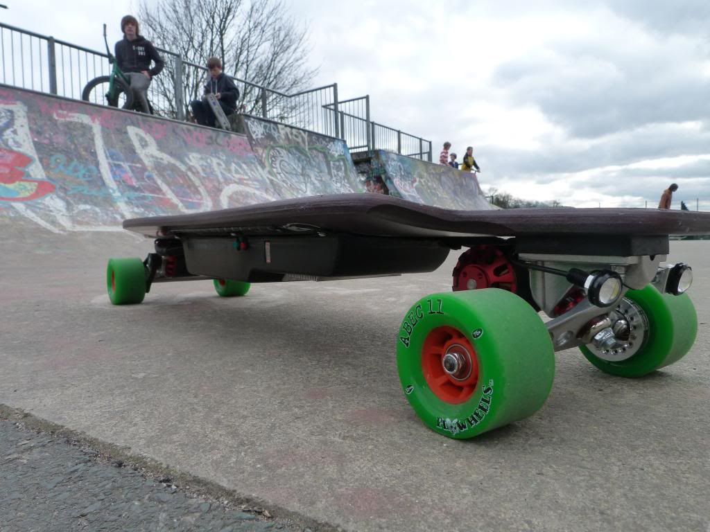

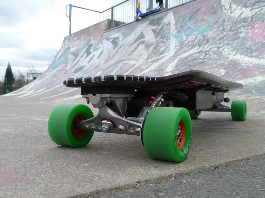

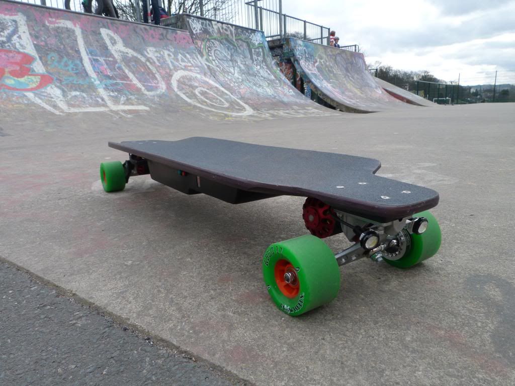

Here we are with the new deck and all LEDs fitted.. It carves absolutely brilliantly the concave deck is so much better- i can have my trucks tighter for more stability but can still turn at tightly as before.... ill post some pics later of the LED's on! when it gets dark ..p.sw the kids at the park are going wild for it!!
so next mods to do are a custom grab handle and to get the nunchuck working perfectly,regen braking.
[imghttp://i1309.photobucket.com/albums/s621/richard_bailey1/P1050138_zps408f743f.jpg][/img]

The kit is everything u see in the photo of the parts inc belts and bolts.
So that's
:2 x drive hubs (CNC 6082)
:2x truck mounts (CNC 6082)
:2x motor brackets ( laser cut 6082)
:4x truck mount boss's ( CNC 6082)
:2x belt washers ( laser cut 1050)
:2x hub retainers ( laser cut 1050)
:2x high torque 5mm pitch belts
You then need a set if Holey trucks and Abec 11 flywheel (83mm) and your own deck and your away.
Obviously you also need the motor/ batteries / ESC which Bruno can provide .
I can also provide the LED kit with power transformer for about £30. U would need to add switches if your choice to that.
Hope this answers your questions ..
