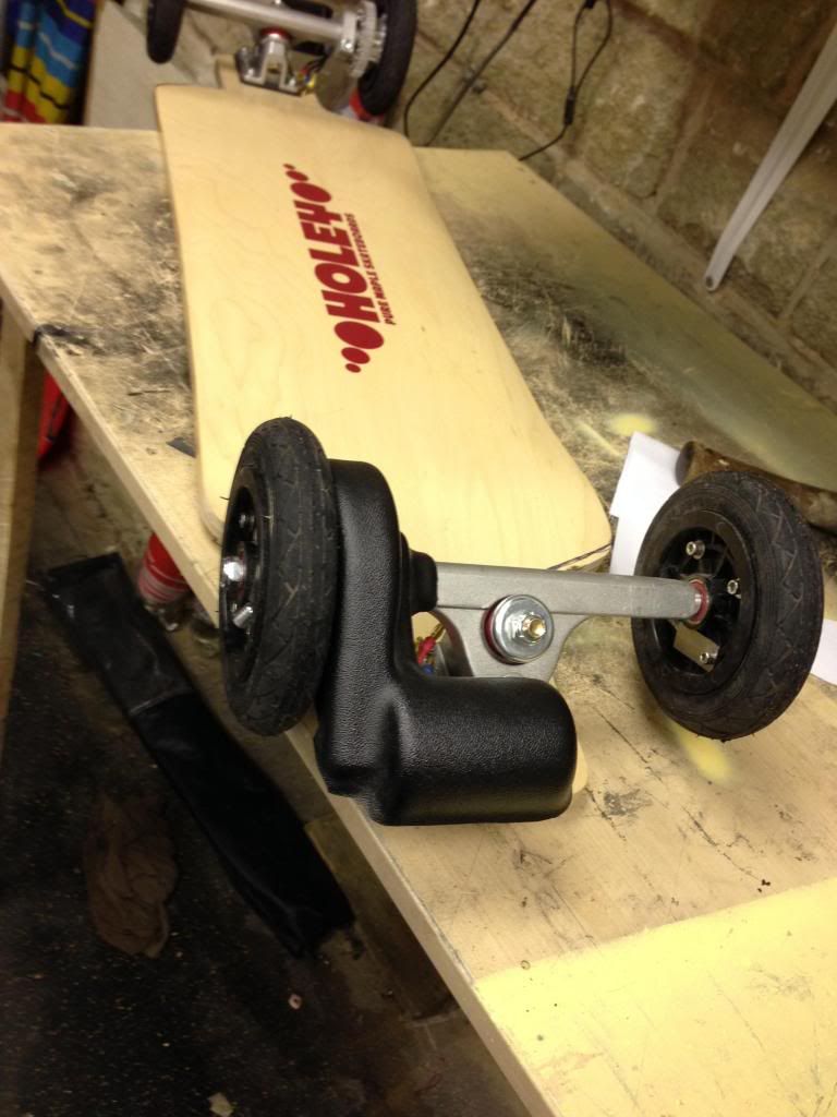

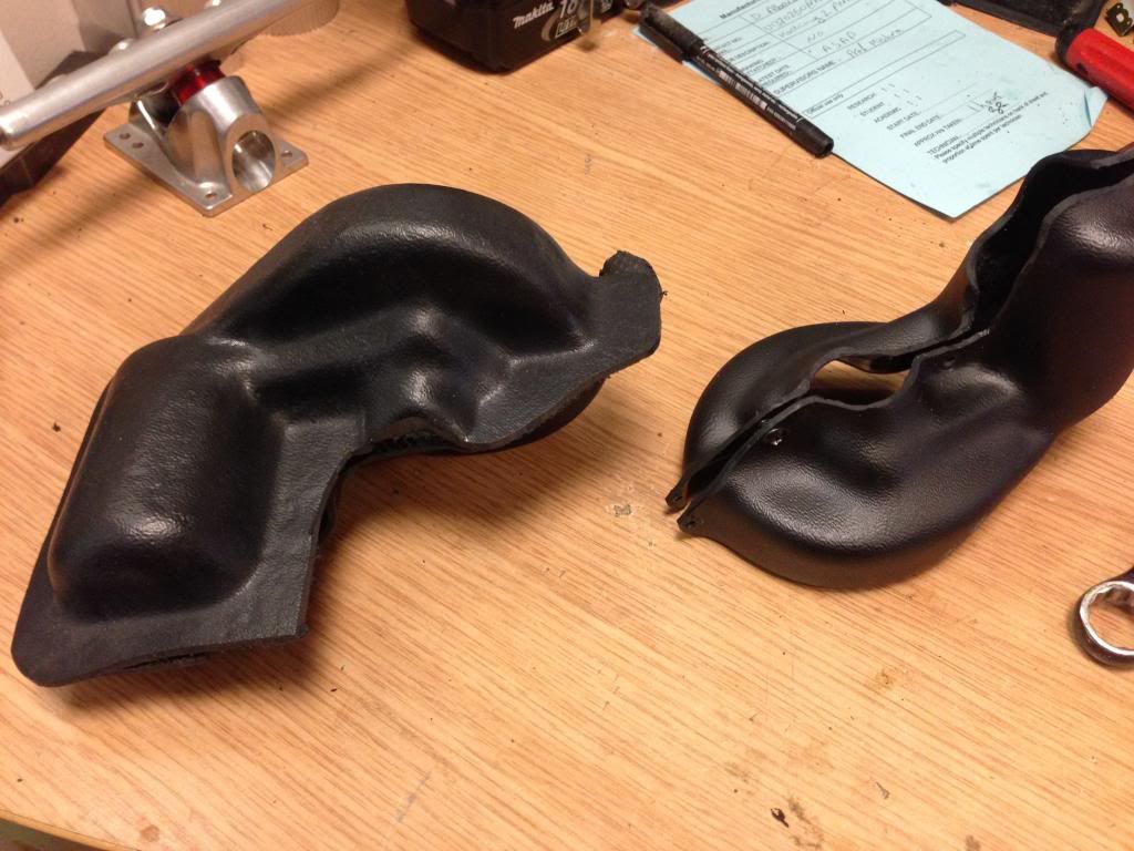

i made some covers for my urban deck but they proved difficult to attach and i was concerned about the heat build up.. I have also run in light rain and its been fine..i wouldn't attempt heavy rain although i'd be more concerned about grip..
I made them with my vacuum former .
the former (made from foam on my CNC milling machine)
2 halves before trimming
beto_pty   1 kW
Posts: 480
Joined: Dec 17 2013 8:20am
Location: Panama City, Republic of Panama
Re: Destroyer 12s Urban Racer Build
Post by beto_pty » Apr 21 2014 12:36pm
Cool cover
I might look into thermoforming it instead of making it our of galvanized steel.. humm...
