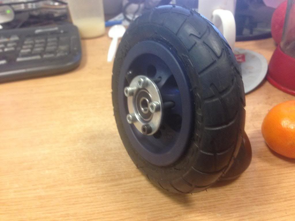

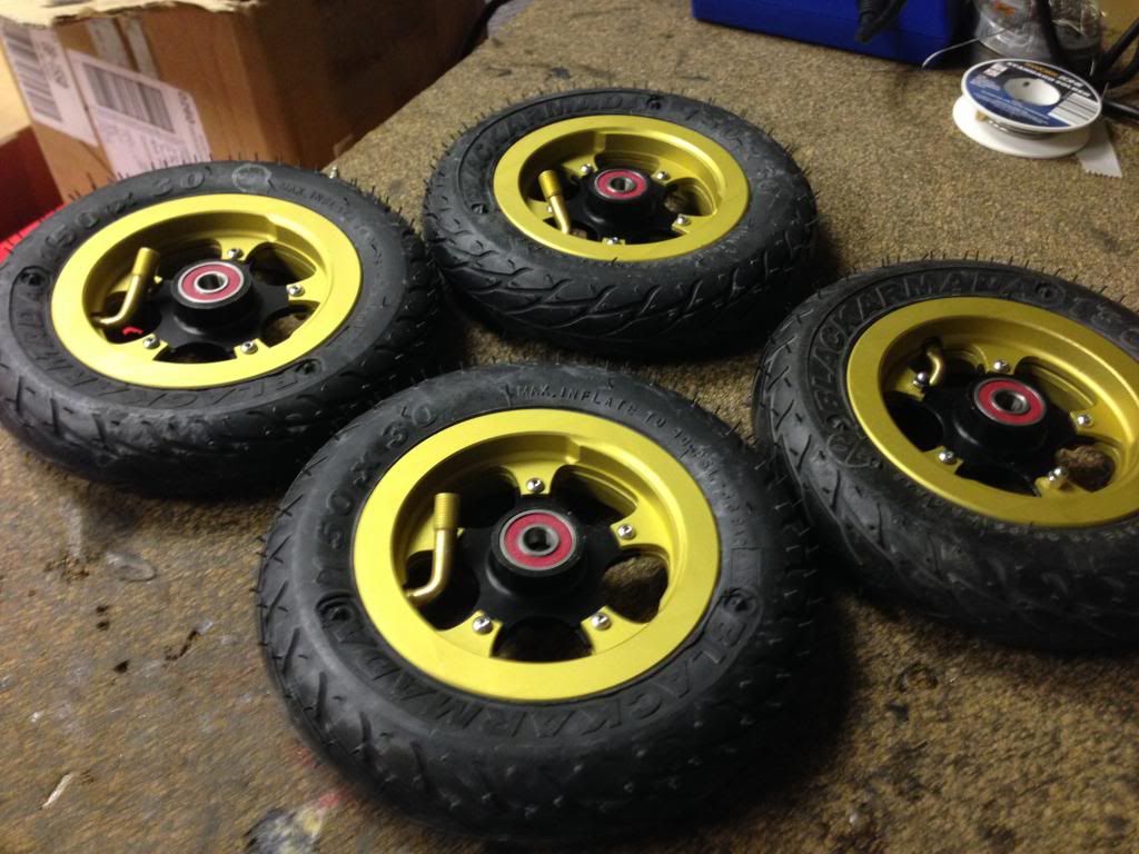

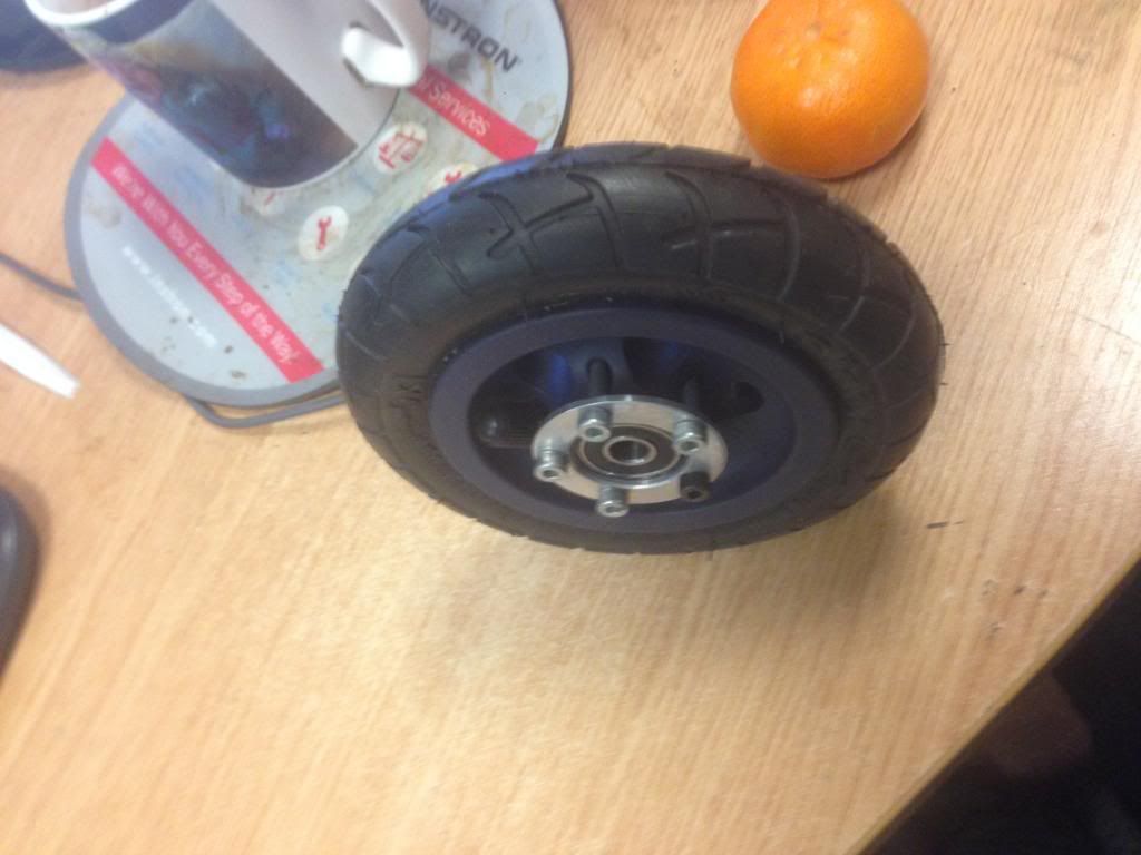

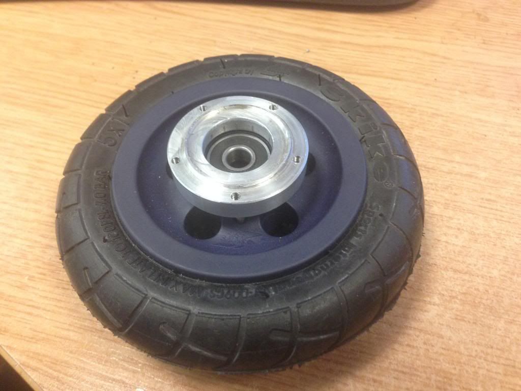

Postby beetbocks » Mon Apr 21, 2014 4:20 am
I have tried fitting standard Skike Kids wheels (125mm diameter)with a drive pulley and it worked perfectly but the hubs are too long to fit on a standard skate truck- the axle is not long enough ( or the wheel hub is too long) and the nut wont go on.. so back to the drawing board..
The bearing size is perfect and the price is good at $18 a complete wheel/tyre/tube/bearing...pity!!
I am considering making some axle extension pieces maybe..which could also incorporate the motor mount..
I have also made some 150mm wheels that fit the skike tyre (150mm)- but again the cost for production is ludicrous..
Skike kids 125mm
my 5" wheels -and these will fit a standard skate truck. but im going to fit them to a MBS truck -i think.. to give the width and clearance on a deck.
