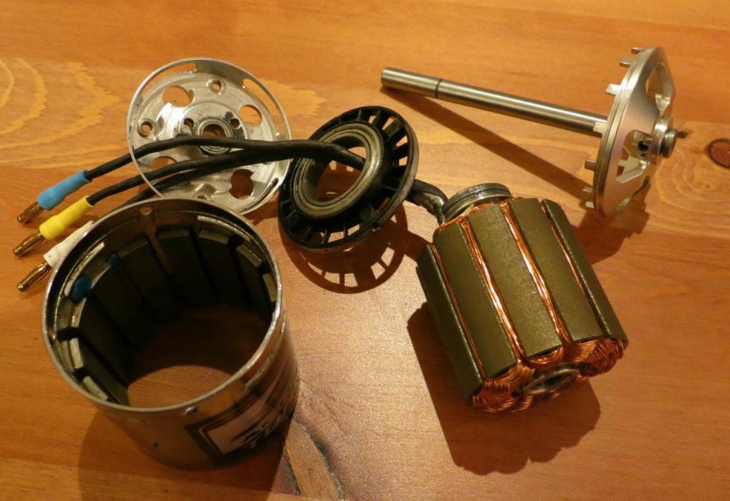

How did you put the motor in the wheel?

Outgrown wrote:How did you put the motor in the wheel?
Ok so I machined the centre out of the longboard wheel. Ideally you’d have a CNC milling machine for this because the lathe was just munting the rubber, not really cutting it. Maybe there is a lathe tool that would cut it. But for me the winning method was a CNC milling machine with side mill tool.
Freshair wrote:Am also curious as to how you did this. Was thinking about ordering a couple motors and pulling them apart to see if I could make a hubmotor myself since I have the cnc machines at my disposal, but if it can really be as simple as what you have done...
Seems like pressing the wheel around a motor would be a disaster waiting to happen though, without splines/ridges to get a good grip. Am guessing you used some sort of bonding agent?
Have some 107's that are just screaming to have a motor put inside!
The wheel then slides over the motor. No extreme force, just pressed on by hand and held on with an adhesive. Can’t remember what type I used now, it was about 2 years ago when I did this. No splines or flanges or anything like that. The adhesive has proven to be sufficient, I've done enough hard cornering and accelerating that any problems would have shown by now.

How do you get the center of the motor to slide into the trucks?
Sorry, I'm not very experienced..
rodgah
Posts: 584
Joined: Dec 23, 2009 7:07 pm
Location: Sunshine Coast, Australia
Re: Fast electric longboard – Dual hub motor
Post by rodgah » Apr 08, 2015 6:01 pm
Outgrown wrote:How do you get the center of the motor to slide into the trucks?
Take this picture of a outrunner.....
You are replacing the shaft (top right) with the axle of the truck. However the truck doesn't need to spin like the original shaft does so it will become part of the stator and so doesn't need to be isolated with bearings. Without bearings the inside of the stator is probably large enough to nearly slide over most trucks, but maybe a little grinding or lathe work might be needed and then bond it to the truck. You then also have to install a bearing in the end plate (which you can see the original shaft is still inside of in the pic), this will probably require you to bore the hole out a bit and find a bearing to go from this endplate to run on the trucks shaft.

what does the inner bearing on each motor sit on...I guess a hanger you lathed and the stator is sitting on the aluminum?
and the outside of the rotor is just a tight fit against thane and doesn't slip when accelerating or braking?
and you drilled out the bearing tube of the stator and pressed/glued it on?
that piece in you last photo, which looks like a holey bearing housing seems a lucky rarity in outrunners and seems to be the magic ingredient in your method.
So no other parts and just the bearings as they come and simply a squeeze-fit into a wheel you cut....I couldn't even get those wheels to cut without them crumbling.
pretty awesome in it's doing with nothing.

Hummina Shadeeba wrote:hows it do on hills with the 145kv...maybe it doesn't matter since you have so much meat jammed in two cans. :evil:
I still don't know many things about how you did this but then reading is a bother and I wish you'd just show pics of:
It goes up hills all good. I dont push it hard though for fear of blowing the ESCs.
The bearing tube of the stator has the housing for the inner (skirt) bearing. I cut this off and glued it to the trucks. Here I do remember what glue I used, 3M DP420. Good stuff, often used on e-bike torque arms.
Wheels are glued to the rotor.

Anyone copy this successfully? I'm waiting on my 145kv sk3 to come in its on back order

barajabali wrote:Anyone copy this successfully? I'm waiting on my 145kv sk3 to come in its on back order
There are some other hub motor builders here on E-S, you should read Pediglides build somewhere page 1 in this sub-forum;)
Mine are still in progress, but they spin:D only trouble with my remote^^
@Stielz, Great Work!
Can you tell us which halls did you use? I Plan to add some when i add my second motor.

Can you tell us which halls did you use? I Plan to add some when i add my second motor.[/quote]
These are the typical sensors that are used: ATS177-B-A type low-hysteresis digital latch Hall Effect sensors
I purchased mine here: https://www.digikey.com/product-detail/ ... ND/1301438
Seem to work, so far.

pretty much any latching bipolar hall sensor will work. The key is to get one in the surface mount package. the through hole package hall sensors typically used dont fit in the stator teeth slots. Quite difficult to do but i soldered fine wires onto the pins of the SMD package, wrapped the sensor in heat shrink and expoy them in place
