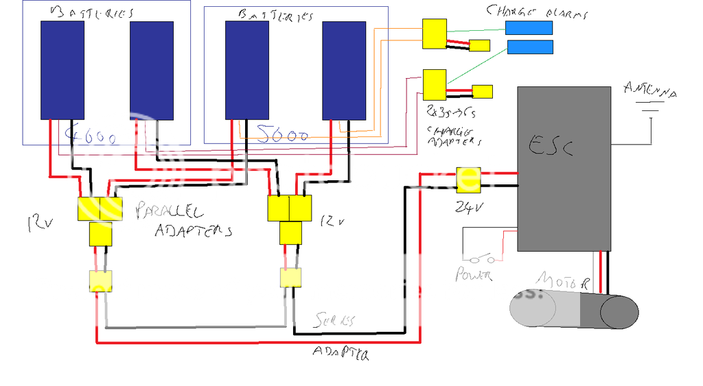

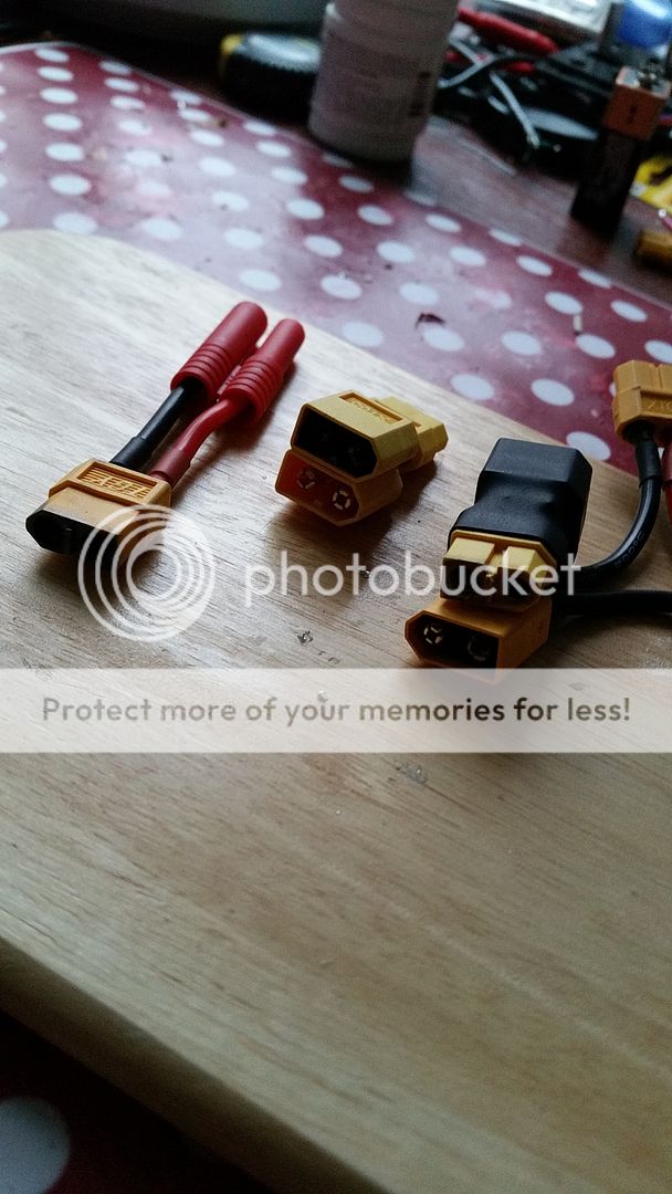

Now, a real problem I am having - whenever I plug in the batteries, I am getting huge power surges and sparks, big enough to fry the XT60 connectors. I'm up to seven ruined plugs now, out of spares, and really not enjoying the high-temperature soldering I'm having to do. Whenever I plug the b*stard things together to create a circuit, there is a huge flash and crack within the plug, and even if I'm quick, the contacts in both plugs are blackened and cooked. I mean, I know there's a crazy amount of current in these batteries, but I am struggling to work out why the surges are so big - the controller admittedly does not have a power switch in-line with the batteries, so they are not physically isolated, but even so, I didn't get this kind of fireworks with the SLAs! What I really don't get was that I managed to connect one half of the parallel setup successfully, so the controller had 24V connected, then I plugged in the other half and immediately incinerated the parallel connector. WTF is going on?!
A friend who has airsoft guns was helpful only in suggesting swapping the whole lot out for XT100s. Seeing as I now have everything set up around XT60 connectors, I would like to avoid this if at all possible. Any other advice?

Postby sl33py » Fri Jul 24, 2015 6:35 pm
Gargravarr - sounds like a short to me. I'd quadruple check your + and - ... I had similar happen to me one time and turns out i flipped one of my xt-90's i soldered onto the ESC. Fried a couple connectors before i stopped, double checked, and finally found it. D'oh! moment.
The spark you should see even at 24v is only a quick pop with small discoloration to the metal - not slagging or melting - that's welding and makes me think something is wonky and you are grounding out/shorting it.
Post up a series of pics of your wiring and we can look it over for you?

Postby Gargravarr » Sat Jul 25, 2015 6:31 am
sl33py wrote:Gargravarr - sounds like a short to me. I'd quadruple check your + and - ... I had similar happen to me one time and turns out i flipped one of my xt-90's i soldered onto the ESC. Fried a couple connectors before i stopped, double checked, and finally found it. D'oh! moment.
GL!

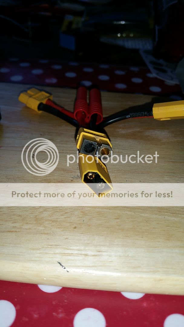

I suspected it was a short, but showing the same friend this photo, he was convinced it was only a power surge:
Well, the current carnage includes:

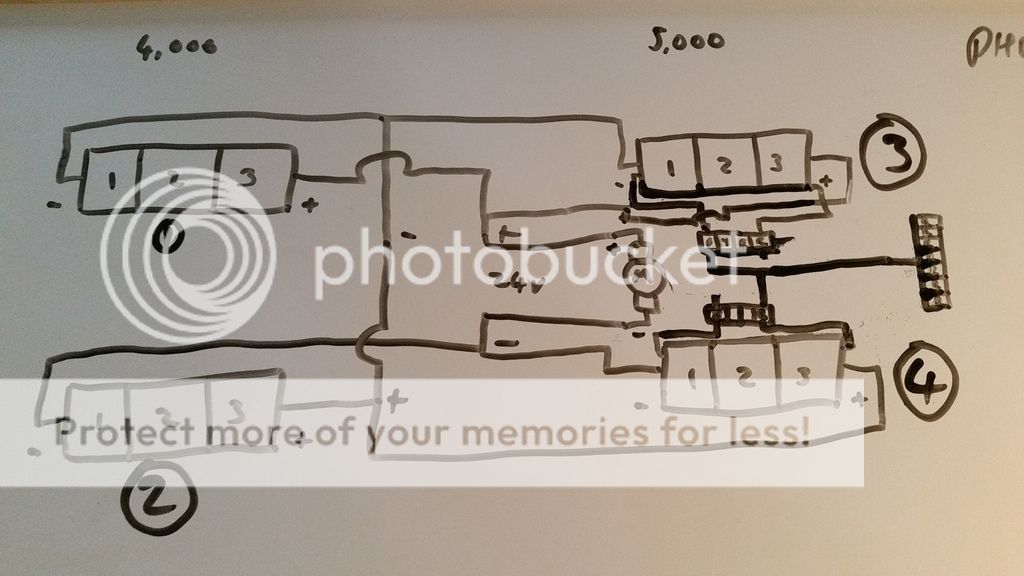

Okay, so I dug out my graphics tablet and created this:
Granted, it could be a bit clearer, so let me explain the logic:
  • 2 banks of 2 batteries - 1 of 4,000mAh, 1 of 5,000
  • 1 battery from each bank in parallel for 12V, 9,000mAh, such that drain should be equal across both banks
  • Both sides into series for 24V, 9,000mAh, into the ESC
  • 2x3S->6S charging adapters for charge alarms, eventual external charge connector
Besides my atrocious attempt at drawing, is there any problem with this layout?

Postby sl33py » Sun Jul 26, 2015 1:44 am
Ugh... that drawing doesn't help me. OK, looking at it again it makes a bit of sense...
As for your friend who says that looks normal needs to not ever touch electronics again... that isn't spark that's WELDING. That is a short and mine looked almost identical. Smoke and black/melted is not "spark". "spark" is a small tap sound and small flash. You will see a bit of oxidization where it sparked and over time it will wear your connector out. That is not the same. Melted metal is no bueno.
OK, to the troubleshooting. With your drawing not helping as it looks reasonable to me, how about this - simplify. Try a single set in series and eliminate the parallel. If not a problem, try the other set in parallel and not in series. Either has issues, then let's dig into that setup specifically.
Under volting the setup will likely not perform well, so i wouldn't do much except confirm it doesn't weld a connector (parallel).
Make sense from a troubleshooting/diagnosing perspective? Wish i could point out "x" was obviously the issue...
HTH - GL!

Postby Gargravarr » Sun Jul 26, 2015 4:16 am
sl33py wrote:Ugh... that drawing doesn't help me. OK, looking at it again it makes a bit of sense...
HTH - GL!
That's what I thought - it doesn't make any logical sense why there would be a short, unless the ESC is doing something very strange that it really shouldn't be. Could the charge adapters have something to do with it? All the other cables are insulated (I even went so far as to replace the heat-shrink I had to cut off to re-solder them), the ESC connector has correct polarity and all the batteries are wired up properly.
I did try connecting just one pack to the ESC in an attempt to charge up whatever capacitors might be in it, trying to reduce the spark, and at first it seemed to work - when I connected 2 in series, there was no noticeable spark. However, that was when I cooked the parallel connector.
The charge adapters are the only things I can think might be influencing it, although passing enough current through the XT60s to weld them, I would have expected the balance leads to melt, which they haven't. I'll have to do some experimenting, I guess.

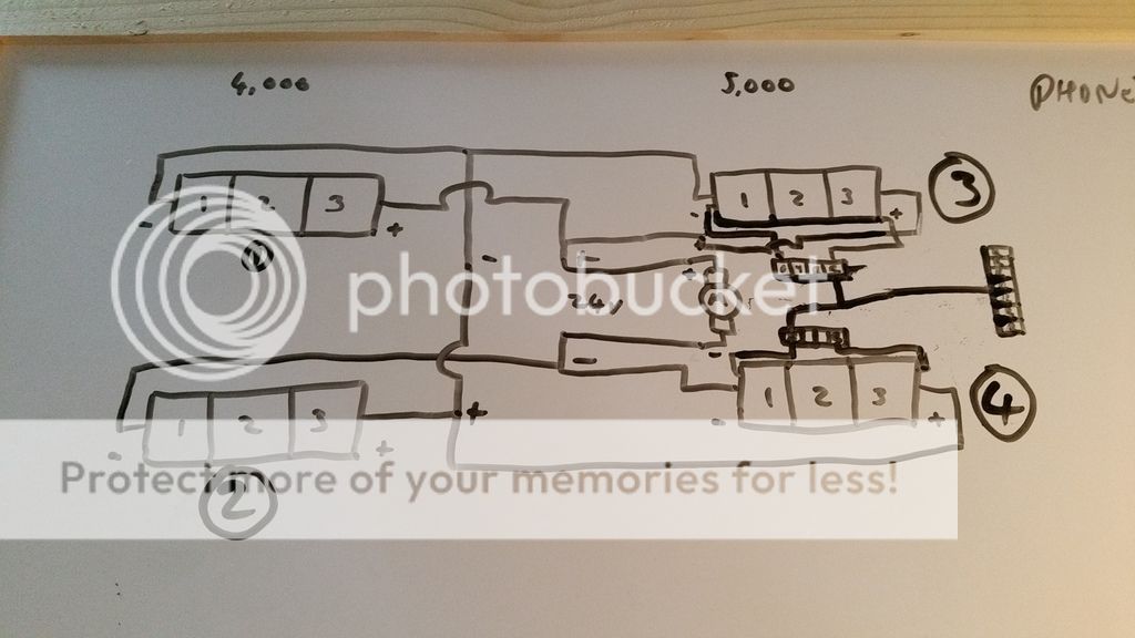

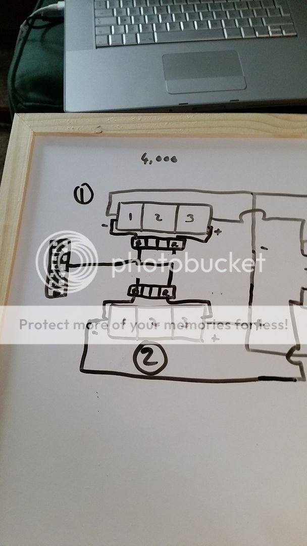

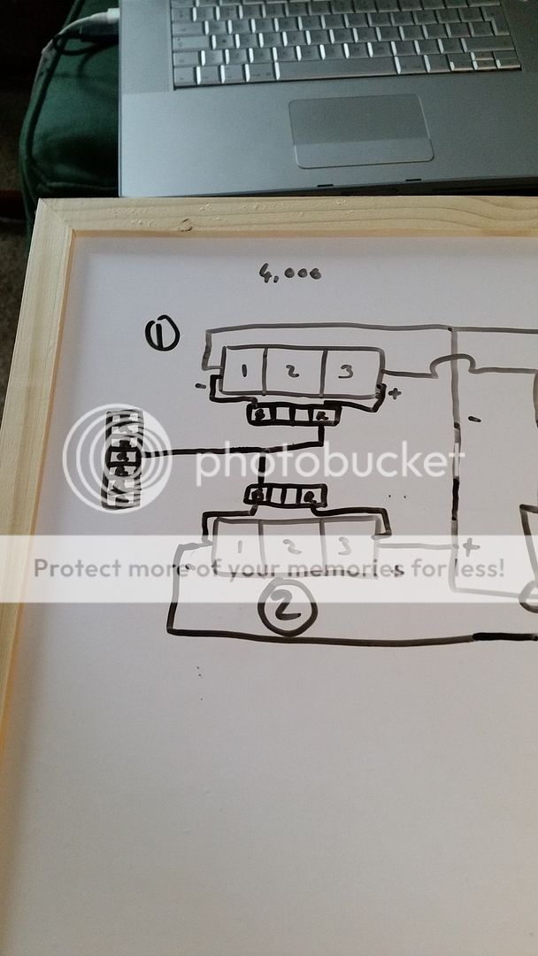

Postby Gargravarr » Sun Jul 26, 2015 12:10 pm
Okay guys, I think I was right about the charge adapters. I didn't realise they bridge the batteries into series - the central pin in the seven-pin 6S connector is connected to both the positive end of the first battery and the negative end of the second (taking GND to be of the first battery). I traced this out on my whiteboard and discovered there is indeed a short when the batteries are wired together in a certain order (other balance leads omitted for some semblance of clarity; focus is on the 5,000mAh bank of batteries):
However, if I plug the batteries into the charge adapter in reverse order, I can't see a short:
Same story on the other side in the 4,000mAh bank:
Short:
No short:
I'd love it if a second pair of eyes could just double-check my wiring; I think I've gotten it right in the second and fourth photos, and I've labelled the adapters accordingly (my batteries are also numbered on their discharge leads), so I think this will now work without shorting.

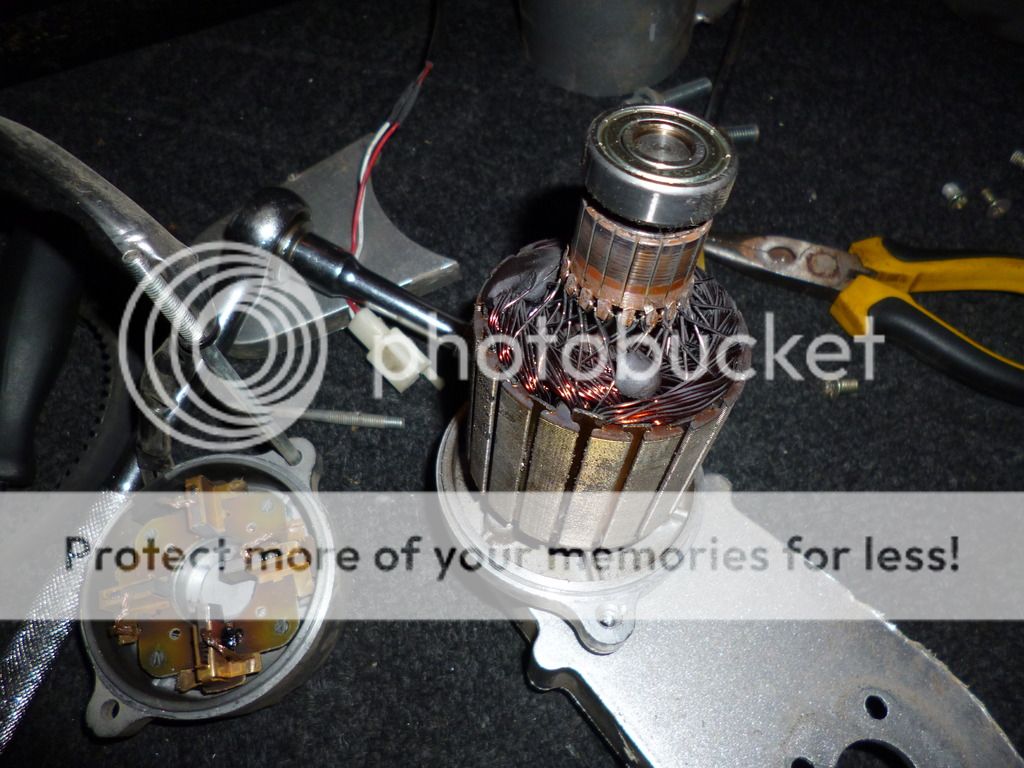

Sadly, disaster has struck again, and this time it may be fatal. I think the motor has burned out. Last week, I noticed performance was down a little when first setting off, and the motor was making some odd noises. They cleared once the motor warmed up so I didn't think much of it. Then on Thursday, on my ride home, I hit a bump and the whole thing rolled to a halt. At this point I could smell burned electrics, and when I lifted the board up, there was smoke coming from the motor. I flipped the power off but I guess the damage is done.
The screws holding the motor housing together were badly warped from years of abuse (probably before I even got it) so it's taken me a while to get the tools to get into it. However, when I pulled the end caps off, I discovered the housing is the motor - the end caps hold the armature bearings and the permanent magnets are attached to the tube. The bearings are still good, but there's a strong smell of burning from the rotor even now.
It's a plain brushed DC motor. There are scorch marks around a couple of brushes in the end cap, and the armature is covered in metal filings, which seem to have come off the magnets. At a guess, the magnets have worn away and worked into the electrical path, where they shorted out something. The wiring doesn't look burned, but whatever caused the failure sucked a lot of power through - the casing was untouchably hot and trust me when I say it stinks!
What are the chances of repairing the motor? I've got a sizeable investment in the board now, I'd rather not bin it. The chance for replacement is next to zero since the company is long defunct.
