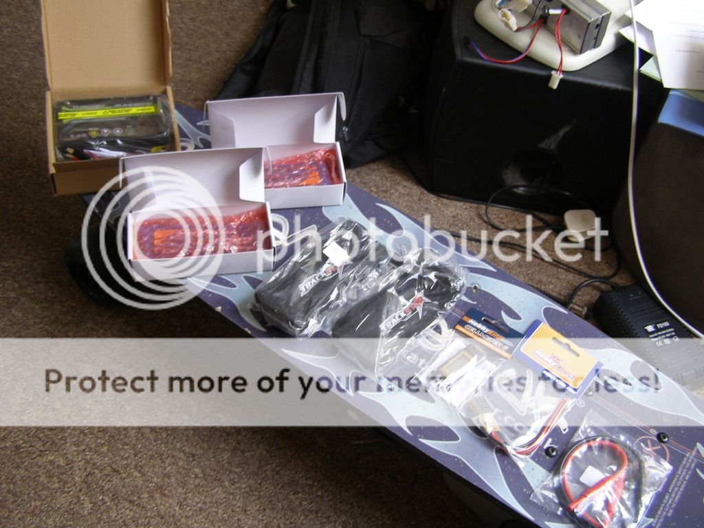

All right, photo time gents!
This is the board itself, with my 360 controller shown for scale. Bit of a beast, I think, although I've never seen another in the flesh.
The bits that make (made) it tick, again with the controller so you can see the size of the motor.

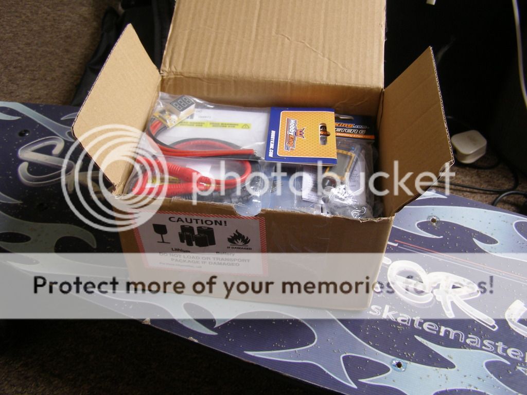

Big box of fireworks - 'DANGER! LITHIUM BATTERIES!!'
Unpacking - 2x li-po packs with cases, charger, banana connectors, mini-alarm, mini-green/red cell monitor and in-line volt/ammeter.
The more observant will notice I didn't get a power supply for the charger - they were out of stock (Murphy's Law...) when I was buying, so I've ordered one from HK's 'International' warehouse. In the meantime, I realised the charger comes with a pair of crocodile clips and is clearly meant to run off a 12V battery - neat! I can put the SLAs to use! But first, let's see if there's any juice in the packs:

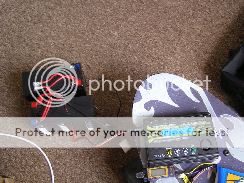

A good 11.6V! How about the other?

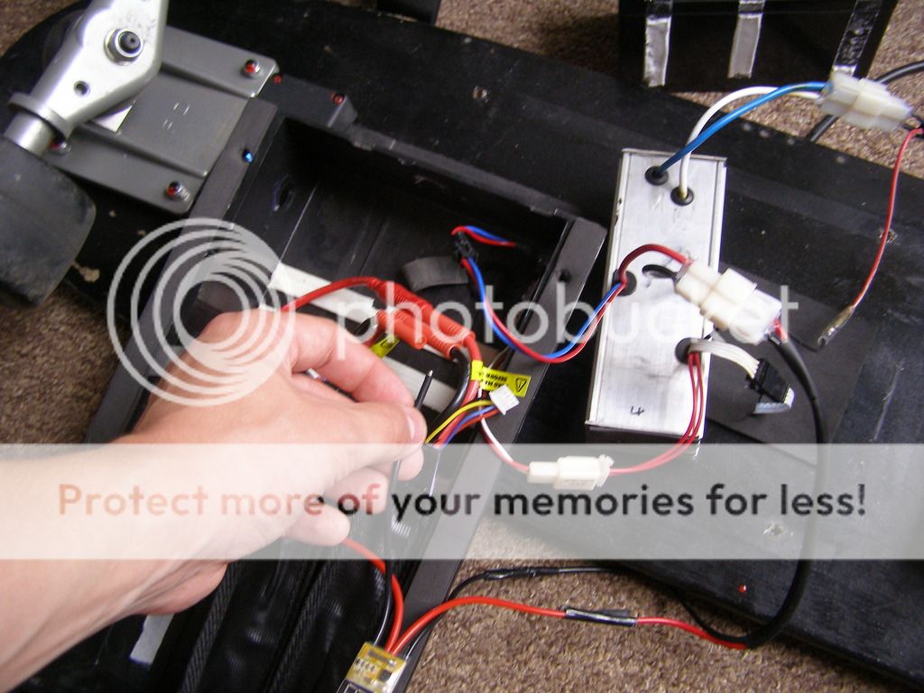

Snap! I also put the monitor/alarm on both packs and it reported the same, with a max cell variance of 0.035V for both batteries, so I assume this is good!

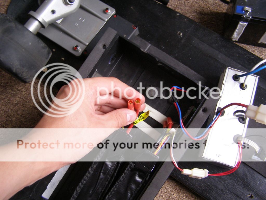

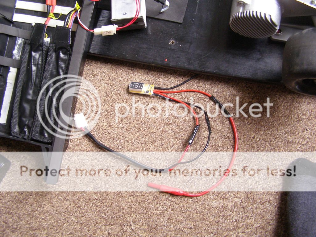

The first hurdle. HK didn't make it clear that the connectors for positive and negative are opposites! Also, only the positives from my pack of banana connectors are actually usable Damnit. So, before rigging all this up properly and taking it out on the road... erm, pavement... I'm going to have to get some proper connectors for the negative.
Got the soldering iron out and desoldered the wiring from the SLAs, then soldered in the inline volt/ammeter and then one of the banana connectors.

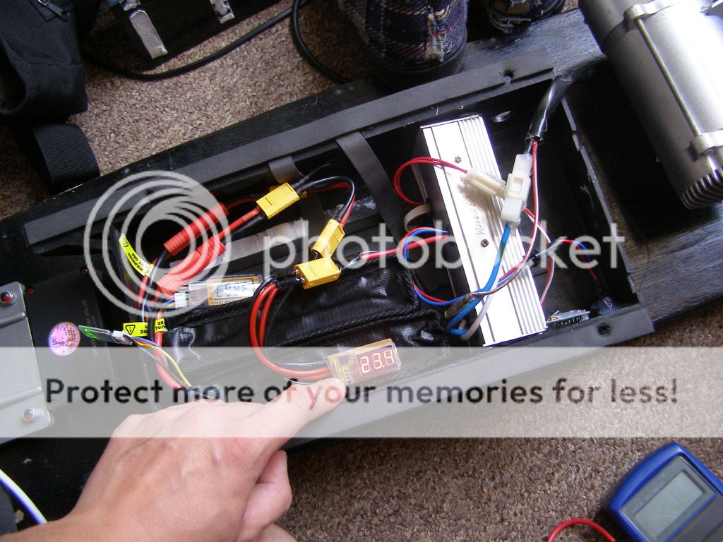

Moment of truth!
And this is where we are at present. When I touch the negative to the battery (done so twice), I get a pretty impressive spark, and that's with the board's controller switched OFF. Should this be happening? I don't want to connect them again until I know it's okay. Last thing I want is for something to short out and the first test of this whole rig is the fireproof cases!!
Am I doing this right?
Edit: okay, with regards to the whole battery-connectors/banana-plugs thing - looks like I totally misunderstood. The batteries have 4.0mm HXT connectors. Sl33py - I just put in an order for a batch of XT60 gear, including adapter cables for the batteries. Looks like 60 amps will be more than enough for this rig. I'll remove the original connectors from the ESC power cables and fit some XT60s instead. I guess I can try to re-use the banana connectors for charging.

Nice!! in series 24v i'm not surprised you are sparking. That's normal from what i understand and what my lower voltage 6s pack does as well. That's why i use the xt-90 anti-spark plugs for my 6 and 8s setup - they work great to avoid spark.
Can't wait to hear your report after the first ride. GL!
Just in case, hope this is how you have yours wired in series:
might be repetitive and something you already know.

I was more wanting to know if it should be sparking with the board's power switched off, especially since I can't see any obvious shorts or crossed wires - could it just be to do with the voltmeter? Again, I really don't want to short this thing out and be left with a smouldering crater where my board used to be...
And yeah, don't worry, I remember high-school physics ;) I bought a 2-into-1 series cable to neaten the wiring. My original intention, as you might have spotted in the photos, was to plug the batteries together, but obviously I drastically misunderstood the connectors, so now I'll do it properly. Got another box of wires on the way, and if this works, I'll consider adding another couple of packs in parallel to boost the range.

Post by Gargravarr » Jul 07, 2015 12:49 pm
Okay, progress.
I got it working :D
I ordered some HXT-XT60 adapter cables plus some XT60 plugs and sockets. I painstakingly removed the original power connector and soldered on an XT60 connector instead. I also soldered XT60 plugs to the volt/ammeter, so I can disconnect it if I don't want it.
It works! After this, I bolted the carrier back to the board and took it down to the local park. It has way more power now than with the dying lead-acids, and is quite a few KG lighter. Most of all, it has uphill performance now! I even got brave enough to put it in second gear, and that was fast enough to be scary :D
Predictably, on the journey back home, the batteries ran out. They went pretty quick, too - little warning before the board was unable to power itself. This is a characteristic I'm going to have to watch for. I would like to put a power meter at the toe of the board - the original location on the side of the carrier is totally invisible while riding!
At present, I don't have a mains lead for the charger. The only thing I have capable of supplying 12V at 7A is the car; fortunately I bought a cigarette lighter cable with the other adapter leads, so I'm going to go run a fast charge. I'm also using the old SLAs off the board in parallel to begin the charging cycle.
Oh, and guess what - when I came home, I noticed a small hand-written sticker had fallen off the board, must've been on the motor. It says '350 / 24', which must mean 350W / 24V, so I finally have my motor rating :D Pleased with that, boards in that power range are about 4x what I paid for it! Max current draw will be just less than 15 amps by that logic.
