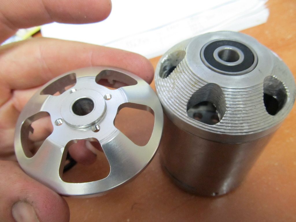

Made a bunch of changes recently which freed up a lot of time and a little bit of money, and since my job entails running cnc's figure it was about time to build me an electric longboard. The heavyweight is quite a suitable name since without batteries it weighs 15 lbs.

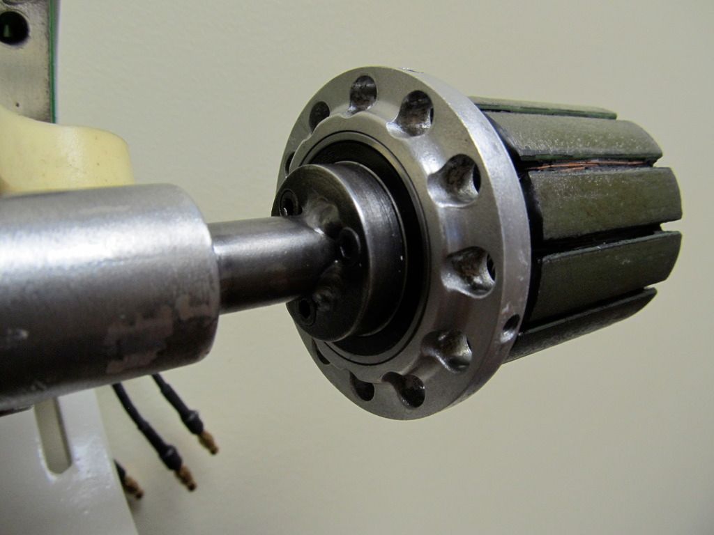

First was to take apart the sk6374's and figure out how I was going to mount these stators onto my roja hybrid hangers. Did not foresee a problem though since the hangers are cylindrical.

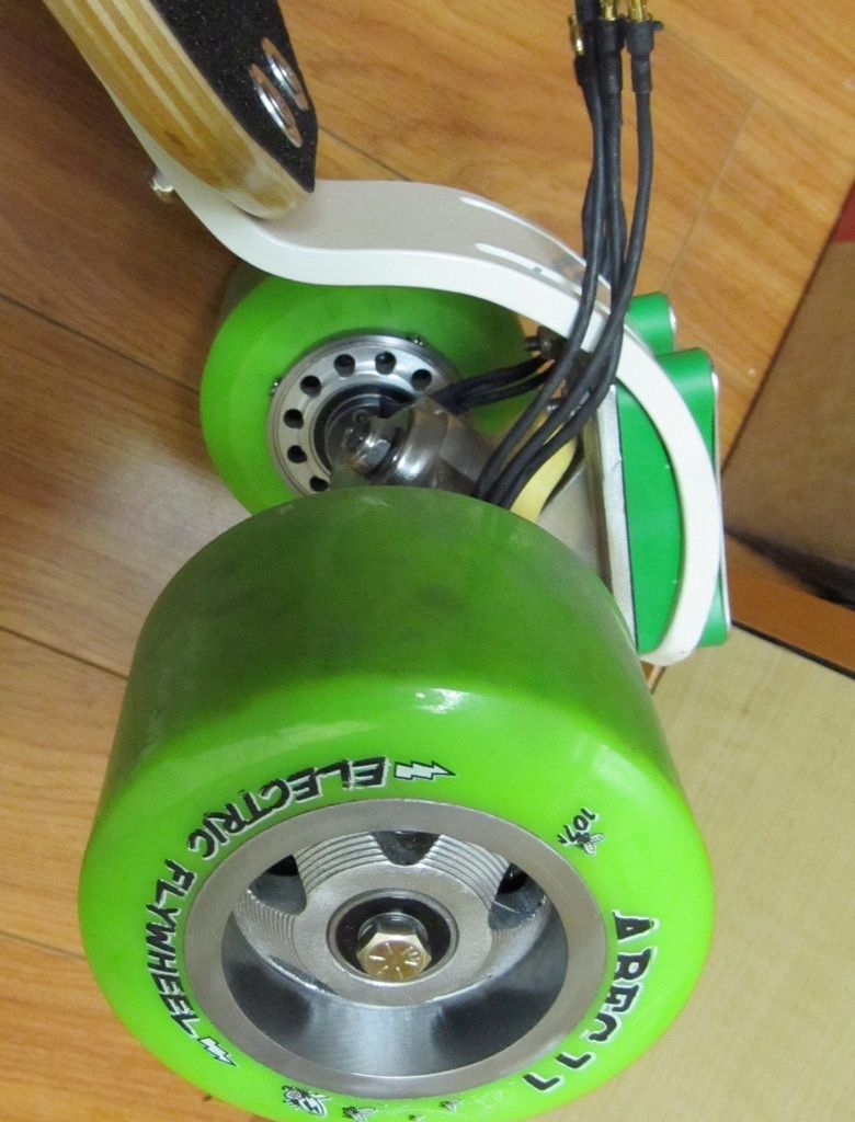

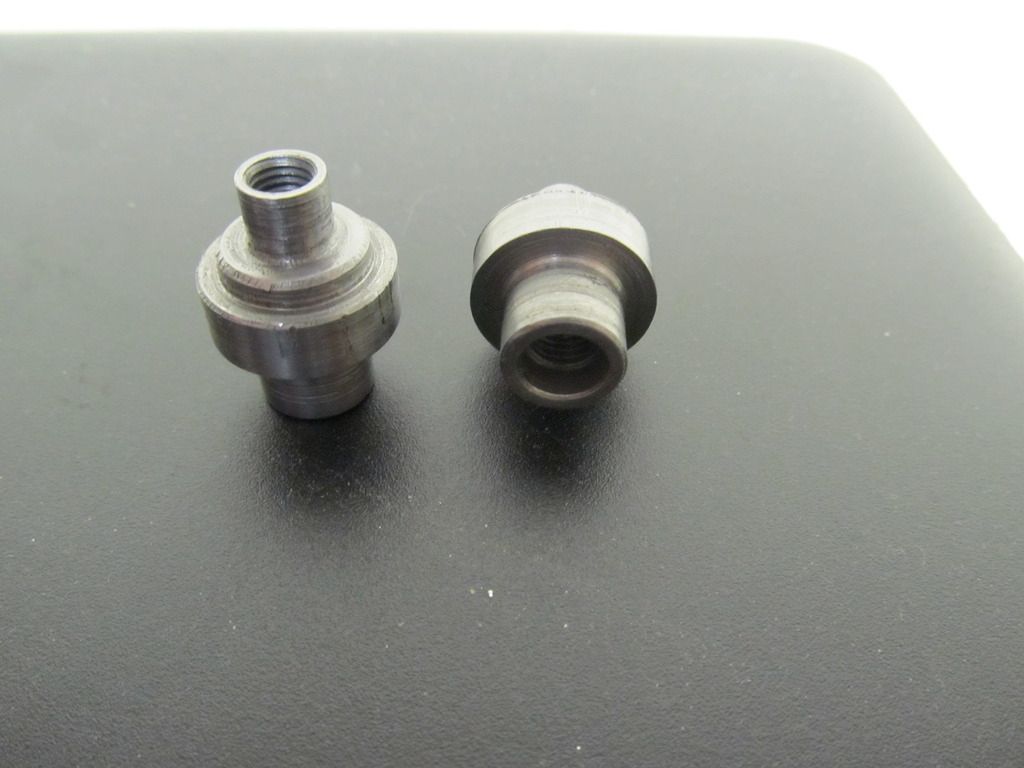

Ended up making an axle extension that screws onto the hanger and slides into this recess in the stator

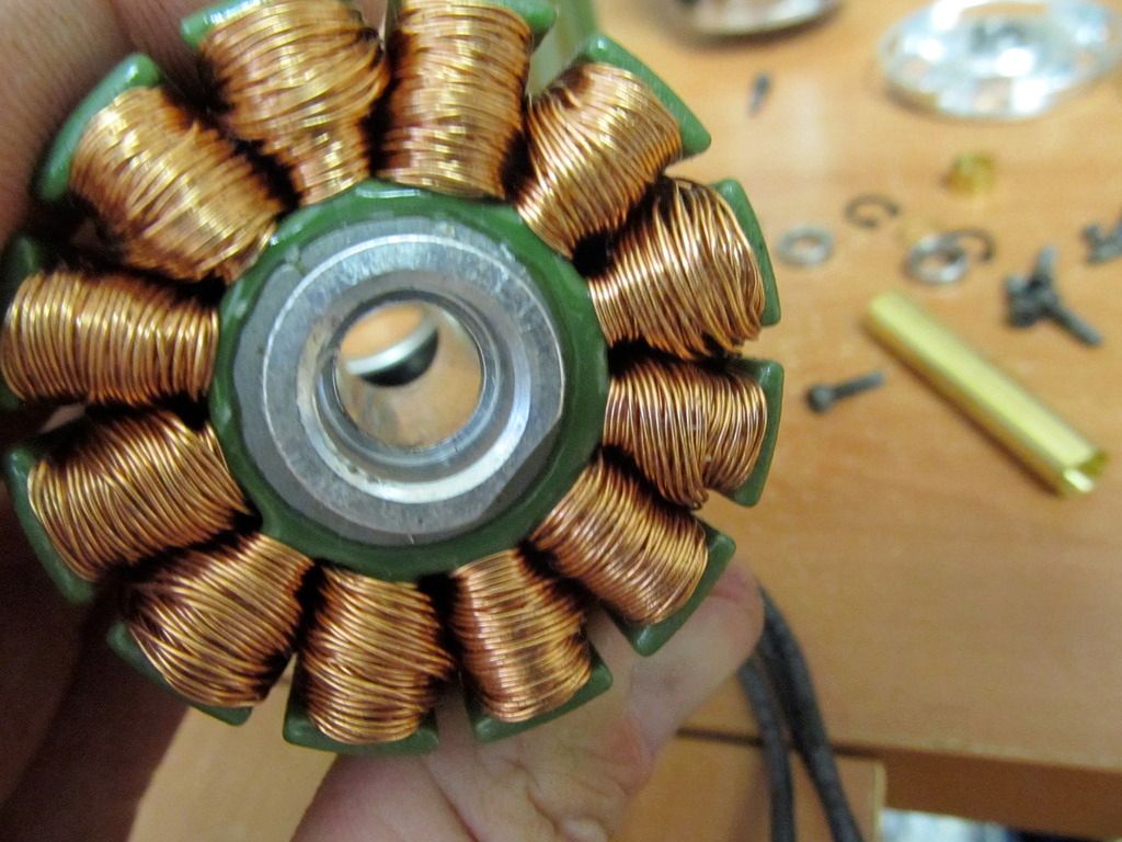

And as you can see, decided to put thermally conductive potting epoxy on my windings
The other side conveniently had three screws that I could use to fully secure the stator from movement, and ended up making a flange welded to the hanger to support everything

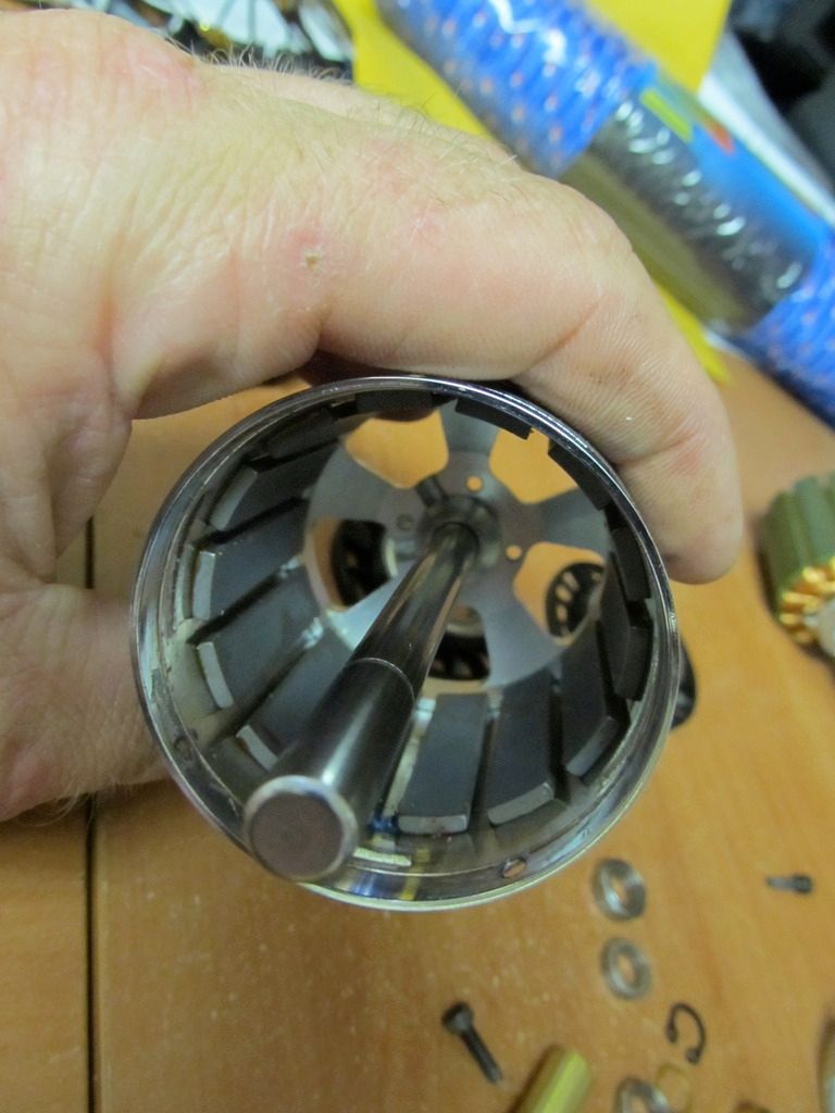

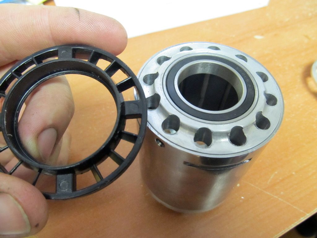

Made a plug for the can so that I could get the potting epoxy in between the magnets as well.

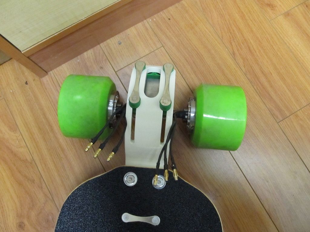

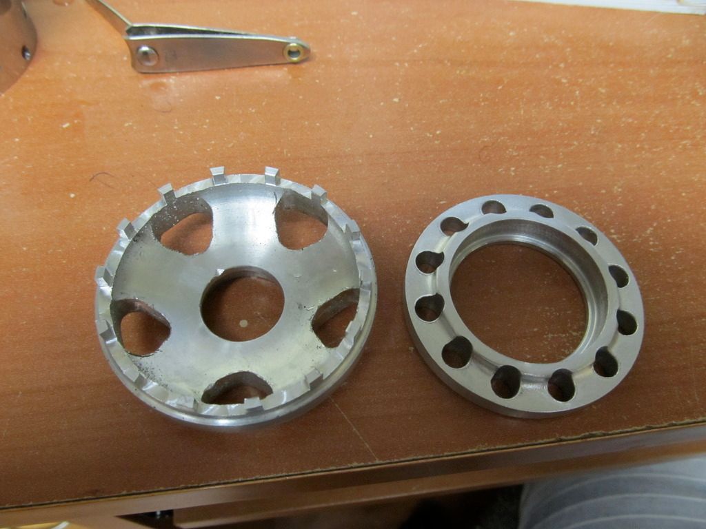

Decided that the original flange for the larger bearing was too flimsy, and it also needed to be a little wider so I could tap larger screws thru it to later on secure the liner which slides over the can and bonds the urethane. Also the tiny little bearing on the other side just would not do, so made a new flange which fits regular 608 bearings, and beefed it up a good deal.

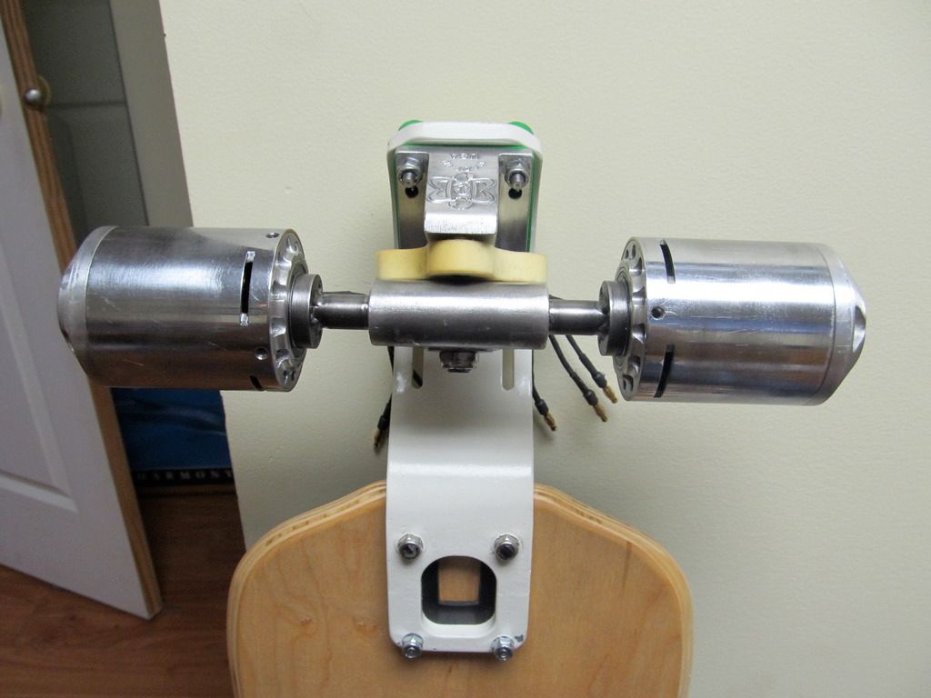

Everything went together just as imagined

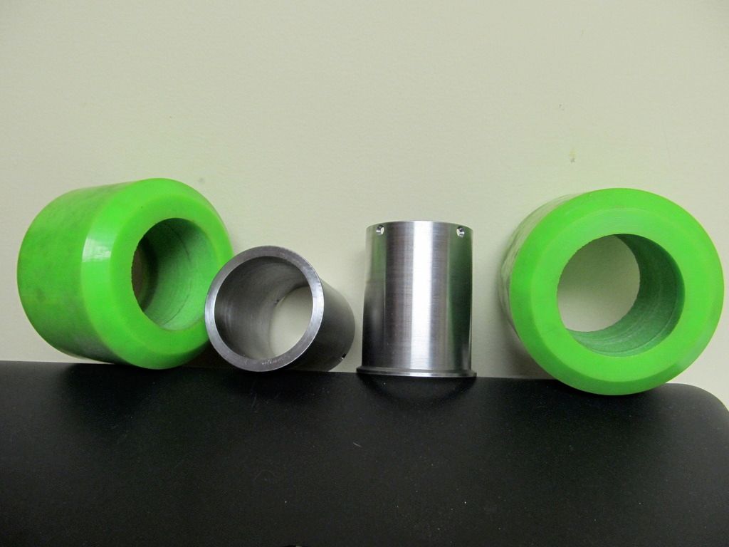

Had some urethane cored out for me by pediglide, and made some liners to bond them to. Ended up making the liners out of steel, it is a little heavier but far stronger and from what I understand thru asking about on the sphere, steel on the outside of the can helps keep the magnetism where it belongs which couldn't hurt
And with everything put together, it is looking pretty stealthy!!

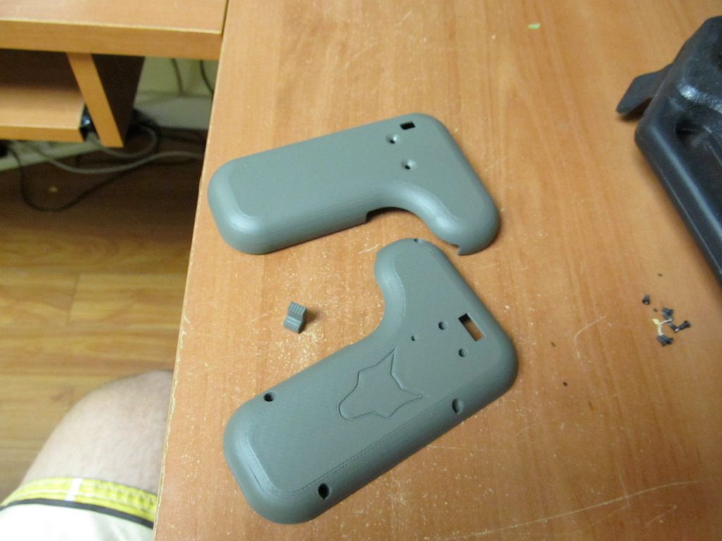

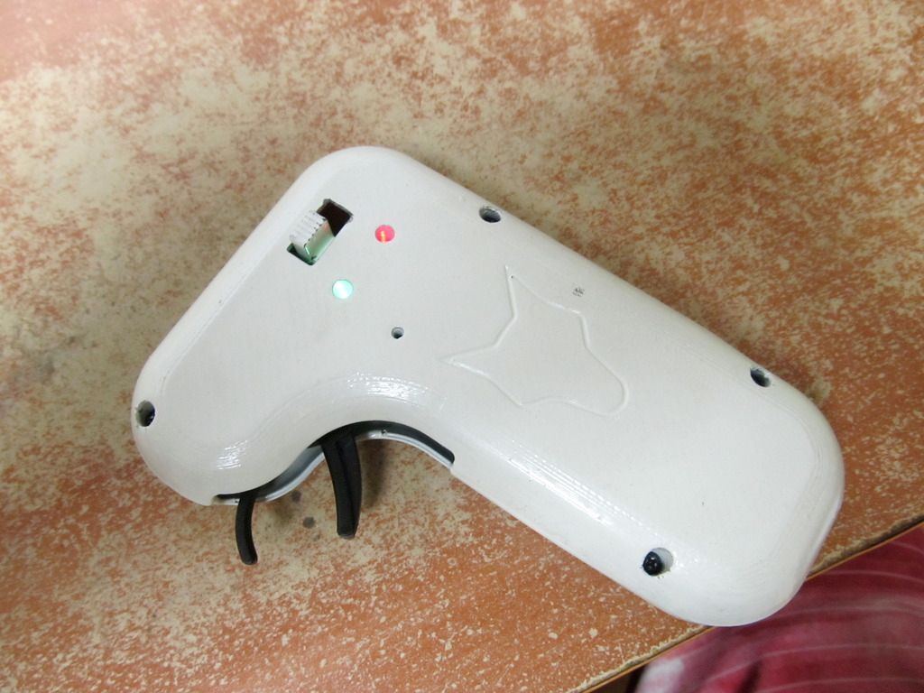

Also decided to 3D print badwolfs enclosure for the gt2b

To ask about the endcap of the sk3 motor with the notches that help space the magnets. How is that part removed from the sk3 motor before you rebuild it? From the pictures, I'm thinking it was press fitted in.
Freshair   100 W
Posts: 122
Joined: Mar 12 2014 6:47pm
Location: British Columbia
Re: The Heavyweight
Post by Freshair » Aug 09 2015 2:39am
Yep it is just a press fit with some epoxy, a few love taps with a rubber punch will remove it from its home.

Hey Freshair - can you walk me through your badwolf v2 GT2b? I have a new v2 being printed and want to install the electronics into the smaller BW enclosure. He doesn't show the steps all that well and not sure about the resistors you need to install? Do you still have throttle trim?
Where in Australia are you locating to? We did a 2 week trip (too short) in 2014 and loved it! Melbourne, Sydney, Adelaide, Darwin - hurricane re-route instead of Cannes for barrier reef diving :( . Absolutely amazing trip and the coolest folks to hang out with!!!
Beautiful build so far and will follow your progression.

The instructions are pretty straight forward once you start taking everything apart and looking at it, but like you was also confused about the resistors and had to send badwolf a message to straighten it out. Basically you take the leg of one resistor and solder it to the outside left pin (of the three highlight pins) than take the leg of the second resistor and solder it to the outside right pin, and than solder the two remaining resistor legs together to the middle pin. There is not much room for both legs on the middle pin so used a separate wire to connect to the two joined legs.
Not sure what you mean by throttle trim?
The battery and usb wiring is very straight forward and if you look closely at badwolfs pictures you can see where they were placed. When you take apart the battery keep the plastic part on the top that shows the -/+ , so you know what to solder to.
Am headed to Bowral NSW, and really looking forwards to a change!!

Thanks Freshair. That does make sense. Do you remember which 680 Ohm resistors you used? I'm guessing the smaller 1/4w vs larger 1/2watt, but want to confirm.
I hope to have my v2 enclosure in hand this week and will try this out. A trip to the local hardware store for the extra screws/nuts and hope to have it ready for the new board!

Yep just the small 1/4w is fine. Good luck with the project! Let me know if you have any questions thru the process.
