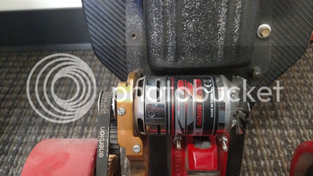

Just wanted to throw up a quick post of my current ride until I get this one up and going.
It started as an eBay special with a homemade housing.
It held up well all of last year around campus. However, since I have decided to sell it to help fund this build I decided to give it a quick revamp. I wrapped the board in some of the most realistic carbon fiber vinyl I've ever found. I also add in an awesome vacuum formed abs cover which I bought off of psychotiller.
Specs:
-42" deck
-carbon fiber vinyl bottom
-vacuum formed abs enclosure (sealed up water tight)
-6s3p lipos
-Hobbyking 150A ESC
-Turnigy SK3 5065 280kv
-Voltage display
-Tractor Supply Ignition key
-XT60 charge port
-Red 83mm flywheel clones
-Enertion drive kit
-Red Caliber trucks

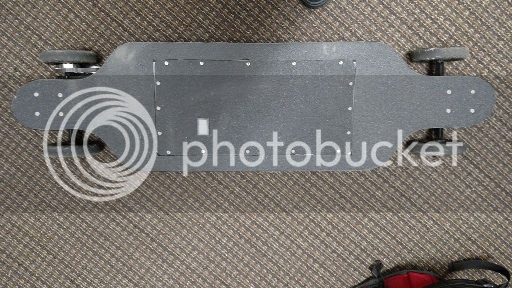

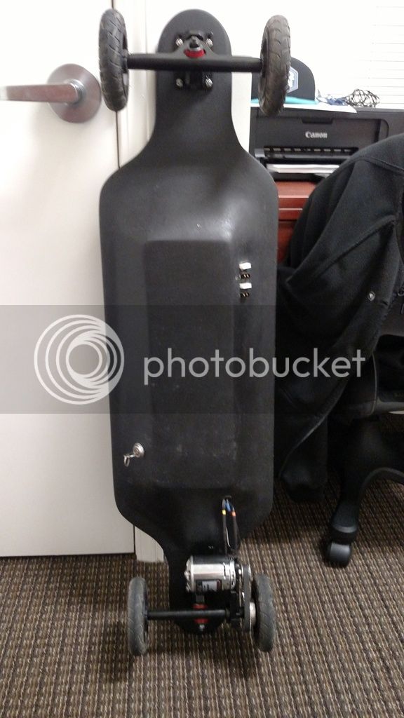

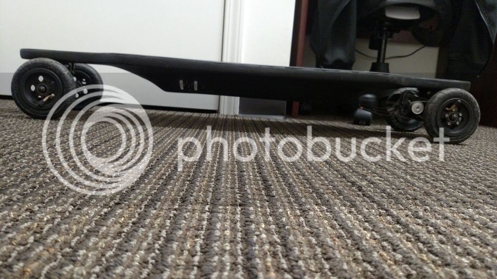

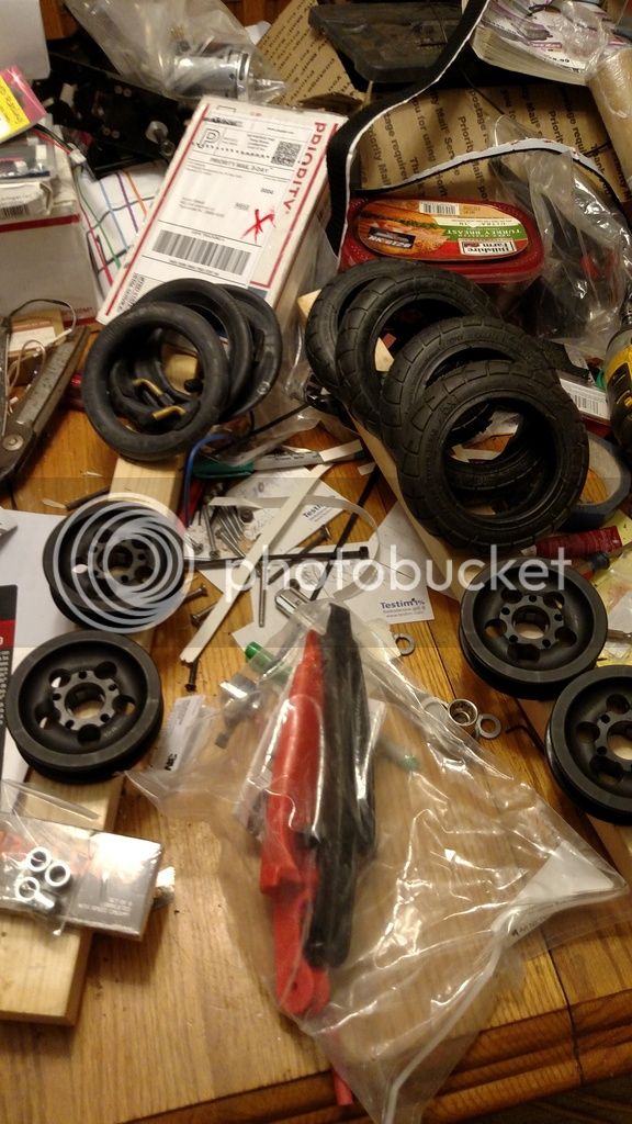

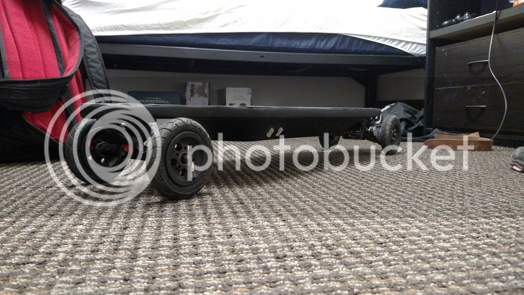

Hello everyone I'm back with more updates! The board is up and running (only single motor for now). I did a little run up the hill at the house last night and I am loving the 5" wheels and the 6374. This thing actually will accelerate up hill where my little 5065 would just slowly die. For the paint on this board I went a little different direction then everyone else. Since I plan on taking this board off road some I wanted something that would be tough. I decided to give some bed liner a shot. I found some Duplicolor Bed Armor at my local O'reilly's auto parts and used that. I did three coats of bed liner waiting about 15-20 min between coats. I did not coat the top of the board because I was unsure of how the grip tape would stick to the bed liner. After I let the bed liner dry for a few days I went over the whole board with some Minnwax gloss clear coat on the top and bottom. I did three coats of this as well. The bed liner by itself came out pretty flat in finish (which I didn't mind) I was worried about it having alot of texture since most bed liners do. I was pleasantly surprised to find that it came out as smooth as regular paint. The clear coat gave the bed liner sort of a semi-gloss look to it. Combine all the hidden electronics, black board, black wheels, and black motor mounts/ trucks this thing looks super stealth. My dad has named it the "Concealed Carver", I think it fits the board pretty well lol. On to the pictures!!
This shows a layout of everything that comes with the urban 5 hub kit from alien drive systems, along with the optional tire changing tool which I highly recommend. The kit came with 4 hubs, 4 tires, 4 tubes, a pack of bearings, and a pack of bearing spacers. Richard has done a great job with this kit and I absolutely love the 5" pneumatics over the 83mm urethanes feels like there is a cloud on each corner of the board. Also love the way the pneumatics cut and carve. These things are super responsive and the board just instantly goes where you point it. I think everyone needs 5" pneumatics!!!!!!! Sorry for the messy work bench but hey don't all DIYers have messy benches somewhere!?!
Top view shows the board with grip tape and the hatch on. Not sure why the back wheels look weird in this pic they are actually straight lol. While I wait on my second hub adapter and wheel pulley to come in I decided to try front wheel drive since my last board was RWD. I haven't ridden it much but initial impressions are it pushes less around corners, pulls you over objects instead of pushing you, board feels better on hard acceleration because of the pull instead of push factor.
Overall view of the bottom. Shows the charge and balance ports on the right for the two 6s batteries and the removable keyed ignition switch on the left. Also shows the finish of the bed liner (board is a little dirty).
These two show an overall height of the board and how slim the enclosure looks. Overall height from the ground to the top of the board is exactly 5.75". Clearance between the bottom of the enclosure and the ground is exactly 3". This is all without any kind of risers what so ever. I should also mention that I get absolutely no wheel bite with this board. I also want to say that I really like the HobbyWing ESC vs my old Hobbyking ESC. The hobbywings startup sequence is much faster, motor noise in general seems quieter, and braking is a lot less screechy than the hobbyking. I would defiantly recommend this ESC.
Overall specs:
-Custom deck
-Caliber 50 degree trucks
-SK3 6374 192kv motor
-16/40 gearing
-Hobbywing 150A waterproof ESC
-Voltage display
-Removable ignition key
-Charge/balance ports
-Alien Drive Systems black 5" hub kit
-Torqueboards motor mount
-FWD (for now)
