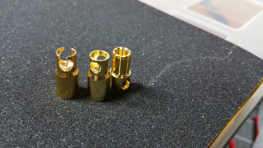

This might be a bit remedial for some of you (you know who you are), but i wanted to show how i built one in case someone else wants to make their own. You can do it easier/simpler, but i had some time to fiddle in the garage and enjoyed making it for my next build.
Starting off with the anti-spark XT-90:
I took some 12/2 wire i had laying around and the copper ground wire works perfectly to bridge the contacts for the loop.
I like modular. If it ever fails or i want to do something differently i can easily swap it out without cutting it out.
6mm connectors:
The slot is so i can squeeze it to better fit/solder.
Mocked up:
Finished with some heatshrink and paracord so i can easily pull to disconnect.
Finished:
Only issue i can imagine is depth to fit. I will likely turn it flat and secure the bottom down. I might also attach a small cord/wire to the paracord loop to prevent it from getting lost.
Nothing too special, but i think it turned out well. I plan to install on my new e-Omen (ongoing slowly).
Hope it helps!

I got some 4mm HXT connectors instead of the 6mm. Would it work the same?

torqueboards   100 MW
Posts: 2940
Joined: May 27 2013 10:02pm
Location: San Francisco, CA
Re: How-To: Anti-Spark XT-90 Loop Key
Post by torqueboards » Oct 18 2015 3:08pm
You don't need to use the 5.5mm bullet connectors. You can also just solder 10awg wire directly into the connector.

torqueboards wrote:You don't need to use the 5.5mm bullet connectors. You can also just solder 10awg wire directly into the connector.
Correct! I mentioned i like modular:
6mm connectors:
So i guess i wasn't totally clear. You can easily wire this in by just soldering directly to the bottom XT-90. I set mine up to be modular so i can swap it or bypass it with just a simple plug/unplug. I made it more complicated than necessary, but wanted that feature so i can swap to another board later, or remove it entirely.

So im still lost. This is how im assuming i would connect it all together. Image
Im just lost. There are 2 input (red n black) from batteries that need to reach the ESC but only 1 input and 1 out for the anti spark loop connector. Do i plug the red wire from battery to the black from ESC? or black from battery to red on ESC?
torqueboards   100 MW
Posts: 2940
Post by torqueboards » Oct 21 2015 11:36pm
This is the direction. The only thing that the loop key does is break the full circle connection.
So when the loop key is removed - your system is off.
When plugged in - you allow the current to flow to your ESC to your motors.
Everything else is just different connectors with different amp ratings to make it happen.
Of course, use less wire and less connectors to prevent more wire bulk in your setup.

sl33py wrote:nice simplified drawings. Torque has you squared away.
the loop key is merely an in-line interrupt on one of the wires. Positive or negative. When removed it disconnects power like a breaker in the open position. When connected it allows that wire to complete the circuit (the anti-spark plug also suppresses the spark when connecting). Simple.
This is only copper wire i have? i just stripped the silicon http://imgur.com/TbWLSej would it work?
torqueboards   100 MW
Posts: 2940
Post by torqueboards » Oct 28 2015 8:13pm
That works. You just need conductive wire. You could even just use 10awg wire.
Of course, you should tin/solder around the loop key to strengthen it.
DIYElectricSkateboard.com Electric Skateboard Kits
camyboy   10 W
Posts: 67
Joined: Oct 05 2015 7:45am
Post by camyboy » Oct 28 2015 8:39pm
torqueboards wrote:That works. You just need conductive wire. You could even just use 10awg wire.
I tried before like u told me and http://imgur.com/rngfZTT. The cable is too thick. just gonna heat up the end to remove the cable and try the copper
