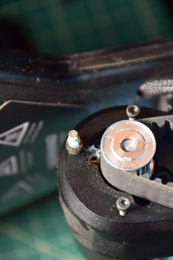

Belt looks like a HTD5 15mm x 225! Will be getting some spares from polybelt (inexpensive, and super fast (in the states)).
Gears - 30t wheel gear.
12t motor gear!
Nice carbon fiber wheel spacers. Also some solid engineering on the wheel hub incorporating the bearing to the outside of the gear instead of bolting it to the wheel. Ingenious!
One of the two tension screws - finally one with some serious loctite!

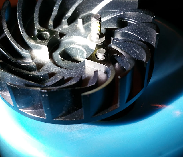

So speaking of loctite - here's the currently infamous cooling fan bolts that seem to vibrate out.
yellow dot is the loctite (or thread locker of some sort)
M3 x 11mm? Not sure of thread pitch.
i took the motor cooling fan off and am 99% positive i know exactly why these things are falling off!!! Loctite placement is too high on the threads and not engaging the threads into the motor... so they vibrate loose and fall off while riding. So simple and easy to spot...

Bolt size is M3 Thread, 12mm Length, 0.50mm Pitch
Yea they should have went with a 63mm motor...

Aren't you suppose to be measuring the thread of the bolt only, not including the head? The motor pulley isnt keyed?

LOL.. You would suppose with a big batch like that they would key it. Don't see why you wouldn't.

I know. Pulley is not even completely on the shaft. The shaft is too short.
You can see this video from the same guy above that the pulley is already misaligned.
In fact, they should support the shaft by putting that end through a bearing.

awh, sucks that its already broken :(
Uniquely it uses the bearing on the inside of the wheel hub and eliminates bolts on the outside of the wheel.
thats more copycat than unique - evolve uses that on all street setups since forever. :wink:

Pediglide wrote:I know. Pulley is not even completely on the shaft. The shaft is too short.
this guy just needs to slide the motor mount away from the wheel a few millimeters, easily done, but he'd rather make a youtube video and whinge about it. lol
das it mane.

maxchilton wrote: this guy just needs to slide the motor mount away from the wheel a few millimeters, easily done, but he'd rather make a youtube video and whinge about it. lol
agreed. 5 minutes and i'd have this fixed. Annoying - absolutely. But easy to fix.
I am bummed that i had to send the board back. BUT i also understand this is basically a beta product and they are still working stuff out. I'm ok with that to a point. I'm being patient and they've been very helpful and communicative. Can't fault them. I see everyone bashing and am trying to remain reasonable. Hardware fails... I wish it were software as i'd probably wait for the app to get logs and push a fix to it, but this looks like a simple HW failure for whatever reason.

Forget who it was who designed it now (someone here at es) but there's a similar wheel pulley design with a bearing that sits in the abec11 you can get from imaterialize.com It is a nice design but he said there's really no need to even put the bearing in as its a tight fit and stays put with the motor mount against it as security. You would have to cut down the hanger with this pulley as well if u insert the bearing. I have two of them if anyone is interested. 20$ have to go with the real abecs
12 tooth pulley. That's small. If the motor mount is short and therfore the c to c distance is short it will be too small of a pulley according to the c to c calculator as enough teeth won't be engaged. But that's just what the calculator says and maybe it's not really a problem with the torque it experiences
