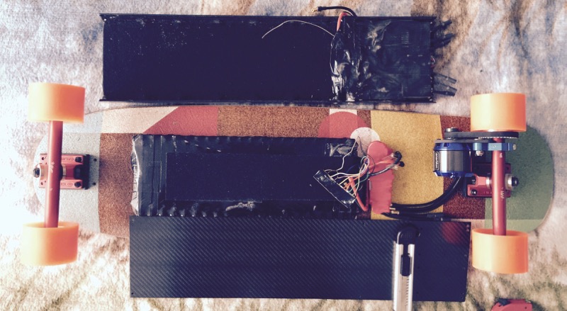

thanks to the heavily reduced electronic package with the same DIY 10S4P TopSpeed battery, I can run a 45x15cm case instead of the topspeed 60x15cm case!! its insane - check out the comparison of the large topspeed case vs. the tesseract form factor (case not built yet).
comparison of the 2 boards and cases:
my topspeed rear section is 2 giant torqueboard escs, 1x giant high current switch, receiver, cables. my tesseract rear is only 1x vesc with directly attached nunchuck receiver and future loopkey switch:
only the tesseract next to the giant topspeed case :)

pretty minimalistic electronic package - dont think you make make it much smaller and lighter with 40x 18650 cells:
cable setup done, lots of soldering and rearranging. usb port and motor connectors exit in the back and can be accessed without removing the future case. at the side I used an XT60 instead of an XT90 loop key as on/off "switch". XT90 seemed a little large compared to the fairly weak connections everywhere on the vesc. it most certainly wont be the limiting factor when it comes to current at least .. limited VESC current to 30A max too cause I dont trust that little box without any heat spreaders fully yet. nunchuck receiver is now fully heat-shrinked too. gave it a quick spin through the apartment. :)
blcd mode worked flawlessly, FOC 2.7beta wasnt working well with the nunchuck yet though - some irratic behavior. the few times I ran FOC it really impressed me though ... soo silent, its amazing.
glimpse of how it will look in the end: pretty smooth! :D just waiting for the rubber tubes and aluminum L-profiles for the sidewalls now. Im tempted to sink the electronics slightly into the board, since its stiff enough to hold up. now sure how though, dont have the tools for that kind of operation right now. :?
