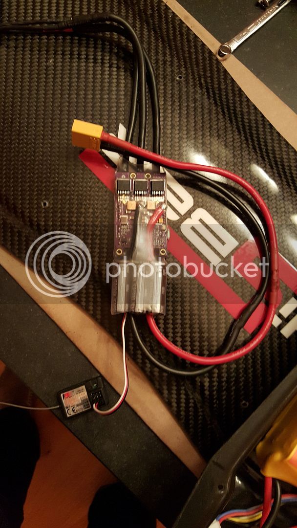

First, I want to publicly thank Chaka and Psychotiller, both of whom provided beautiful parts and exceptional customer service. Their help was critical to my success; this was my first build, I have no prior experience with electronics, and I have only a high school knowledge of electricity.

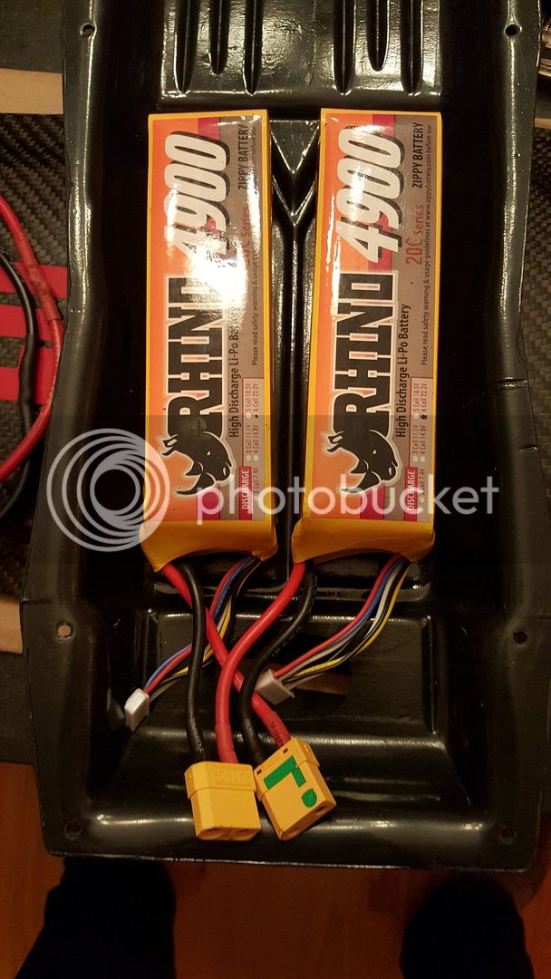

I did a few things I think are a little unusual. First, to get 12S efficiency and power somewhat conveniently, without needing an expensive 12S balance charger, I wired the batteries like this:
I connect the plain XT90 to the VESC and use the XT90-S anti-spark connector with a loop key. Of course, the loop key puts the batteries in series and acts as a power switch. To charge, I remove the loop key and disconnect the VESC and charge the batteries at 6S, with a parallel charge harness and IMAX charger.

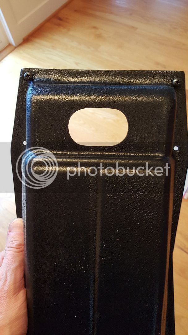

Second, to reasonably conveniently access the connectors, I put a hole in Psychotiller's enclosure.
And use a Jeep body plug to plug the hole. The hole is a little tight, so I might expand the hole and plug it with a Ford body plug, instead. But this is it for now.
Finally, for safety and vibration insulation, I put the batteries in LiPo charging bag. This picture was before I changed to XT90 connectors.

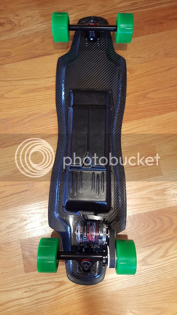

The result, before finalizing wiring, flipping the motor mount (for protection), and raising the motor's position (for clearance).
Results:
I'm extremely happy with the result. With 15/36 gearing, the top speed is over 30 mph and it rips up 15% hills, which are as steep as I encounter. At 14.5 pounds, it's not as light as I'd hoped, but that's the price of power, range, and the comfort of big wheels, so I can live with it. My only point of comparison is a Boosted Dual+, which just didn't have enough range for my commute (so I returned it inside the 30-day return period). This board is cheaper, faster, lighter, climbs hills better, has (much) better range, and a more reliable remote connection. It's really better in every way except charging convenience and braking (due to one wheel drive).

your motor is way too close to the ground. I think it would need more clearance.
Thanks. Regarding motor height, that picture was taken during assembly; I raised it before I rode it.

Love the build!
Why did you turn the motor mount upside down again? The rounded part of the motor mount is slightly larger than your motor for a reason you know? It's to protect your motor from making contact with the asphalt. :wink:
Actually, I figured that out when I took the picture with my dog in it! :oops: I flipped it and raised the motor before the first ride.
