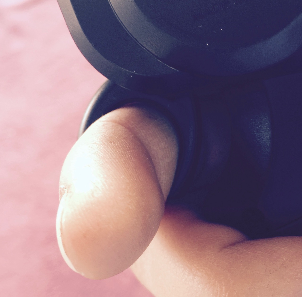

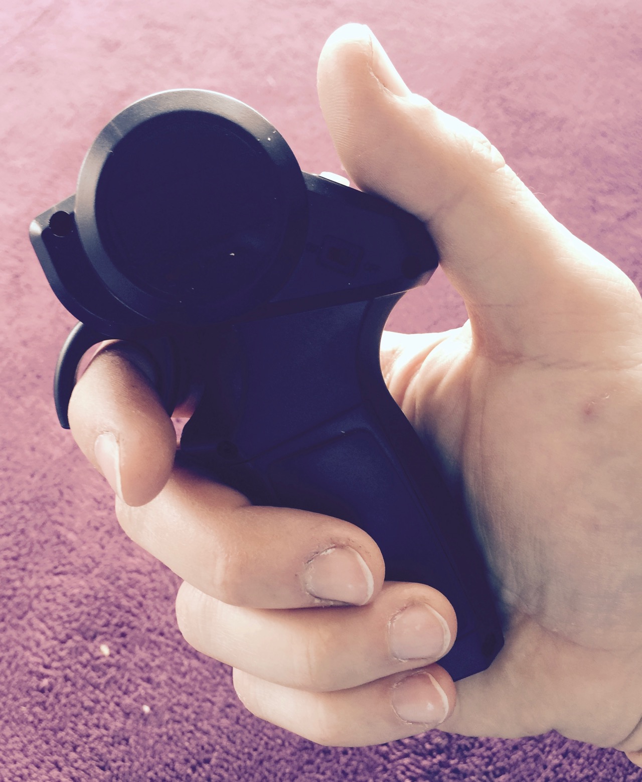

hey guys, months later than the rest, I also tried out that mini-remote that Ive seen first tested by dexter (diyelectricskateboard) and then heard about by more and more people. well, I wish anyone wrote a little bit about it, because that really wouldve saved myself some money.
long story short: the remote and the trigger is too small. my hands are average male hands, not particularly small, but also not extremely large. Im average build, 80kg, my fingers arent fat at all and still my index finger barely fits into the trigger. if at all, I can only stick it through near perfectly perpendicular to the trigger direction (which is not my favourite relaxed position). also the whole remote feel about a cm too short for my hands.
check the pictures, it might save you some money too. gt2b with badwolf or DIY like okp is still the way to go imo!
its really short, my pinky finger barely fits the grip
hnnghhh *squeeeze* poor index finger, this is really made for children or tiny chinese hands :P

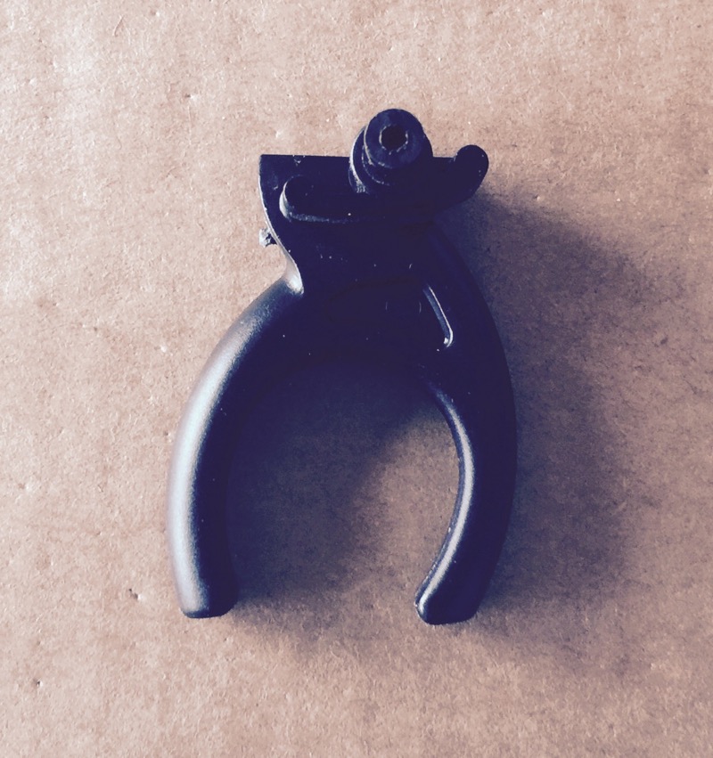

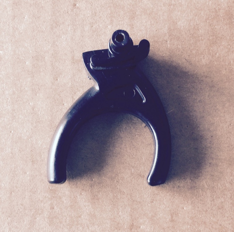

I also had a problem with the trigger being too small. My solution was to take apart the remote, remove the trigger assembly, use a heat gun to soften the trigger and widen the opening. Only bend and reshape the outer arm on the trigger.

first I wanted breakfast but then I skipped that and quickly tried my luck with the heat gun. really valuable tip, the remote got a LOT better for me! thanks a lot :D
original:
after heatgun-bending:

Glad to see it worked out. Looks like I bent mine a little more than yours. With mine I was trying to duplicate the HKGT2B's trigger opening.
