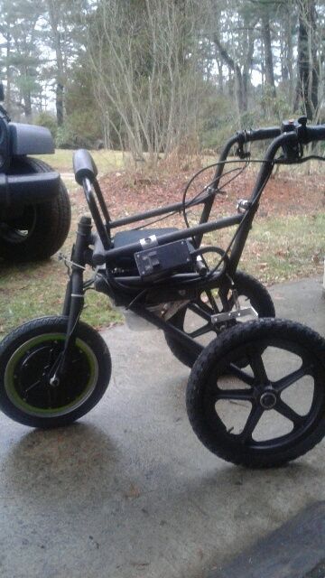

Postby speedmd » Fri Mar 17, 2017 11:33 pm
Customer I built the prototype for has placed ads for it so safe to show one of my early photos of the near complete working test unit.
This was a quick and dirty (conduit and old junker bikes) test unit to try out some concepts and get measurements - make changes from. Powered elevator seat and cable steering worked out well. Lots of changes planed for production units, but overall the customer was very pleased.

Postby Flexscoot » Mon Mar 20, 2017 5:28 am
Nice rig!
Your hubmotor seems nice (is it a geared motor? what is the wheel diameter?)

Postby speedmd » Mon Mar 20, 2017 8:22 am
Thanks. I gave a standard wheel barrow balance board direct drive motor a try and it worked out well. It is 36v 14". A bit heavy unfortunately.

Postby Ianhill » Mon Mar 20, 2017 6:17 pm
Looks very functional and unique, the lift out seat is a gem all the weight is over the axle very good design.
Can the front wheels be locked so it can not move when the lift mech is getting you out ?, simple wheel chair type be sufficent.

Postby speedmd » Mon Mar 20, 2017 9:42 pm
Thanks Ian. It only has a barely functional brake on one rear wheel for the testing and ad shoots. It works ok but we spent only a little time- money on this as it was left off the original prototype request and added after we were happy with the overall drive function. Production unit will need two wheel brakes with locks and a seat use - motor kill switch. All the old timers I showed it to are now after me for one. :P
