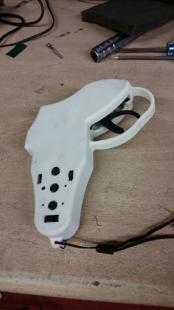

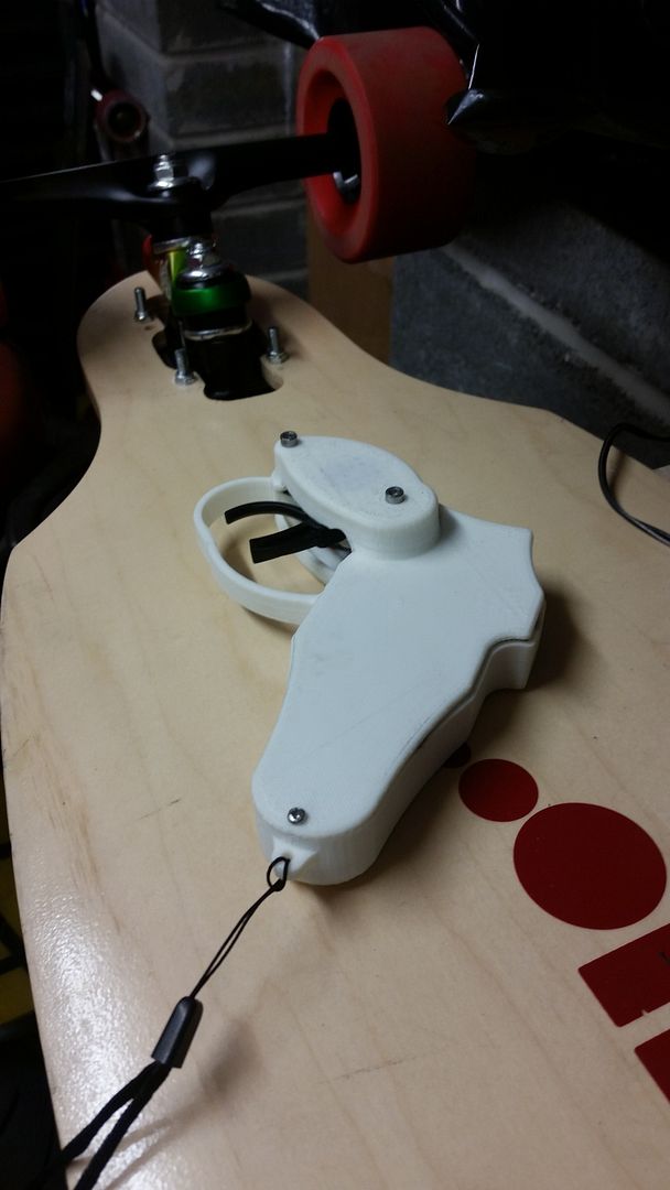

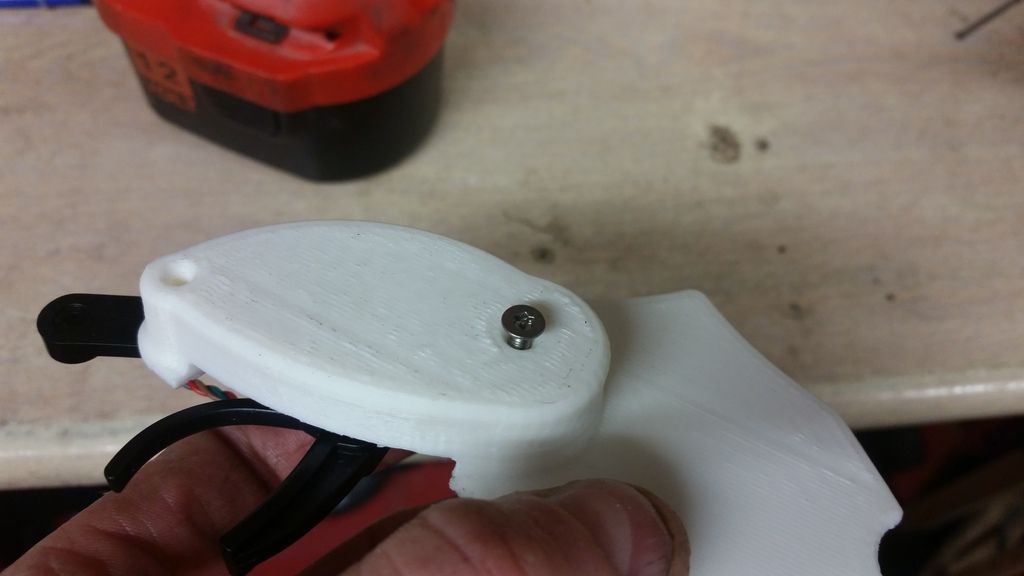

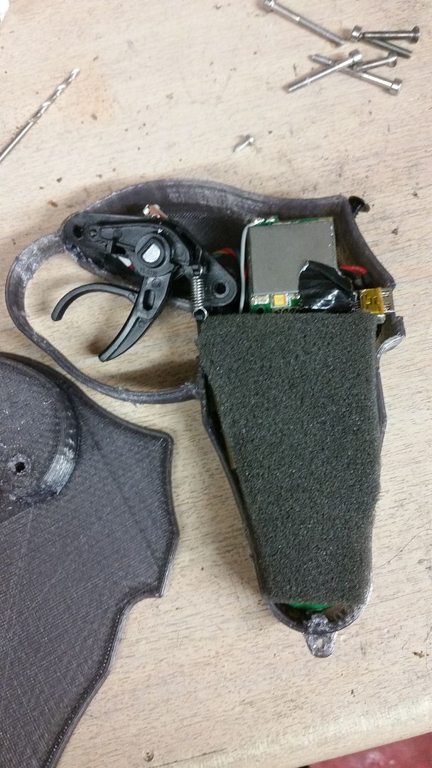

Hi All

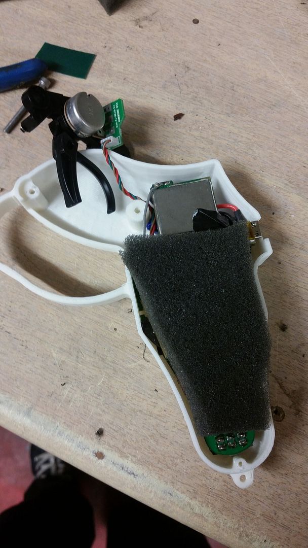

Here are the STL files for a hand control enclosure i have designed for the Flyskygt2b - this allows the use of the original battery (if you remove the rubber packing around it).
http://www.thingiverse.com/thing:1625376

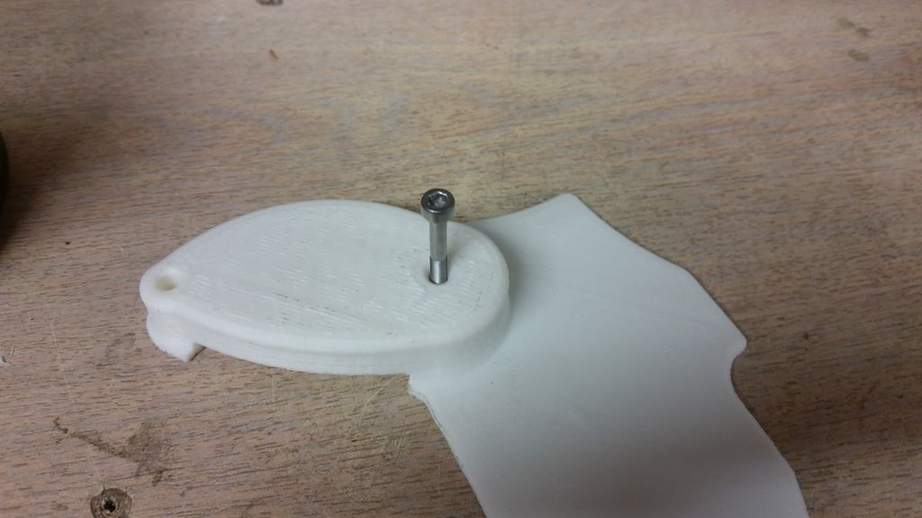

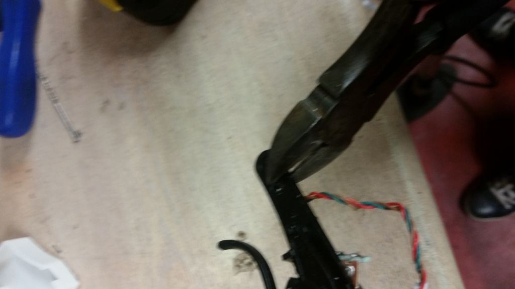

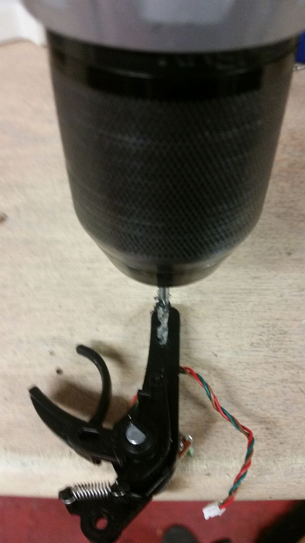

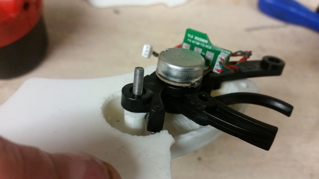

You just need to trim the trigger mount and drill a hole to take the 3mm bolt..
then it should all fit in nicely..- a very comfortable remote to use..
