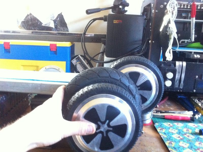

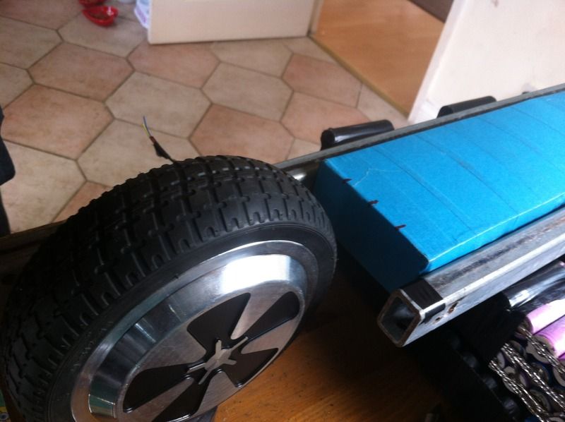

my daughter has a scooter but it has a brushed motor i got hold of a couple of hoverboard wheels there 350watt each.
i was thinking of fitting one to the rear of her scooter and see how good they are. anyone done this or any idea what the speed might be. i have ordered a 350watt controller to test it out.
Ianhill   1 MW
Posts: 1994
Joined: Sep 25 2015 5:55pm
Re: hoverboard wheels for scooter
Post by Ianhill » Jul 09 2016 6:54pm
Ive been wondering how these would perform with star delta switching and maybe electrically and mechanically connecting two together for a few kilowatt of power in delta mode.
If they were put back too back flip the phase on one and match the halls to suit use on a single controller the two wheels would act as one motor with a fair kick in delta I bet it would go over 30mph with 48v easy.

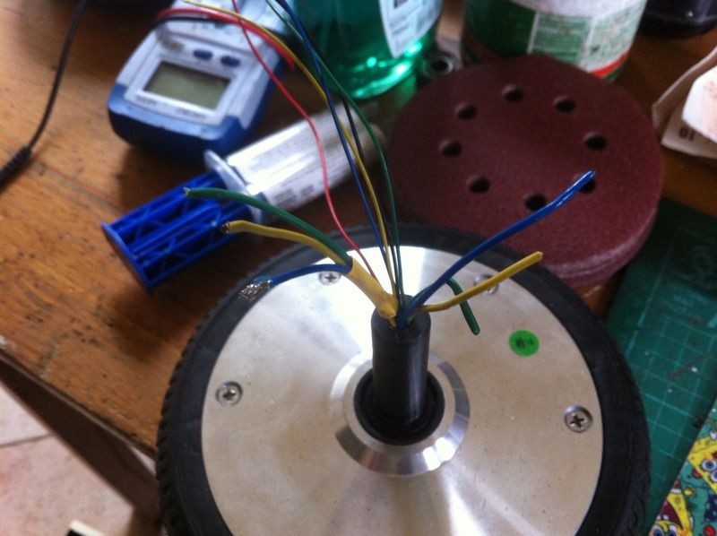

i was looking at switching star delta but i would need 6 wires coming out the hub and the hole in the shaft is small the shaft is 16mm and the hole is 7mm, but i might see if i can drill it out amd give it a go.
2 speed sounds fun :D
Post by xadmx » Jul 11 2016 1:57am
Ianhill wrote:Try and find some small changeover relays and fit them in the gaps near the centre of the hub the only extra wires u will need then will be live and negative to activate the relays.
to my surprise i did get the 6 wires in the hole, i had to use the wire that was already on the motor because its teflon coated and very thin insulation, (anyone no where to buy this wire) but it will do to test it out :D

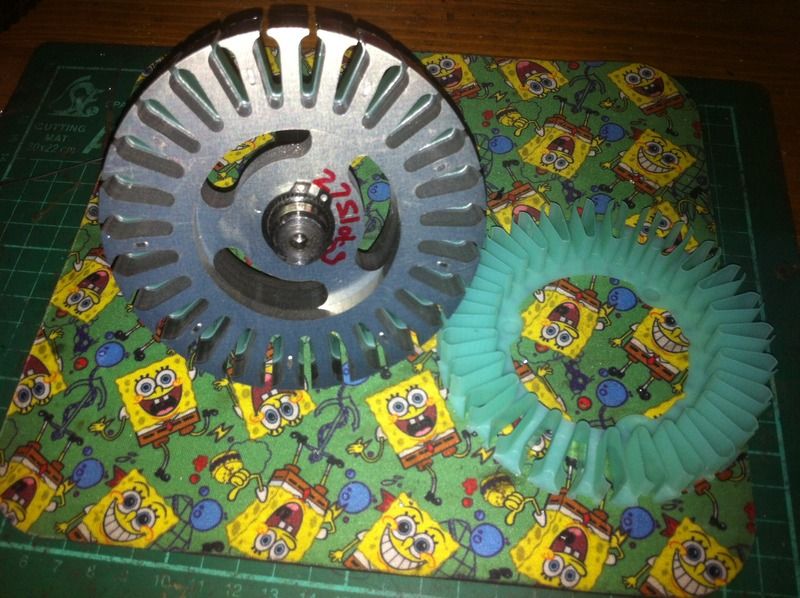

Post by xadmx » Jul 12 2016 5:35pm
i am rewinding one of the wheels to test.
the hubs are 15 turns 4 stands 0.3mm wire. aaabbbcccaaabbbccc
Ianhill   1 MW
Posts: 1994
Post by Ianhill » Jul 13 2016 8:21am
What winding pattern are u planing on using ? What's the end goal maybe thicker strands and less windings for a bit more rpm and current handling while still using the delta wye switching ?
xadmx   1 kW
Posts: 335
Joined: Feb 18 2013 8:17pm
Location: uk

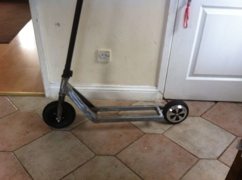

Post by xadmx » Jul 13 2016 10:52am
Ianhill wrote:What winding pattern are u planing on using ? What's the end goal maybe thicker strands and less windings for a bit more rpm and current handling while still using the delta wye switching ?
i am going to use the standard one for delta/wye for testing but i thought i would rewind one and try it with my 1000w controller just for fun.
i have started making the deck. i was going to fit it to my daughters scooter but it will be ust as easy to make a new deck then i can make it to size for the batteries and controller to fit under the deck. i was on the way to the shop last night and someone had put a scooter out for the scrap man. it had missing wheels but now i have the handle bars and headset bits. plus my front wheel come today it is off a razor 100 scooter.
i am going to weld a nut onto the box section so i can slide the wheel in and lock in place. quick and easy wheel change.

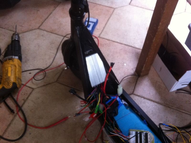

Post by xadmx » Jul 16 2016 11:07am
torqueboards,thanks
started putting this together i should have waited for the controller as the fit is really tight, but for my fist one it will be ok for the prototype.
i just sprayed it with mat black for now i didn't even sand it down very good so it looks rough close up. but i just want to test it out then make i super clean one.
Ianhill   1 MW
Posts: 1994
Post by Ianhill » Jul 16 2016 12:34pm
Its coming along great very compact and well thought out, hope your skinny mind if you want to tackle any inclines but it is very stealthy in black it could be easily mistaken for a UK legal push scooter if the design on the rear wheel didnt give the game away look forward to hearing how she rolls.

just the one onn the back, these have a bit of power so i am doing a disc brake conversion just in case.

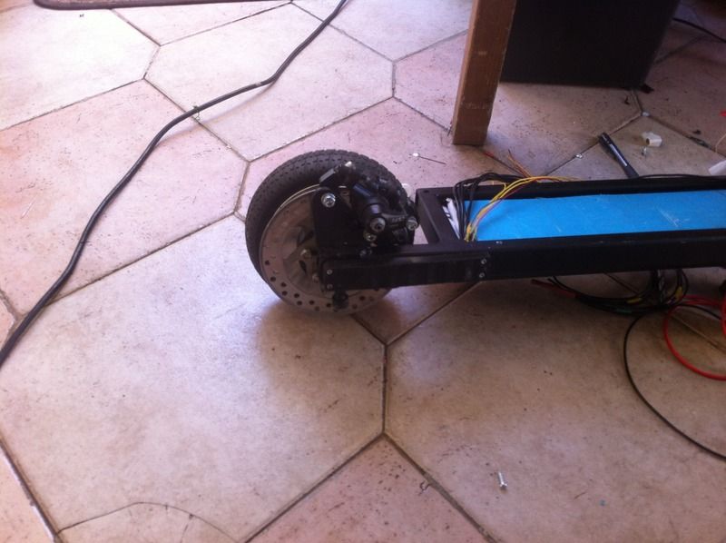

Ianhill   1 MW
Posts: 1994
Post by Ianhill » Jul 17 2016 10:56am
So prototype the first frame work the bugs out and then do a rewind motor for a faster version ?
The disk brake be best suited to the front with rear e-abs, my scooter had a rear brake only and would slide to a stop eventually, the hubs solid tyre may wear down with flat spots if its skidding about.
xadmx   1 kW
Posts: 335
Location: uk
Post by xadmx » Jul 17 2016 12:33pm
Ianhill wrote:So prototype the first frame work the bugs out and then do a rewind motor for a faster version ?
i am ging to put one on the front aswell but i had to use the ony size disc i had, i have ordered a smaller disc 120mm so will change it whe it gets here but the brake works awesome.
i 3d prited an adapter ad theres loads of room inside the hub for the bolts.
