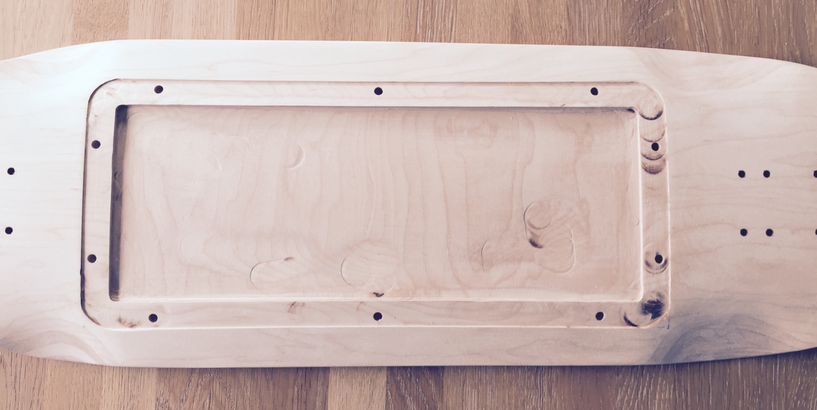

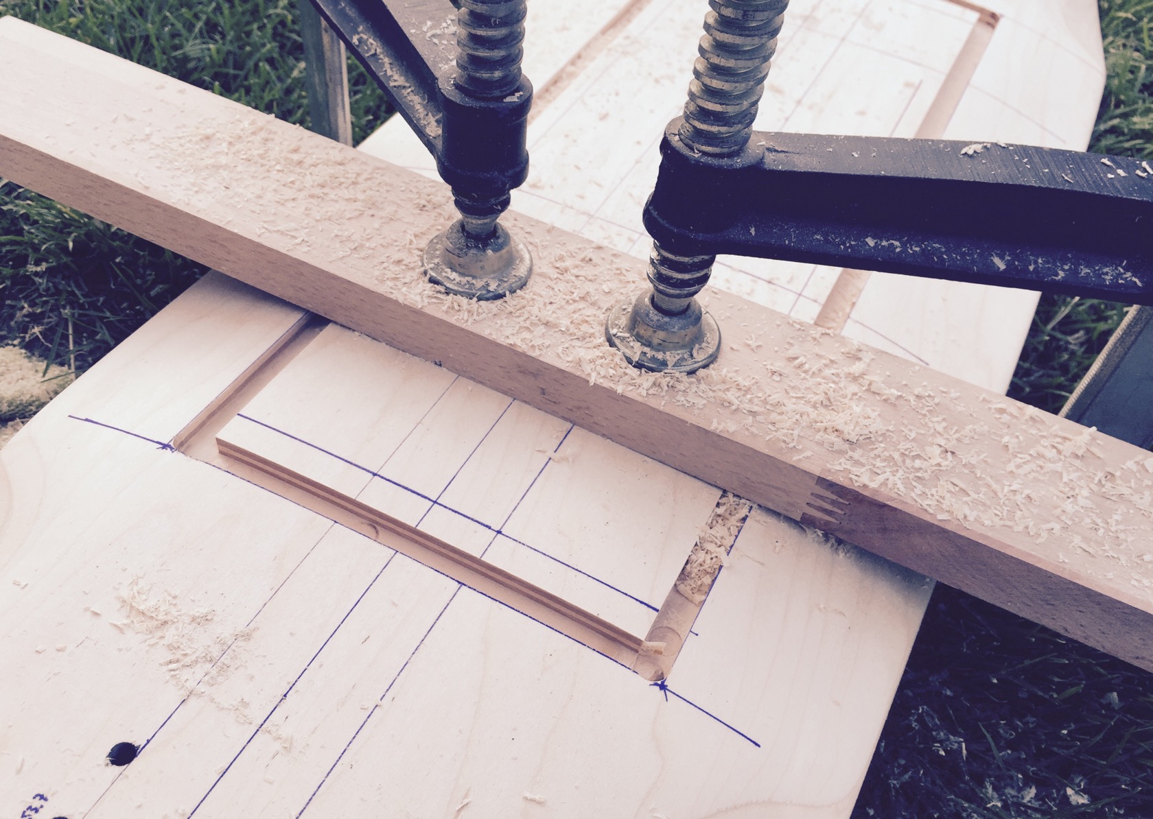

off to routing the electronic compartment - I made some router guide with that straight piece of wood. you can see one routed line there already, nice and straight, much better than free hand routing (which was kinda my first attempt to it a while ago). I carved out wood of 6-7mm depths.
2 long sides done, now the perpendicular sides to have an outline for the rest (which I did with a wider routing bit and without any router guides).
done, some sanding and I called it a good first evening. that 6-7mm depth was REALLY a lot, I think there are just 2-3mm left on the board - sounds really hollow when I knock in the middle region and it feels like I could break the board by hitting the middle hard. gotta need a lot of carbon to restore the structure:

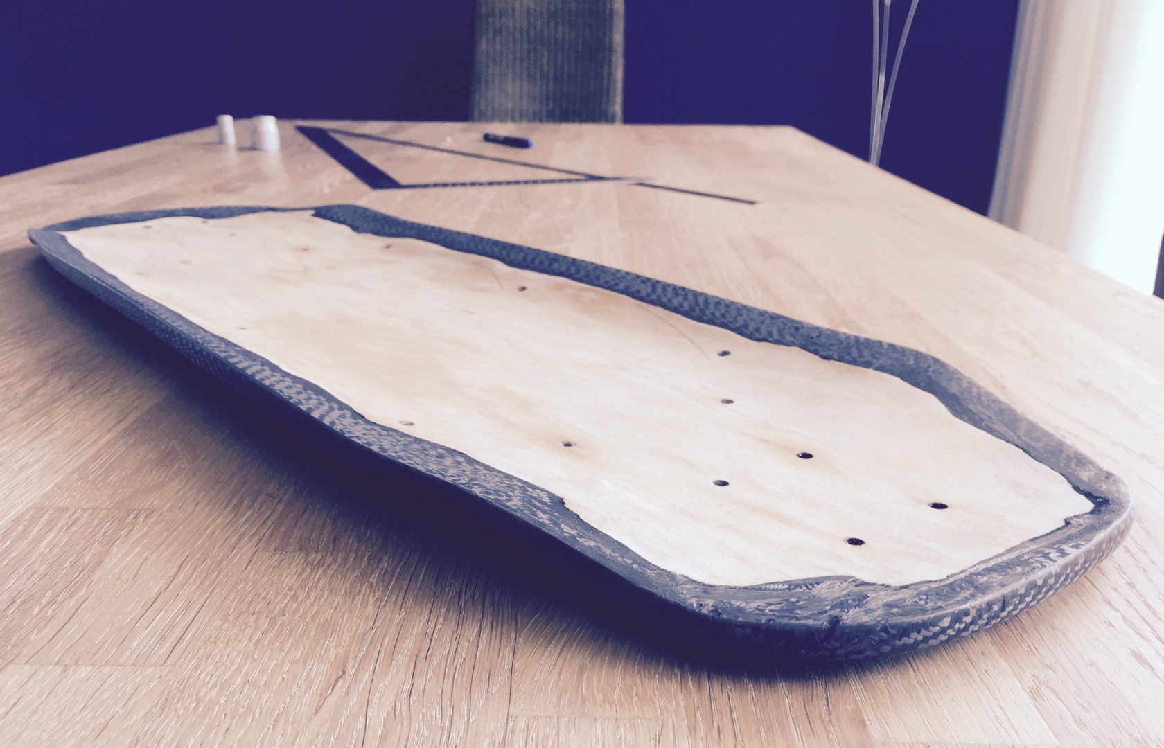

I already noticed when I left the board for curing that the wrapping of the carbon around the board will leave a mess on topside. partly the screws were covered, resin soaked weave everywhere and it wasnt always just flat, but crumbled. long story short: topside WAS a resin crusted mess.
but lets start with the good things! thats how the roadside came out - no sanding, nothing, just removed the breather and bleeder layer.
you can tell its fresh from the vacuum bag from the small white pimples on the carbon. these are the tiny holes of the bleeder layer, where the breather layer gets stuck a little bit.
ok, turning it around ... argh :( this would be a mess for sanding, since from sanding heat, the resin becomes fluid again and then it clogs up your sand paper instantly. also I was super afraid of the screws - looked like the resin actually found its way through the inserted threads and came out on topside, seating the screws nicely.
but I mean, at least the board edges are well covered by the carbon - looking good overall except for the topside mess.

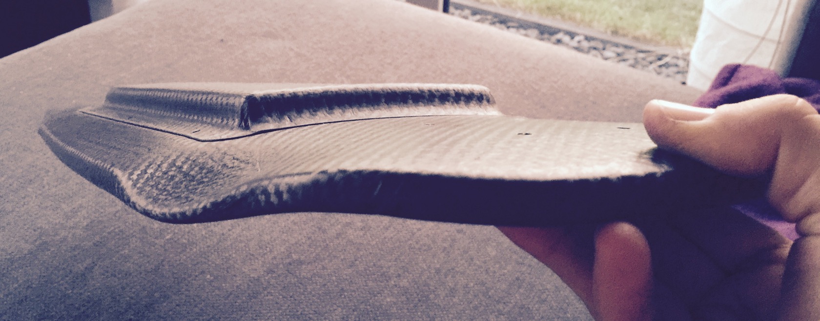

the same evening I started with the enclosure made by a foam mold from 30kg/m^3 XPS foam thats supposed to be a little more rigid than my bad other foam experiences where the foam gave in under the pressure. against all odds and a clearly visible dent through 2 layers of breather, the enclosure came out great!! :)
very smooth top
nice and evenly rounded edges
usually you have these crumbled edges where the bleeder foil is crumbled. no idea how to get around that. its easy enough to sand though!
and a slight concave following the routed compartment. thats the cool part of the hard foam mold - it follows light curvatures just from the vacuum pressure!

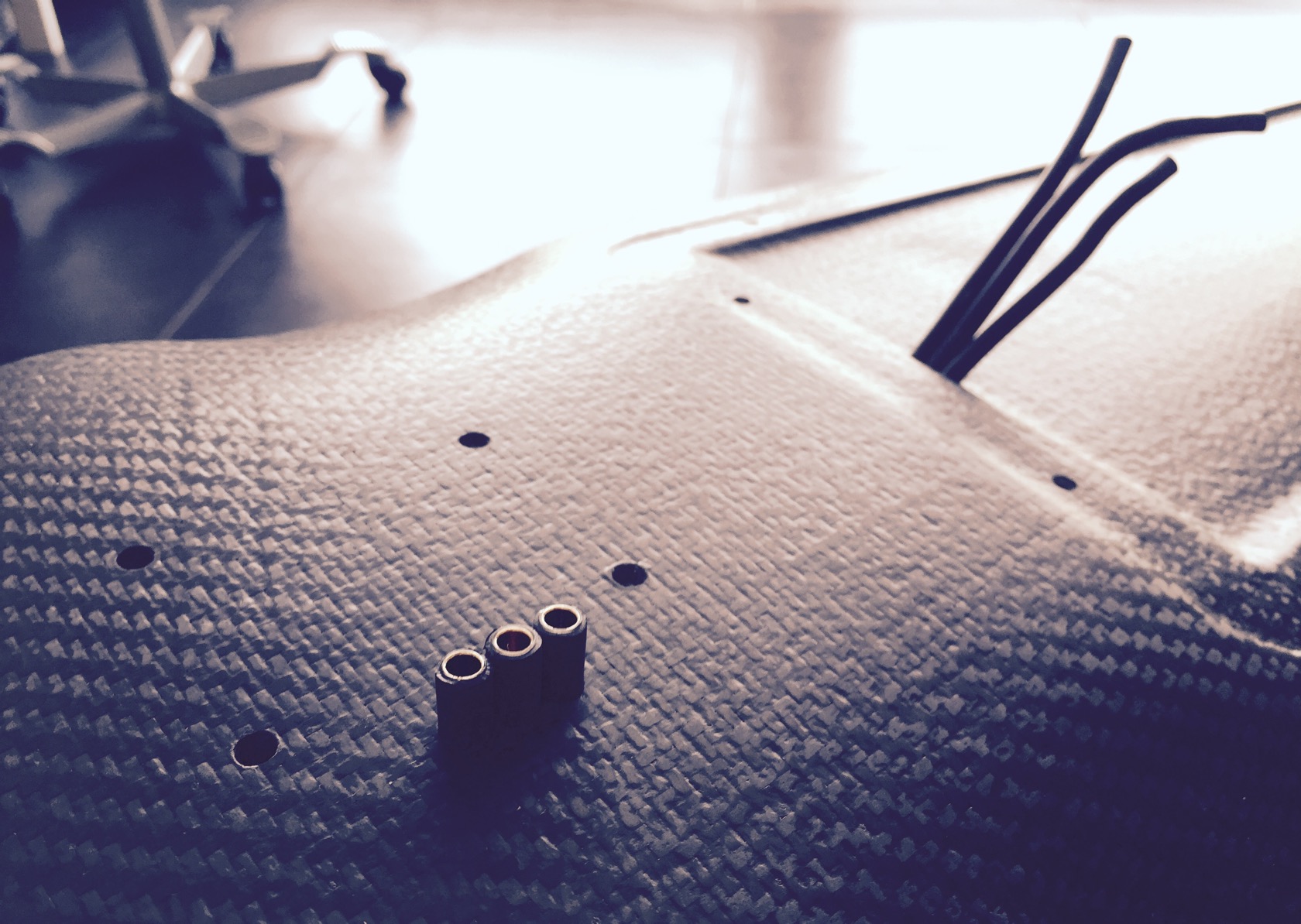

starting with drilling holes from the boards topside right through the boards roadside carbon layers and the enclosure lid with a 3mm drill bit that wouldnt hurt the M4 threads of the inserts. you can spot the tiny holes if you look closely! I left the foam mold on the board so you can have a look at it - its very simple, all I did was cutting a correctly sized rectangle from a larger industrial XPS foam plate and rounding the edges a little. note how I also rounded the boardside edges because of the rounded edges of the carbon compartment in the board - the vacuum bag will pull the foam down to the ground of the compartment and bend it smoothly around the mild concave - but for that to happen the foam piece had to be a perfect fit for the rounded carbon ground!
frock yea, you can see right through all 10 holes WITH the enclosure attached!
and the m4 inserts are perfectly hidden under the carbon:
enclosure is a nice fit, it actually sticked to the board from the adhesive effect of water alone
transition board surface <-> enclosure is ok, I couldve cut the lid a little slimmer, but didnt want to cut too much around the drilled holes.
note how the texture of the enclosure carbon perfectly transitions into the texture of the board carbon 8)
its really slim

finally working on the motor wire channels on the boards top side. started with drawing - this time no silly rectangular shapes but something that the 3 parallel wires can actually follow:
exiting right next to typical rubber pads, which are a little wider than most truck baseplates:
routing, this time by hand since the geometry and the router base plate didnt allow to go with reasonable guides. it was quite messy, because with the big router baseplate, I routed a lot of different and varying depths, so I had to adjust height frequently, reroute, repeat. a little annoying and not very surgical like my electronic compartment. but it works and wont be visible anyway, 3x 12AWG wires in!
and they exit directly in the electronic compartment:
