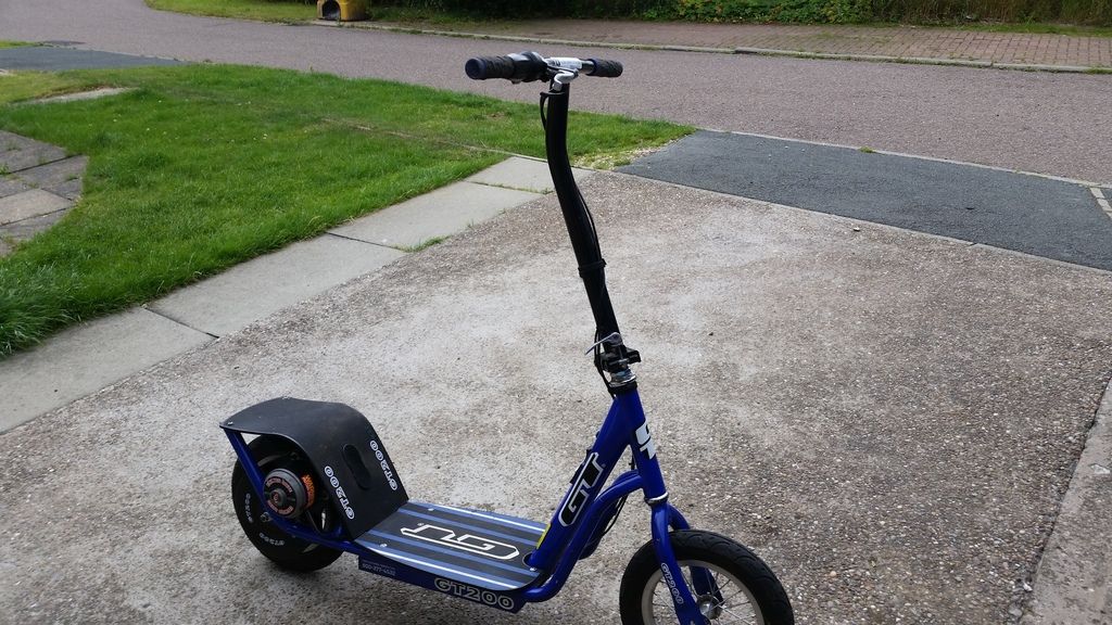

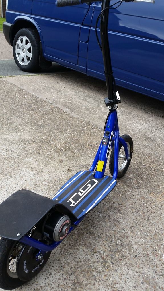

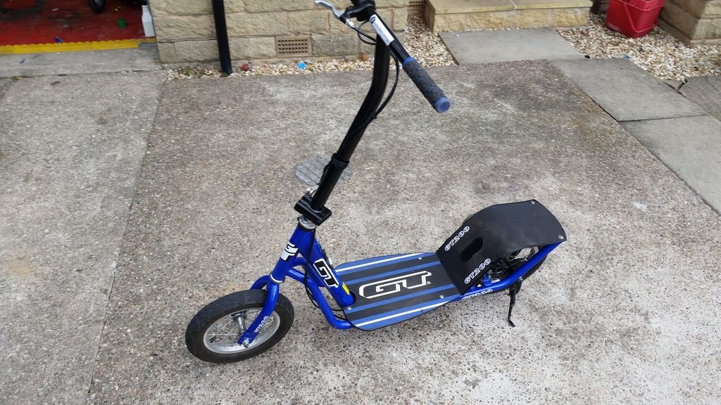

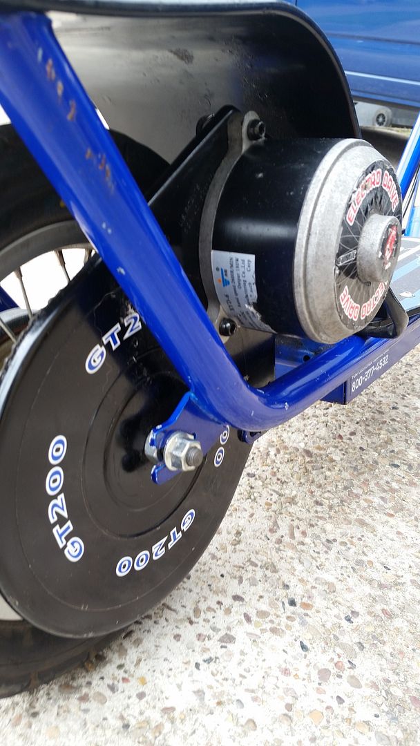

nice work- im thinking of converting my GT 200 scooter (which looks almost exactly like yours ..) already upgraded the Lead acid to a 7s lipo but kept the original motor and controller
ill probably use all the electronics off my broken E-scoot so 10s and 6374 motor
..it will be more than enough power i suspect .. just need some high ratio gearing ..
