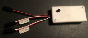

Hi All,
I was hoping that someone could shed some light on to a problem I'm having with my throttle.
My throttle set up is this:
Throttle: http://alienpowersystem.com/shop/electr ... ll-effect/
PWM Chip: http://alienpowersystem.com/shop/rc-ev- ... face-1-4v/
ESC is: http://alienpowersystem.com/shop/esc/al ... et-esc-hv/
The problem is 100% of the power is applied at about 50% of the available thumb throttle travel, this means that it is difficult to modulate - this can be seen in the video I posted of my build. So when riding it, after 50% of the throttle is applied the scooter seems to be going as fast as it can and the rest of the throttle travel is just dead.
I checked tonight that the hall effect throttle is indeed a 1-4v output (thought that it could be a 0-5v by mistake) but the multimeter confirmed the spec.
Would this happen if the PWM chip was actually the 0-5v version by mistake?
Has anyone encountered anything like this?
- Keith

I've come to the conclusion that the interface chip isn't working correctly. Seemingly is uses 2v as 100% output. The throttle outputs 1-4v correctly and the ESC works correctly when connected to a RC car receiver.
I have told alien power systems that's where the problem is - let's see what they say!
Perhaps this is an opportunity for my to practice my arduino skills??

Postby Keith_hill » Mon Jan 23, 2017 3:21 pm
As I mentioned in my main scooter build - I have solved my throttle interface problem.
Here is the thing I have ended up with, it is Arduino nano based and has a rotary POT which is set to alter the maximum servo angle PWM output. it is really useful when letting someone have a go and slowly build up the 'power' level. I also find that I set it to 50% for using the scooter on pavement around people etc..
I have also set a 30ms count up for throttle output vs. throttle demand. It helps with the initial power take-up as the ESC is simply requesting the motor to hit a requested speed with 100% current. (fine for an RC car but a bit chaotic when stood on the blood thing!)
I'm going to shrink it down when I manage to get a digispark to correctly handle servo output. the whole thing will be about half the size.
