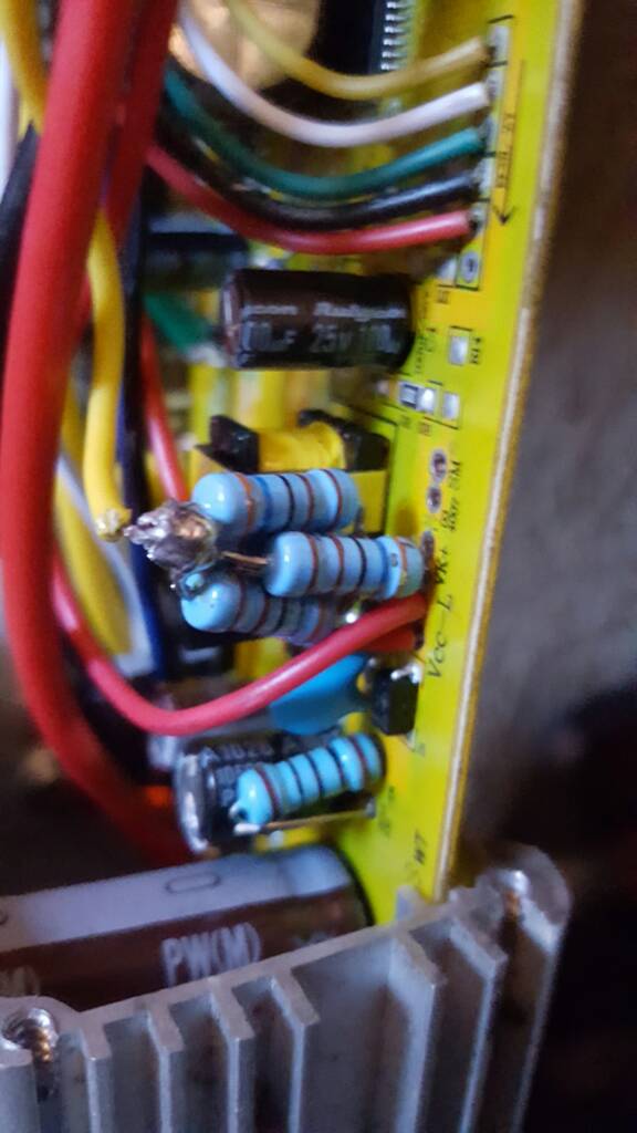

I have a 48v system and I'm trying to figure out how to wire the brake light. The lightning system runs on 12v. From the light there is ground, running, stop light. The Ebs outputs 48v
I have a step down but I'm not sure how to wire it if I have already my running lights and accessories hooked to it. Do I get a separate step down just for brake light or run a relay. I know a bunch of scooters do it with one converter but I don't know how to wire it.

Some controllers have a high level EBS input that takes pack voltage. If you have one of these, you could run pack voltage to the brake lever switch and on the output feed the high EBS pin and the input of a small 12V dc-dc converter. If the brake light current is low enough, you might get away with just a big resistor instead of a dc-dc converter.
I had the idea of a resistor not sure how big of one. The controller does have an Eb light option of 48v.
If i can go with a resistor it would be the easiest route or I can go with Teklektik route. Link for reference (https://endless-sphere.com/forums/viewtopic.php?f=2&t=75171)

Ok got it. I used 4 of 3.6k resistors which dropped the voltage enough to not blow the leds. Here somewhat a schematic that I created.
And the resistors
Best part it was all parts I had.
