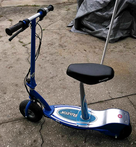

I'm planning a build for later this year and I wanted to test some new fabrication techniques, mainly making fiberglass molds and panels. I picked up a Razor E300 for $10.00 a couple of months ago that I'm going to use for my testing. So, New Year, new build!
Here's the victim:
Dead batteries, crappy 180w motor, garbage controller and a on/off throttle. I could just throw on a new motor and controller and be done with it, but where's the fun in that? Besides, I've already done a few builds like that. I need to set the bar just a little higher this time.

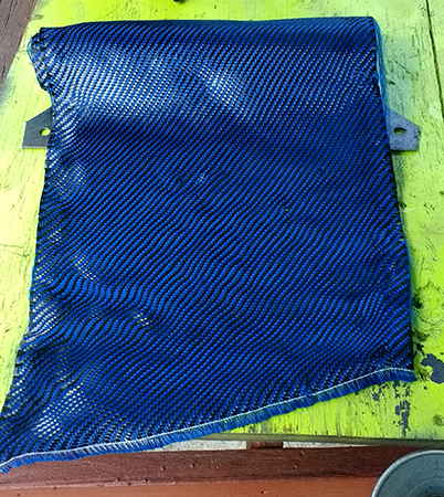

I'm calling this build "Blue Carbon" because I'm going to use some blue and black fiberglass to make the deck:
I ordered the cloth from China. The seller claimed that it's a combination of carbon fiber and fiberglass. However, since I paid $8.00 for 12" x 30" piece, I'm thinking that it's just straight fiberglass. No matter, it looks nice and should make an excellent looking deck.

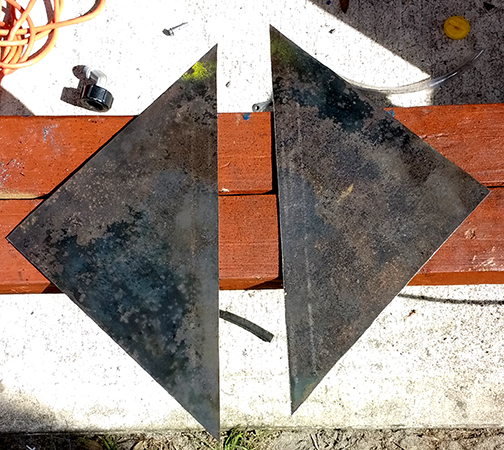

I was at the scrap yard the other day looking for metal when I found these triangles of 1/16" steel:
Normally I prefer 1/8" or larger for a mount, but since I'm trying to keep the weight down, I decided to pay $2.00 and use them. I really love my local scrap yard. They have a literal hill of scrapped lawn mowers, pressure washers, riding mowers and gas scooters. I'll take a picture the next time I'm over.

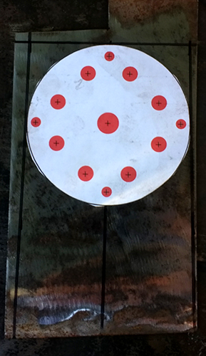

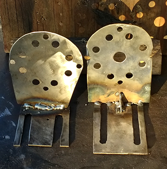

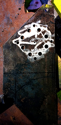

But I decided that I would have too much flex in the metal. I decided to make my "standard" motor mount for a Unite. I have a template that I made up before for marking my holes. I glued it to the steel and used my drill press on the template:
Then I cut out the pieces and welded them:
I might redo the welds. I was using .023 wire that came with my machine. I switched to .030 today and I'm getting much better welds.

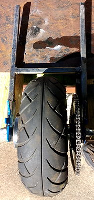

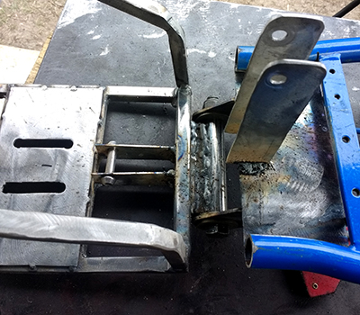

Then I went to work on the swing arm. I cut off the mounts for the rear wheel from the frame and welded some 1/2" square steel tube to them. I used the wheel to make sure everything was lined up properly, (I usually would just use a long bolt for something like this, but I was lazy! ;)).
I then added the mount for the motor mount and the frame for mounting the shock(s), (not sure if I'm going with a mono shock or dual shocks yet):
(Sorry about not having more pictures. I just dropped my Nikon and broke the lens, so I'm using my cell phone. I seem to have lost some pics :().
Right now the swing arm is feeling a little more chunky than I had envisioned. I might make some adjustments to it later.

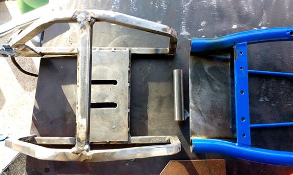

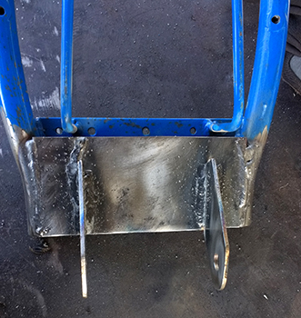

I also managed to weld the connecting plate to the scooter frame and do the initial lining up of the parts so that I can visualize what I want and how I will make it all connect:
I'm hoping to have it all connected tomorrow, but I have some appointments, so I'll see how much I can get done.

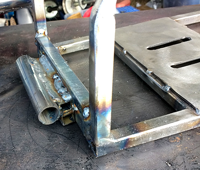

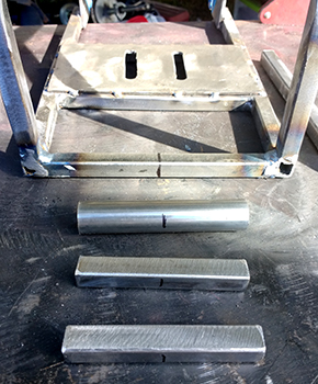

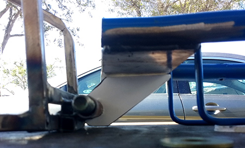

I added the support for the pivot to the swing arm:

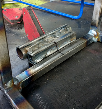

Then I cut and welded the parts to mount the pivot tube to the swing arm:
I needed the pivot to stick out so that the two frames won't hit each other when the scooter hit's a bump. I probably over-welded everything, but since this is a critical part and having the pivot mount snap at any speed could be "bad":
https://www.youtube.com/watch?v=wyKQe_i9yyo
I'm sure that there is a better way to make my pivot. I'll have to think of something better for my V 2.0 swing arm! :)

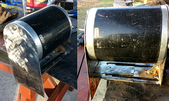

I also did some more work on my motor mount. I used some 1/'16" sheet metal for the mount and it has some flex to it that I don't like. I decided to make a rear support out of some even thinner sheet metal. I printed up another template and drilled it out:
To make sure the everthing was lined up correctly, I bolted it to the rear of the moter and then marked where to cut:
The rear mount sits on top of the front mount, using the same bolts:
This should prevent any flexing and give me a place to mount a cooling fan later if I feel the need. Running a 36v motor at 48v can generate motor killing heat if you go heavy on the throttle. Down here in Florida everything is nice and flat, so it's not so really a problem. But Montreal has some fairly steep hills and that can put a lot of strain on the motor.

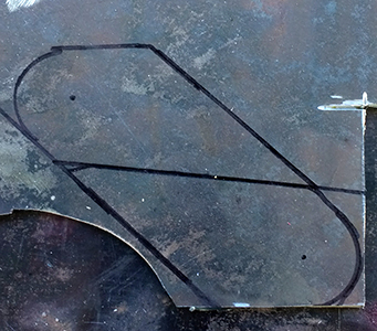

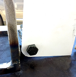

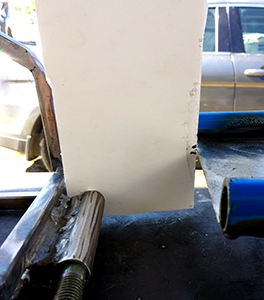

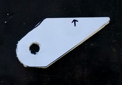

So I finished the pieces for the pivot today. I used a piece of foam board to get the shape I needed for the pivot connector. I rounded the corner and drilled a hole the size of the pivot bolt. Then I mounted it onto the pivot tube:
I marked the foam board against the mount on the frame:

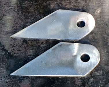

And then I cut out my pattern and traced it onto some 1/8" steel plate:

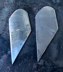

These two pieces need to be exactly the same, otherwise the rear end of the scooter will be to the side, which is "bad". ;) I cut out the shapes that I wanted and then I clamped the two pieces together and worked them with an angle grinder until they were both exactly the same.
Then, keeping them clamped together, I drilled the holes for the pivot bolt:
I'm using a 4 1/2" bolt here and it's just a little to small:
Well, actually it's perfect, which is the problem, I need it slightly loose so that the pivot will swing properly. A 5" bolt is to long, so I'm going to trim the pivot tube about 1 mm on each side. I have the space on the pivot tube for this and I think everything will be fine after that.
Tomorrow is the big day! I need to line up everything perfectly! A millimeter off in either direction and the scooter will ride slightly to the side.

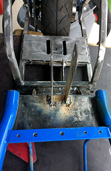

OK, I got the swing arm pivot welded in today.
The regulator on my welder is bad and I'm waiting on a replacement, so I'm using flux core wire and it sucks! I can't believe how fast I got used to gas! Big difference in the amount of splatter with the welds. I might ask around and see if anyone I know has a spare regulator that I could borrow until Eastwood ships me the replacement.

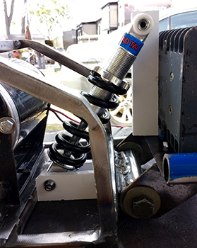

At any rate, the pivot arms a lined up nicely and I started work on the mono shock. I used foam board again to make the patterns for the shock mounts:
Once I had everything cut and lined up, I welded the shock mounts in:
