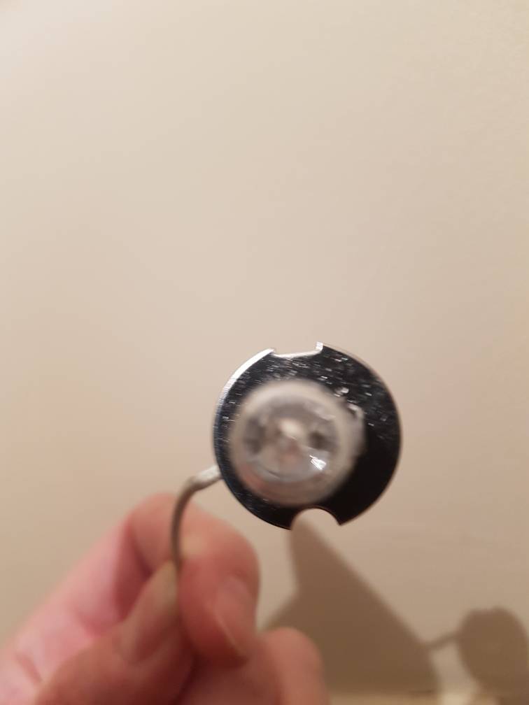

I am running a 48v 2000w electric scooter which has a 12v 25w headlight pre installed.
I decided to add 2 additional lamps,
i first wired them in series and they were noticeably dimmer than the main headlamp. When wired in parallel they were much brighter but either way the much bigger issue was that the motor engaged driving the back wheel, really scary!!
Anyone got any ideas why this is happening and how to overcome the problem? I just want to achieve some extra front lighting.
Thanks in advance.
What is the source for the 12V?
What else does the 12V run?
How low in voltage does the 12V get when both lights are on, vs when only the original one is on?
If the 12v is required for the controller, then if the load on the source is too great, perhaps it drops too low in voltage, and the controller begins to act in unintended ways.

OK first off, switch to LED lighting. 1/4 the power draw, 1/4 the heat. You can replace those three lights with LED's and get more light for less power than you needed with a single 25W light.
Next, do the lights operate off a 12V DC/DC converter? If so, then that same converter may be driving the motor controller logic, and all your 12V light are browning it out - leading to odd behavior (like the motor running.) In any case, switching to LED will solve that.
Or stick with your original light.
Thanks for the help on this guys,
Before we go any further, I think the advice regarding using LED bulbs is probably the way forward.
The big question is, where can I get led bulbs with the same fittings as these bulbs in the images?
These are the original bulbs but I have no idea where I can get the same in LED's with the same fittings

I've been having issues wiring extra lights to my scooter.
The extra lights are causing a brownout which is causing the speed controller to become confused and engaging the motor drive which is super dangerous.
So my questions are as follows..
How do I wire the lights directly to the battery but bypass the speed controller? And how would I drop down the voltage from 48v to 12v? (I will use a separate switch) I won't use the built in scooter on/ off headlight switch.
Also, alot of LED headlights for scooters seem to say they work between 12v & 80v.
As I am running 12v would that mean the lights would be really dim?

You need a DC/DC converter. Ebikes.ca sells them. So do many others. Make sure you put your main power switch between the battery and everything else.
No. Good LED lights have ballasts that limit current. So the brightness will be similar between the limits of voltage it can handle.
