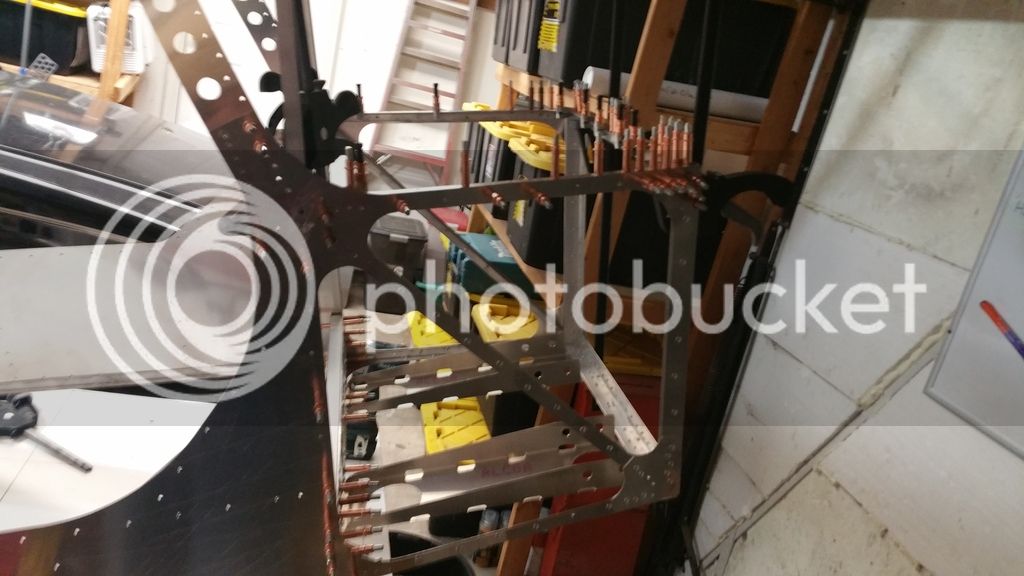

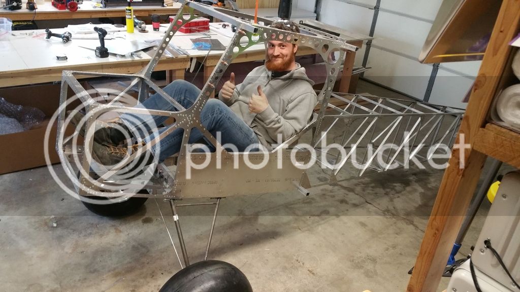

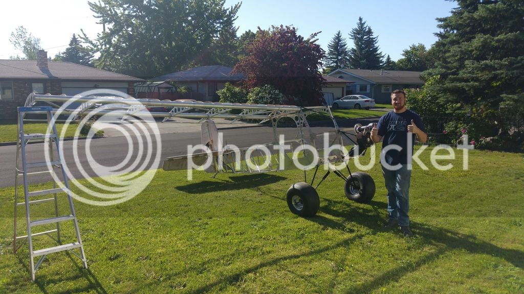

Heya all!! Started this project around the beginning of the year, and have made enough progress to post it up on the forum.
Heres some stats:
Airframe: Belite Ultracub
Motor: salvage Zero 75-5 IPM
Battery: Farasis 29AH 28S4P pack
Controller salvage sevcon Gen4 Size 4
Bms: None
Charger: Meanwell RSP2000 x2
This guy will be called Mk.5!
So excited to fly in it!!!

Can you clarify the battery pack? Is it 29Ah total or 4 x 29Ah? The latter would make a 12kWh pack. And what is the anticipated weight of battery?
The pack is 29Ah per cell with 4 in paralell for a roughly 12kwhr pack. Pack weight will be right at 67KGs
