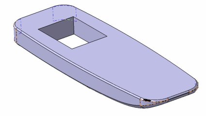

The barge foam design:
Basic dimensions 1700x580x150mm, 120 L

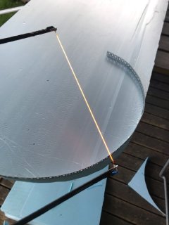

Made a smaller hot wire bow for shorter cut depths, this is about 30cm/12” wide and can do 30cm deep cuts. It turns the wire red hot.. dimmer does not affect either voltage or current.
Seems the dimmer cannot regulate the power supply. Guess they’re not compatible. Why?
Cutting with the longer bow is slow, the power i've got is struggling with 75cm/30” wire, cuts are slow through the foam even though they burn the wood guides i made. I guess the melting/gassing of the foam cools too much over too long width. Power is 19V*3.9A so 74W. Maybe i’ll have to use metal cutting guides and more power. but that requires another power supply or a battery.

Testing cuts on ordinary EPS80. It’s a lot easier than cutting XPS300 due to the lower density.
I think the hot wire calculator i used is not for XPS as it gives out too low power values.
(https://jacobs-online.biz/nichrome/NichromeCalc.html)
I guess more like 150w is needed to take a full width cut through 24”/600mm XPS300 sheets.

Well, temperature of the short bow really is too high, i started a fire when cutting :wink: I got no pictures of that though, had to save the board😅
I made some guide rails with metal strapping fixed with hot glue dots. Worked remarkably well!

Since dimmer doesn’t work i’ll need to solve it with longer wire. Hacked up a new 50cm bow which gives the thread a really dark cherry color. I’d guess max temperature is around 450-500 deg C. No more fires :wink:
Incandescent color vs temperature
Mid size / 500mm bow

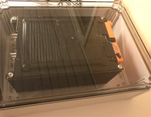

Got an IP67 electronics enclosure. A bit lazy to not build it but making a DIY 100% waterproof seal is not easy.

I couldn't open the enclosure for the life of me, then i saw the lid bulged inwards by half an inch, there was so high vacuum in it that i had to heat it for five minutes with a hairdryer before the suction let go :wink:
I guess tightness is proven so that's good :thumb:

Battery doesn’t fit in the box height or width in the way i wanted as the lid protrudes inside the wall of the bottom part. It doesn’t matter, i have some room to spare, i’ll rotate it and cut away part of the lid. I planned an alu plate lid for better heat exchange anyway 8)
