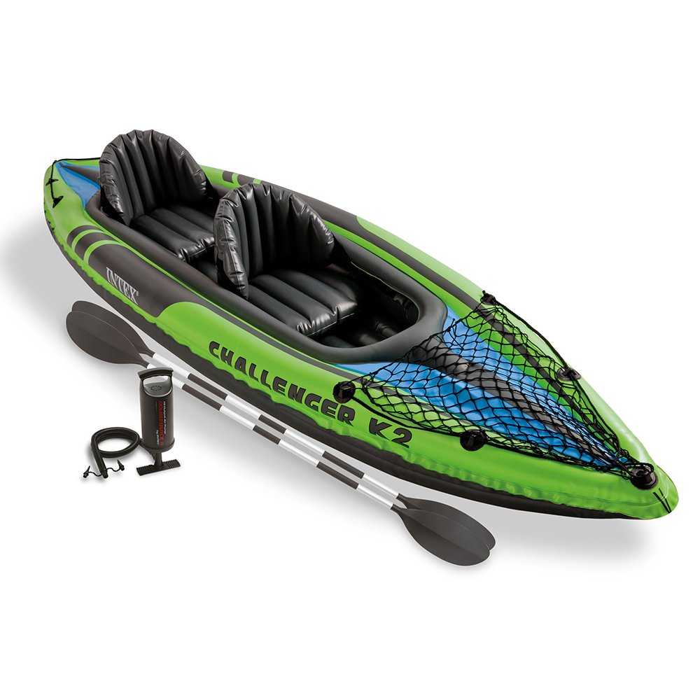

Thie will be my summer eboat , have just picked it up on Amazon for $100 Plan is to lay two 100w semi flex pv panel on the front / rear with me in the middle with 46 ft.lb thrust 420 watt trolling motor on the back.
Intex challenger k2
With the motor locked straight ahead you can steer by dipping the paddle ends in the water.

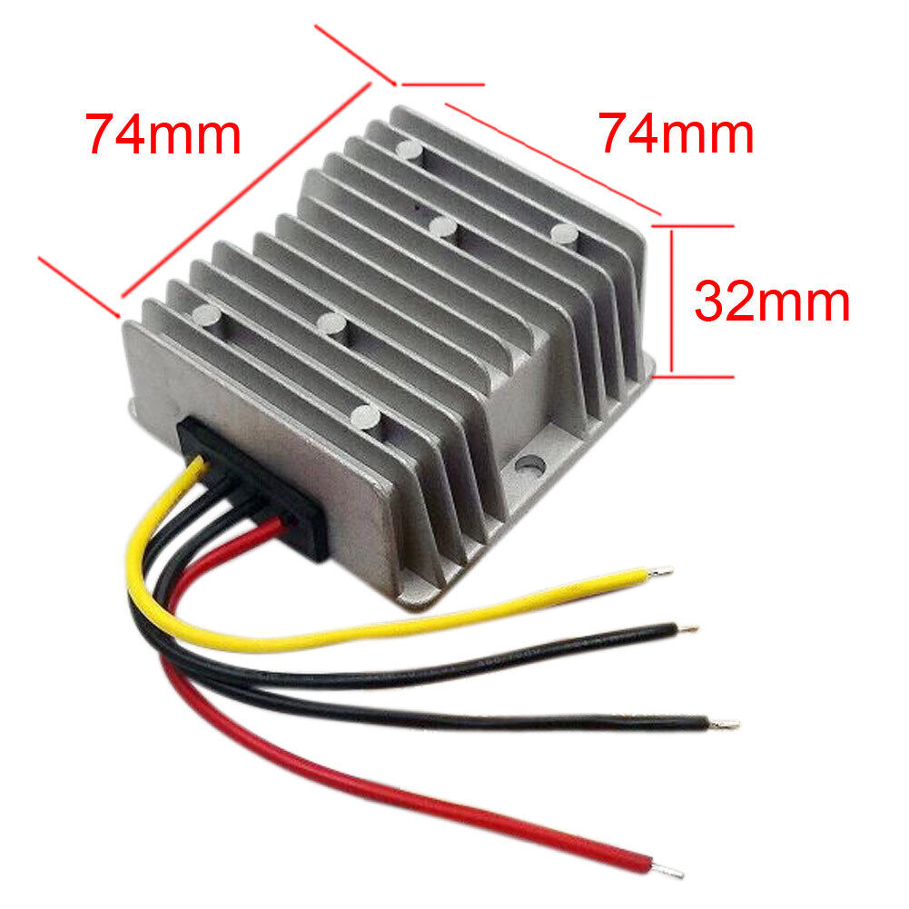

Step down
Will need a step down converter so ordered this epoxy sealed 48v/36v converter to step down the ebikes battery to 12 volts. It cost $20
60v peak to 12v 25A output 300w rating , Motor draws 18A 235 watts

I think it will rip with the little kayak though as the total weight will be around 250 lbs. Well maybe not rip but have good pushing power :D
Weight: 38 lbs
size: 11 ft 6in X 2ft 6in X 1ft 3in
Persons capacity: 2
capacity: 400 pounds
U.S. Coast Guard I.D : NMMA Certified
TUV approved
I would think its rated for lakes only but read it for mild rivers as well.

You don't need both (new controller plus DC/DC.) A decent controller will limit to a max voltage.

I am hitting a glitch where I need a second step down converter to step the Panels to 12-13v for direct drive. So maybe a 24 to 12 converter or a 12v voltage stabilizer. My worry is the mppt charger will not run the motor direct drive due to its charging feature may pulse the power on/off. Im not sure if it will or will not work when stepped down.
Charging will be done via the mpt-7210a 600w mini charge controller
Edit - I bought a 2nd sealed step down converter this one 24v to 12v 30A 360w with a 14 to 40v input range. I will run the 18v panels in parallel so 18v out to the converter then 12v to the speed controller.
